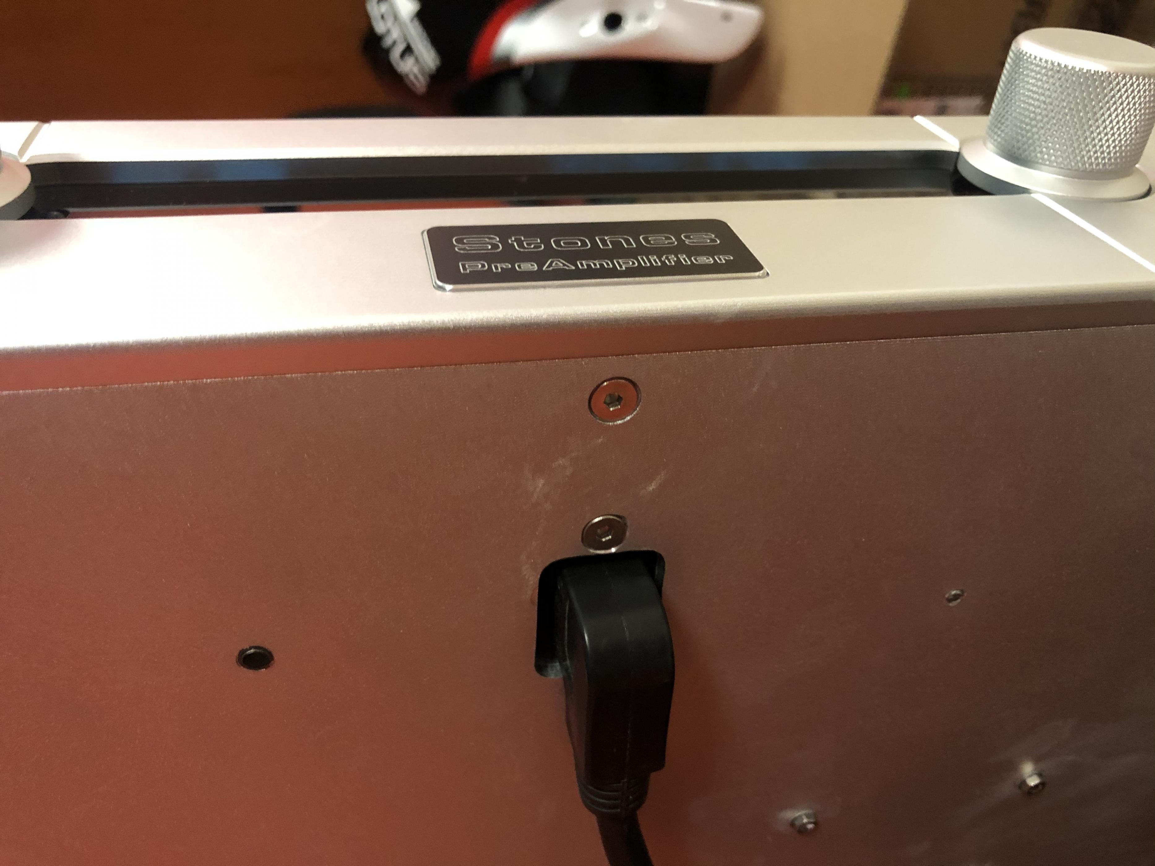

This might help someone. I used an eBay “Goldmund” case (note two version of it exist, I used the all aluminum version). Just with the front panel upside down.

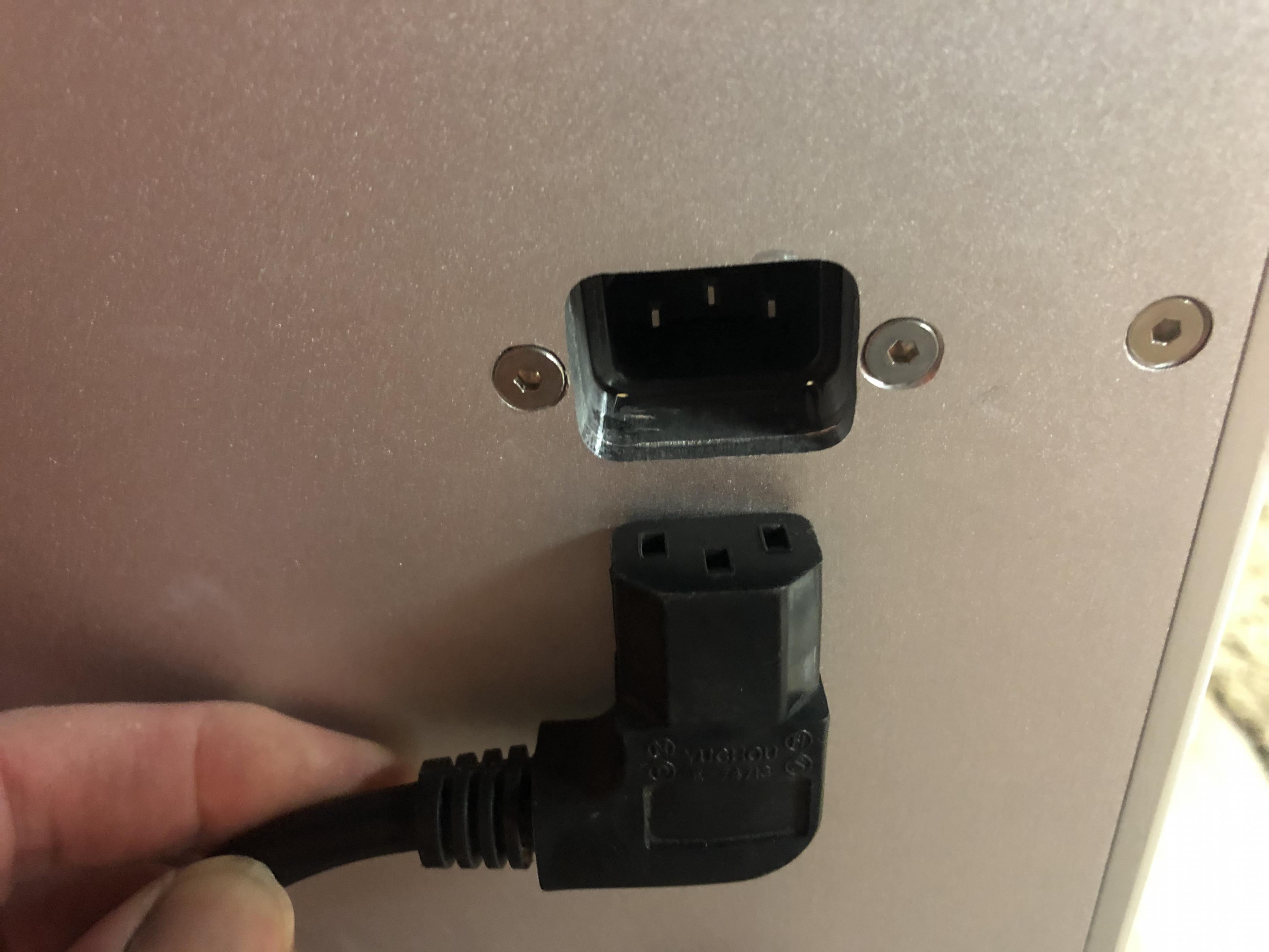

can you show me how you solved the AC input on the chassis?
Very observant of you. There is room middle lower rear panel for an IEC but I didn’t like the idea so I put the IEC socket underneath. I tried to show it in attached front face picture with a light from the side. I can’t attach the rear panel files here due to it not listing / allowing the file type so please PM me your email.

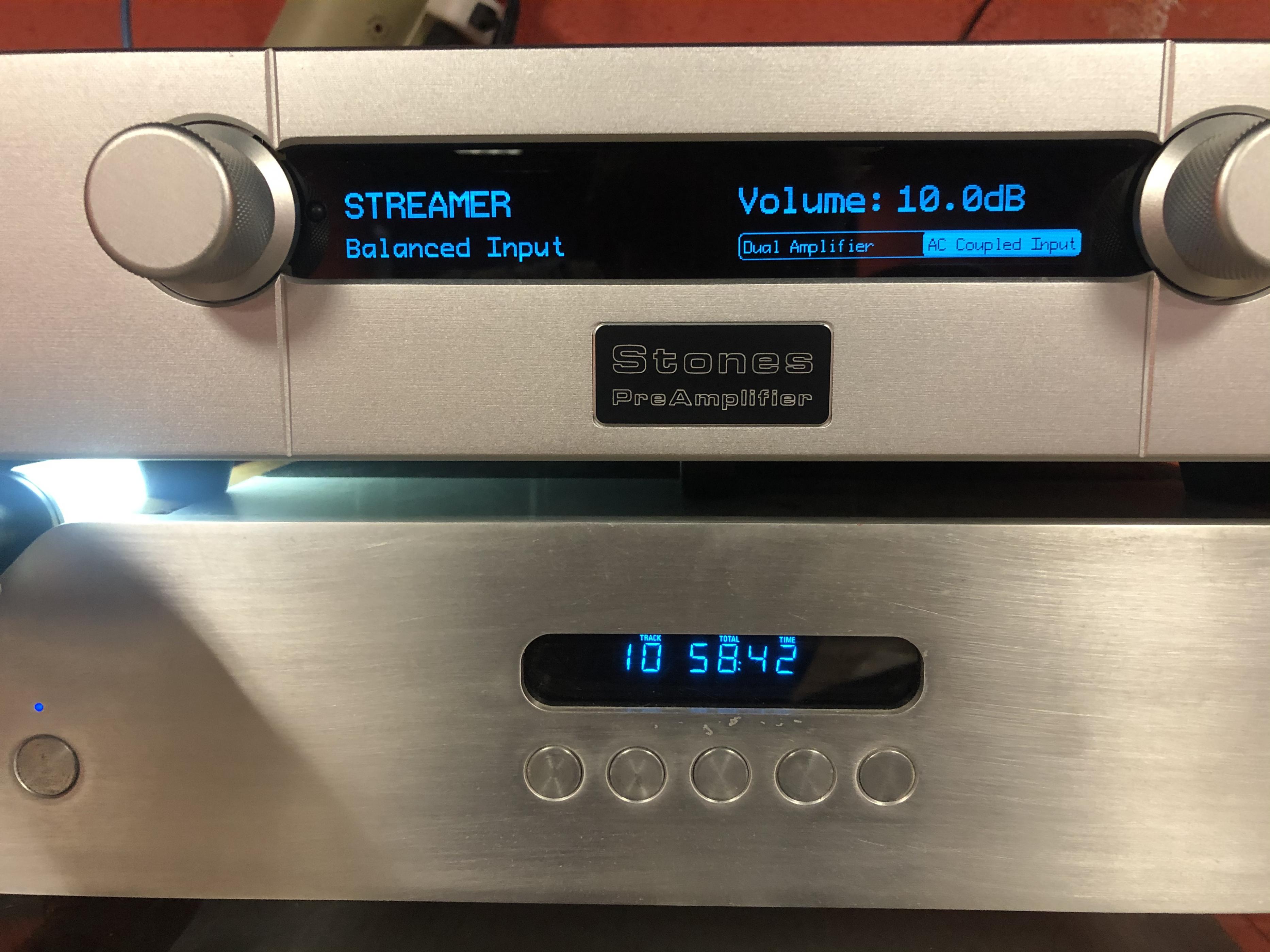

Alex the encoders are inverted in the rotation setting (if I change the volume rotation it changes the source and vise versa). It’s a high class problem but the only one I found outside of the education Gionag provided. I have not tested triggers as I am waiting on some plugs.

Now I understand how it operates the way it’s working is perfectly ok, that said I find myself forgetting to go back and save / reload after minor changes so this proposal would be a nice luxury.
