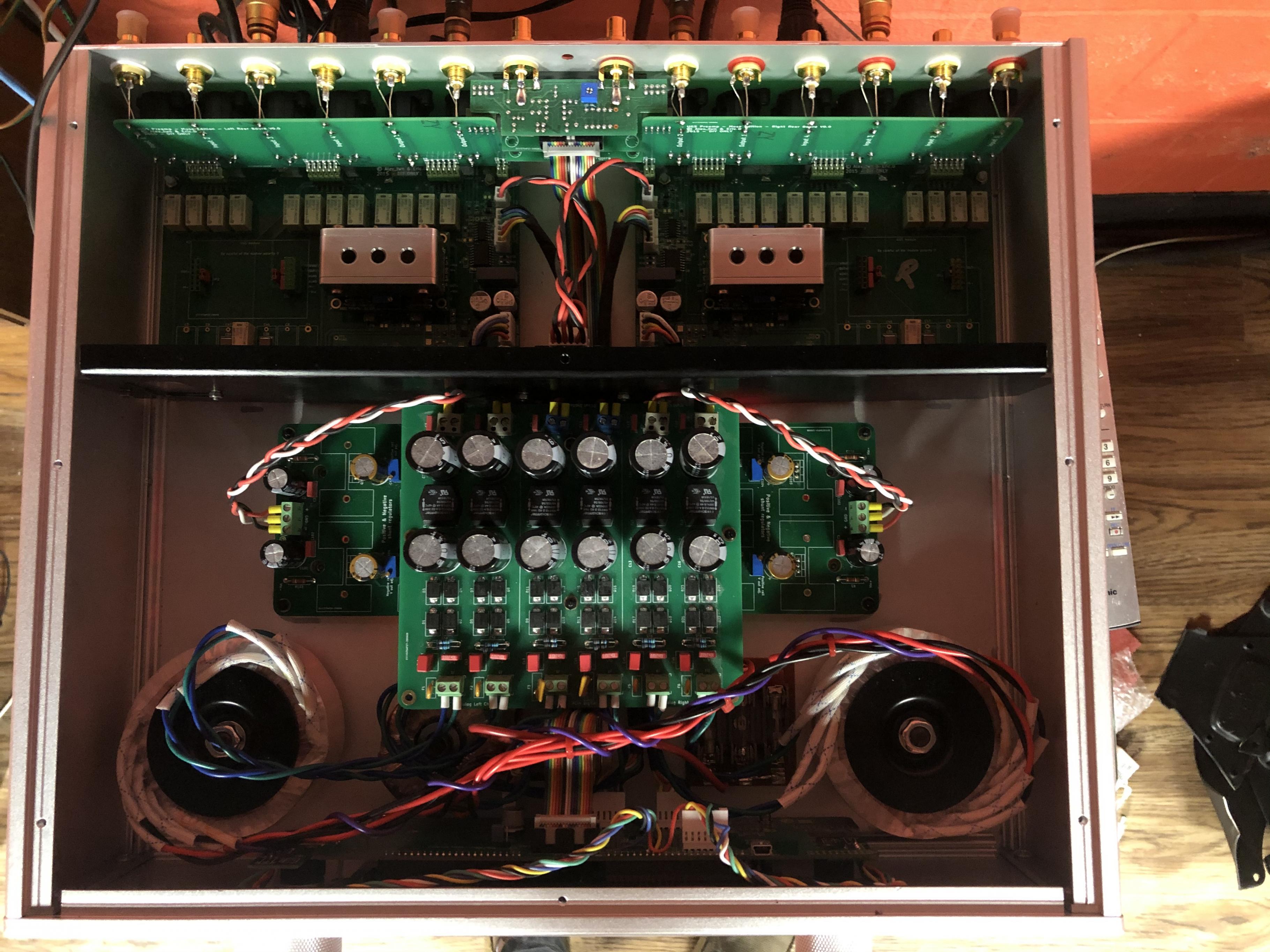

Your soldering of C6 looks rather suspicious 🙂
It’s just camera shy. I noticed when I took the picture it looked bad so I gave it a good coat of looking @. Turns out it’s a lighting / camera trick but thanks for watching out for my electrons 😀

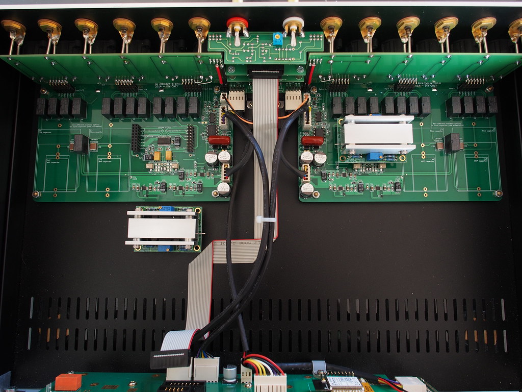

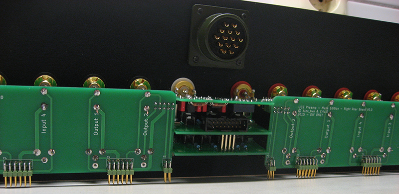

Relay go on the other side...
If I understood correctly, the relay goes on the side that does not have solder mask. Is that correct?

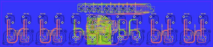

Rear Panel with Triggers and Sub almost done to fit with the PSU substitute in one enclosure

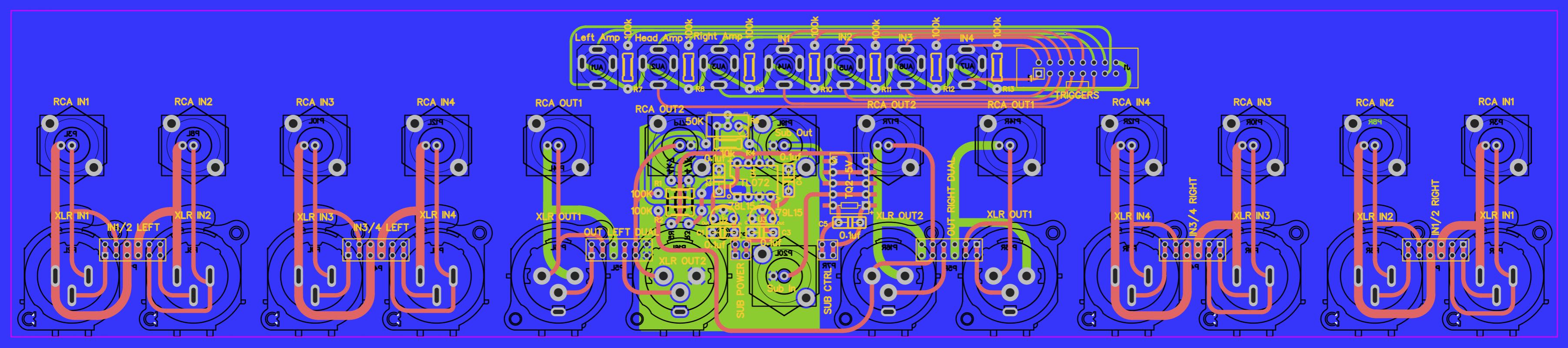

Rear panel and front badge from Front panel Express (awesome service) let me know if you want the files
Beautiful! Thank you for sharing the source for the chassis.
If the offer is open to everyone, if you'd be willing to share the files for your rear panel, it would be greatly appreciated. Metal work is definitely not my strong suit (nor is CAD even simple versions).
