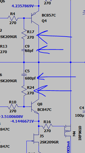

Verify Q104 that E and C pins are not shorted together since my simulations shows approximately the same voltage that you measure if I do so.
In case here are the simulated measurements points for +/- 24V outputs.
Revisiting this, but in Salas' schematic, the equivalent resistors to R4, R6, R104 and R106 are 51R, not 270R as shown in the UGS Salas schematic and BOM. I haven't built a SIM yet, but your SIM shows 51R for these positions. Would those value changes result in what redjr is seeing?I am afraid I am running out of suggestions except for a bad part.
Given the 3 CCS and the current limiter look OK according to your measured values, I would change Q108 mosfet and perhaps the BJTs of the shunt part.
The passive resistors doesn't need to be changed if measured OK.
Also, from previous SMD circuit builds, check all your resistors via ohmmeter for shorts underneath. I had a 0805 resistor shorted underneath (solder bridge) which was not visible under magnification. I wish you would have used 0805 for these instead of the 0603 🙂
Would you mind sharing your SIM Eric?
Not according to sim.
Also verify if the LEDS are soldered in the appropriate directions.Also, from previous SMD circuit builds, check all your resistors via ohmmeter for shorts underneath. I had a 0805 resistor shorted underneath (solder bridge) which was not visible under magnification. I wish you would have used 0805 for these instead of the 0603 🙂
Sure - nothing secret. Here is my .asc file. Let me know if you have any trouble with it.Would you mind sharing your SIM Eric?
Thanks Eric! The original pic of your sim several pages back had 51R instead of 270R, so was just wondering. Salas' UltraBiB schematic also uses 51R in those positions for both rails. It appears to make no difference.
Yes no difference. I just did it in order to minimize the numbers of differents parts.
Also, I changed out the AC voltage sources for DC, and replaced the pots with a pot subassembly that I had, where you can adjust the wiper on.
Not exactly an AC source. It is just an added small AC value over the DC value.
This was a quick shortcut for me to verify if any issue from input ripple.
Ah, got it, that makes sense. Not a practiced spice user here.Not exactly an AC source. It is just an added small AC value over the DC value.

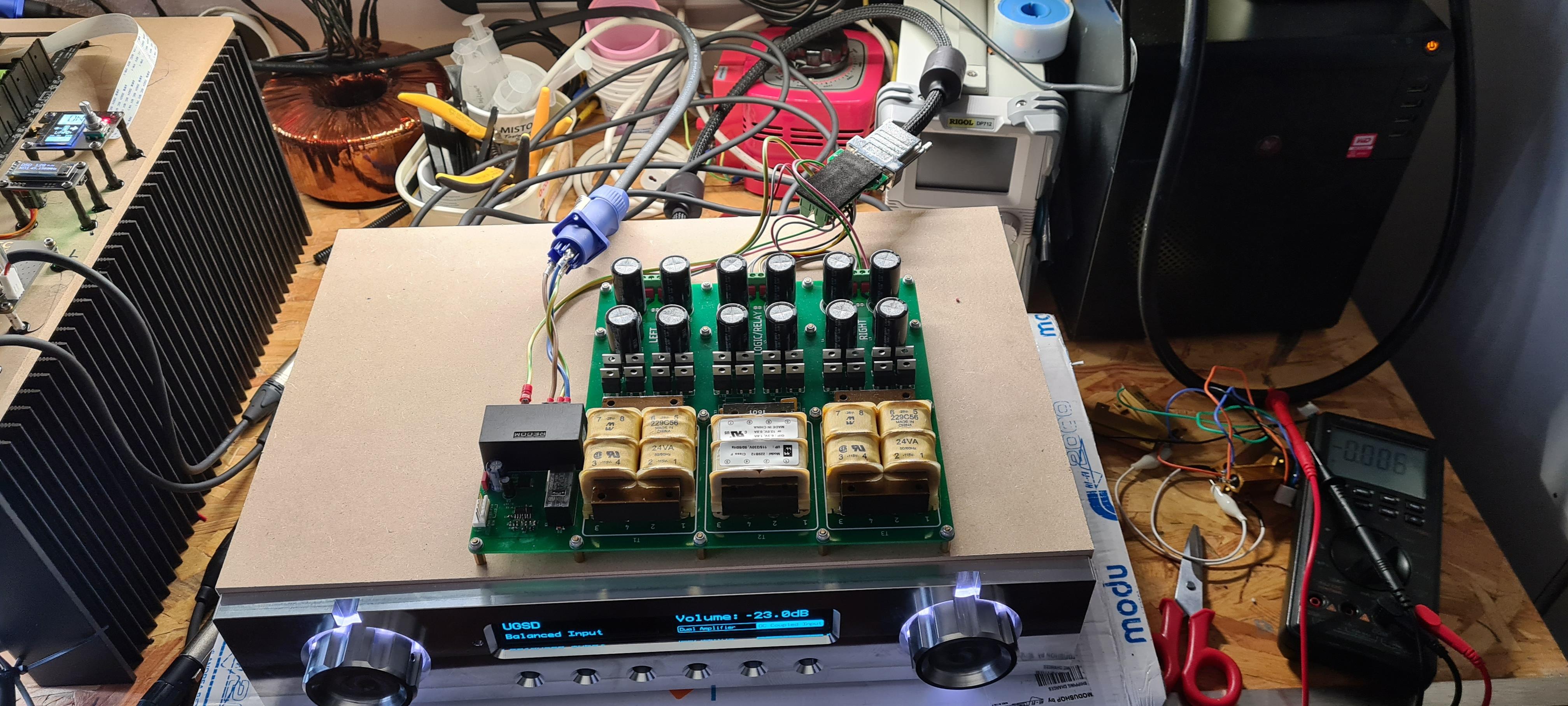

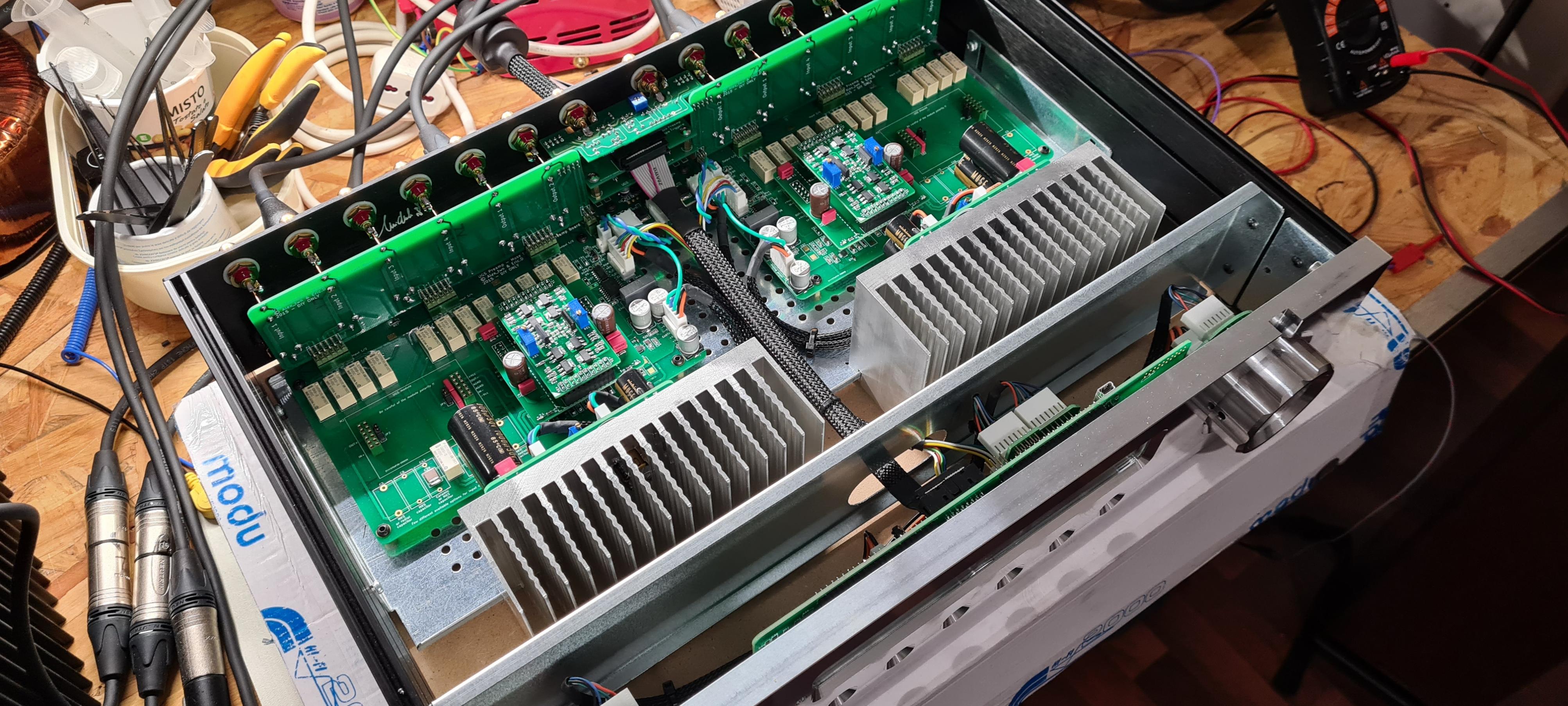

Just to report some progress :
Psu ready to be housed.
DB15 M-F cable to connect the power supply.
Installed "RF" shield for the front controller.

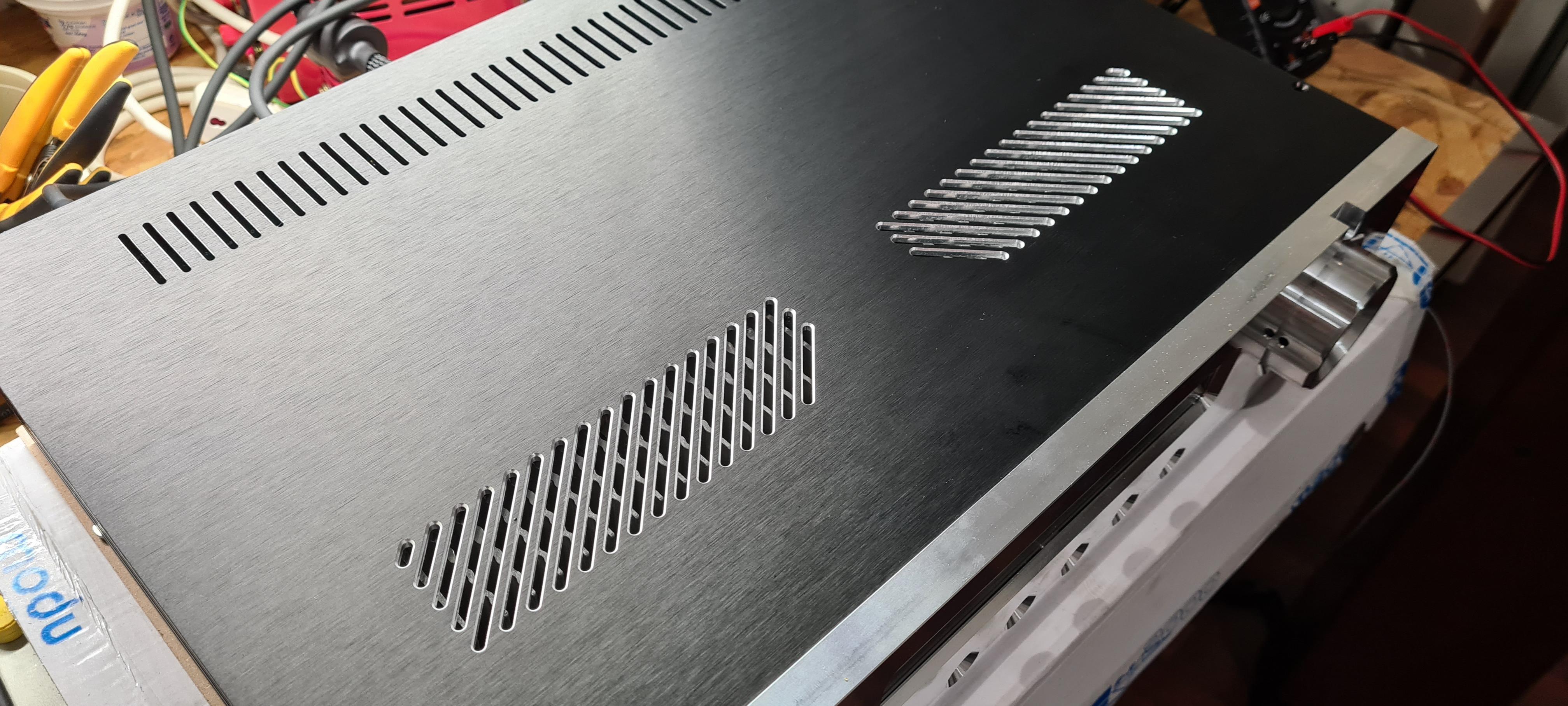

Slotted top/bottom cover.
Still missing the buttons (but i have already drawn them, plus a nifty spring mechanism to keep them solid against the fron panel in order to avoid any rattling)
And also the whole anodization on milled parts are missing. At work we are changing our supply chain and found new anodizer that must be tested before full trust. but the first parts we received are great, so i think i hav to wait no more for that.
Everything is not without concerns :
1- Have anyone tested the Shunt regulators against thermal tracking ? I have found that the output voltage can shift a lot (~2v) from cold to hot. I remember that is quite normal by some extent. but i don't recall such a great span on my Salas-original-PTH-version ultraBibs... maybe this one (the one i have implemented is very close, to not say the same, as the one that Eric made) with smd packages have different nature.
2- For whom has UGS6. Still investigating, but at the time of writing, seems that the module is not suitable for a Se-To-Bal conversion. In such scenario the output is not perfectly symmetrical nor equi-impedenced. Works GREAT with bal-To-bal use... but mabe is not reccomended for such a preamp. I am trying to implement the v4, still better than the v3, but has all the feature needed for a full-featured pre-amp like this. To be clear, i am not in search of some support, just to notify that behaviour for anybody are thinking of following this route.
Happy building !
