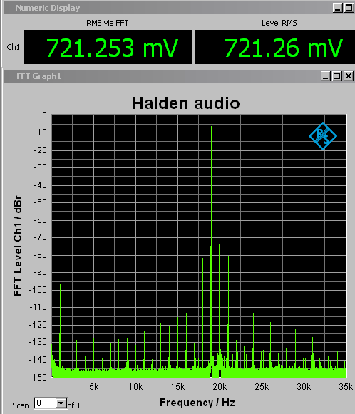

Intermodulation
Here the preamp plays two notes of 19k and 20k. This test is really a cruel test for any amplifier and shows quite a lot.
The test is done with a bandwidth of 250kHz.
We see that the two nearest sidebands are at -80dB and we get a bar at 1kHz at -95dB.

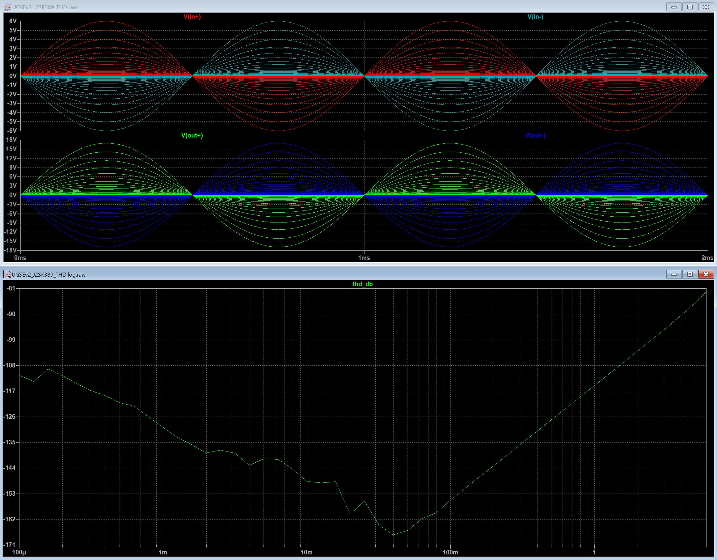

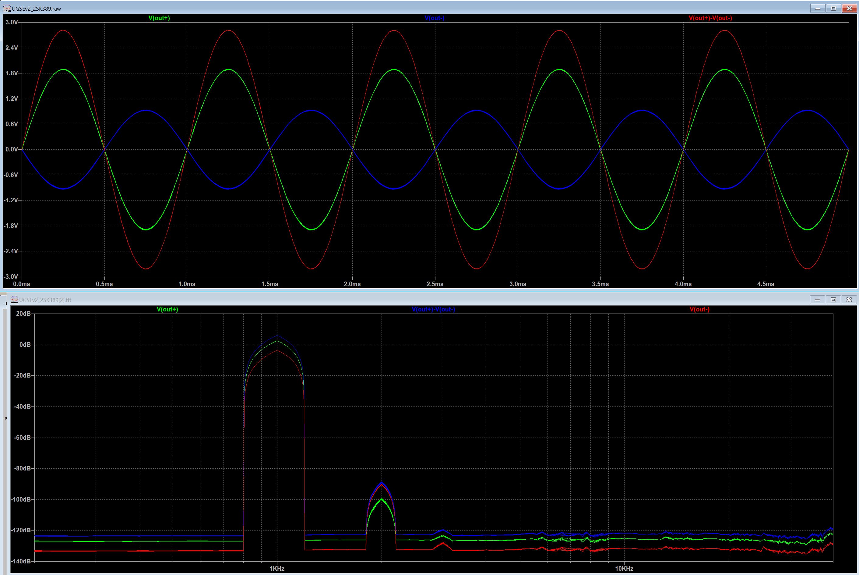

Here is some simulations plots of the module behavior in unbalanced mode (it is mine but UGS4 or UGS6 would be similar.
Interesting. I kind of remember, I found more or less the same results in simulation when I plotted thd vs input level. Need to redo these.

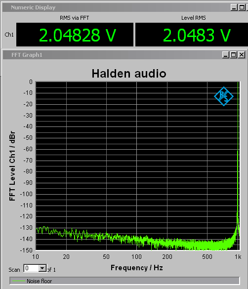

Noise.
With my "monster" power supply, there is not much noise and noise to be traced. At the same time as it plays a signal of 2V at 1kHz, the noise floor is below -130dB below 2V. This is noise free and well so it .. XP-30 has around 10dB higher noise floor.

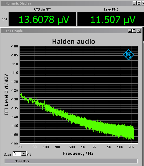

Noice floor
This test is not included in Stereophile's measurements of the XP30, but I included it to show how low the noise floor is also up in frequency.
And that's all the measurements I have. All measurements was done by a professional audio technician .
yes that looks very similar (reg.amplitude of the two phases) , when I measured mine with a SE input > Bal. out.
This was done with my chepo equipment 😱 So take these measurements with a "pinch of salt" 😉 2V, 1Khz SE in.
Phase 1: Pk-Pk : 3.48V RMS: 1.16V
Phase 2: Pk-Pk: 1.86V RMS: 620mV

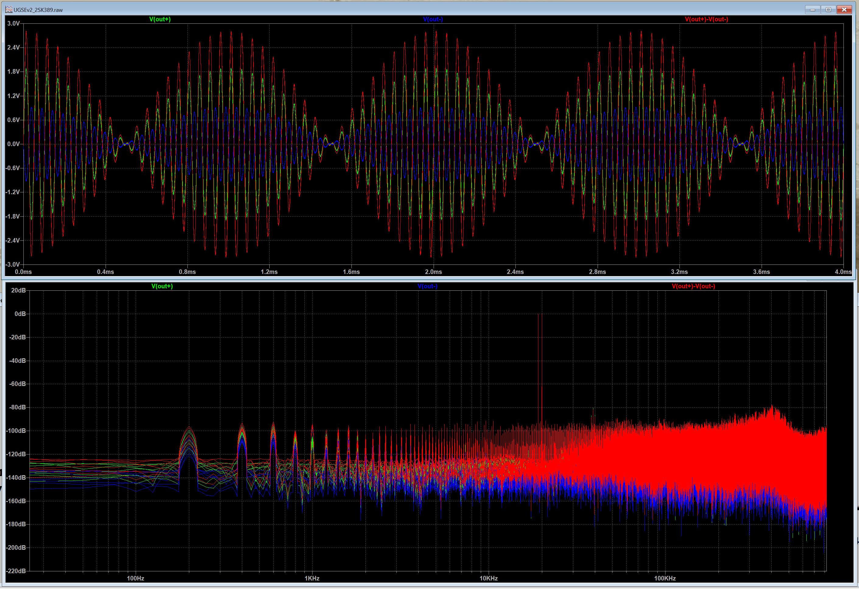

Just a last one before bed time. Here is a quick intermodulation simulation in unbalanced conditions.

Hi Johnny,
Same overall behavior in simulation.
In my case, It starts to saturate at around 18Vpk (36V differential) but I just run it with a +/- 24V PSU.
Just a remark, the X log axis corresponds to the UGS module input signal peak amplitude (and not the output).

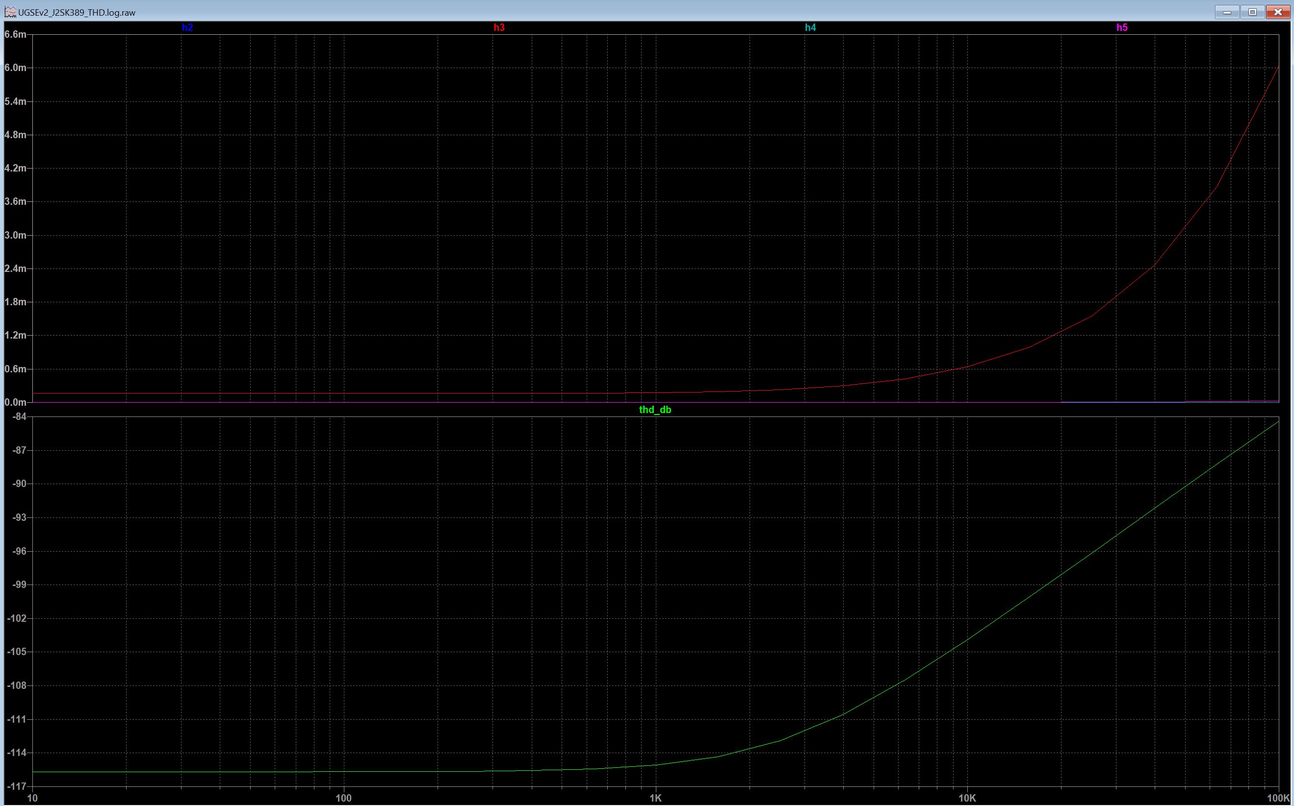

Ine;6517244 [B said:Conclusion.[/B]
The preamp measures very similarly to the XP-30. It has a lower noise floor, but seems to have a slightly higher distortion upwards in frequency.
Distortion as simulated is flat until 1Khz then start to increase above.
As you can see, it is mostly H3 causing it (and unfortunately I dont have yet a solution to further reduce H3 levels at higher frequency).
This was measured in balanced mode with 10Kohms/40pf loads to GND on both OUT+ and OUT- with a 1V input amplitude (so approximately 2.8Vp/5.6V differential with my module gain setting).

Well, mine has the fifth harmonic as the highest is at -105dB.

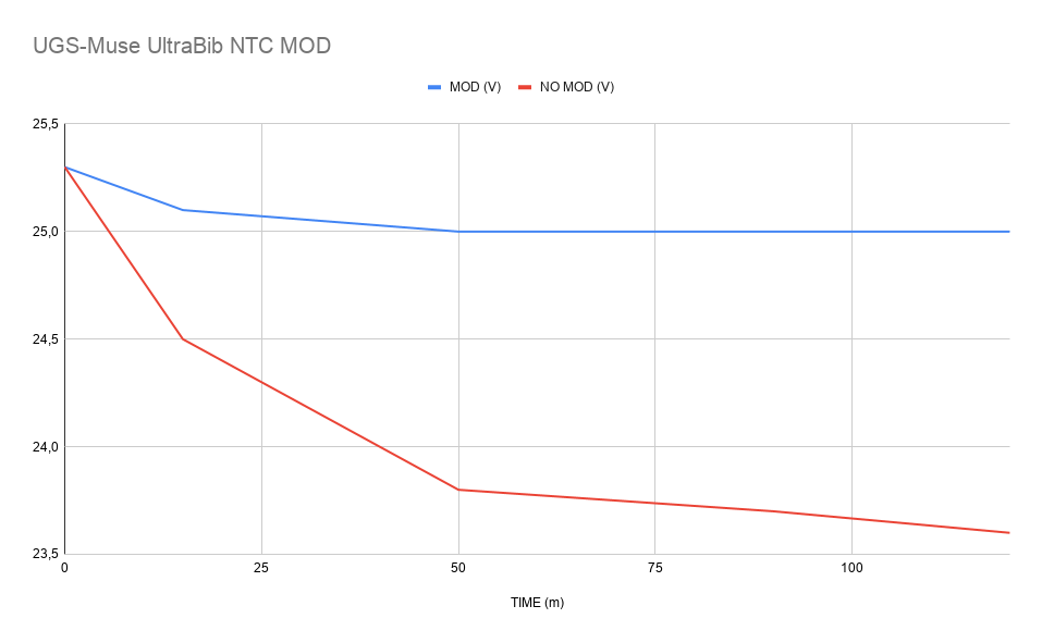

Mod Done.
i have used a B57301V2472J060 4k7 3590k NTC.
soldered "piggy back" on the res on my bib.
the test was done by modding one of the two regulators. same thermal scenario. no moving air around.
Voltages are logged.
thoose the results :
No oscillations, no strange things. the graph explains itself 🙂

Great confirmation!
Many thanks Gionag for testing it.🙂
I will post later on today an errata to the spec with adding this ntc.
