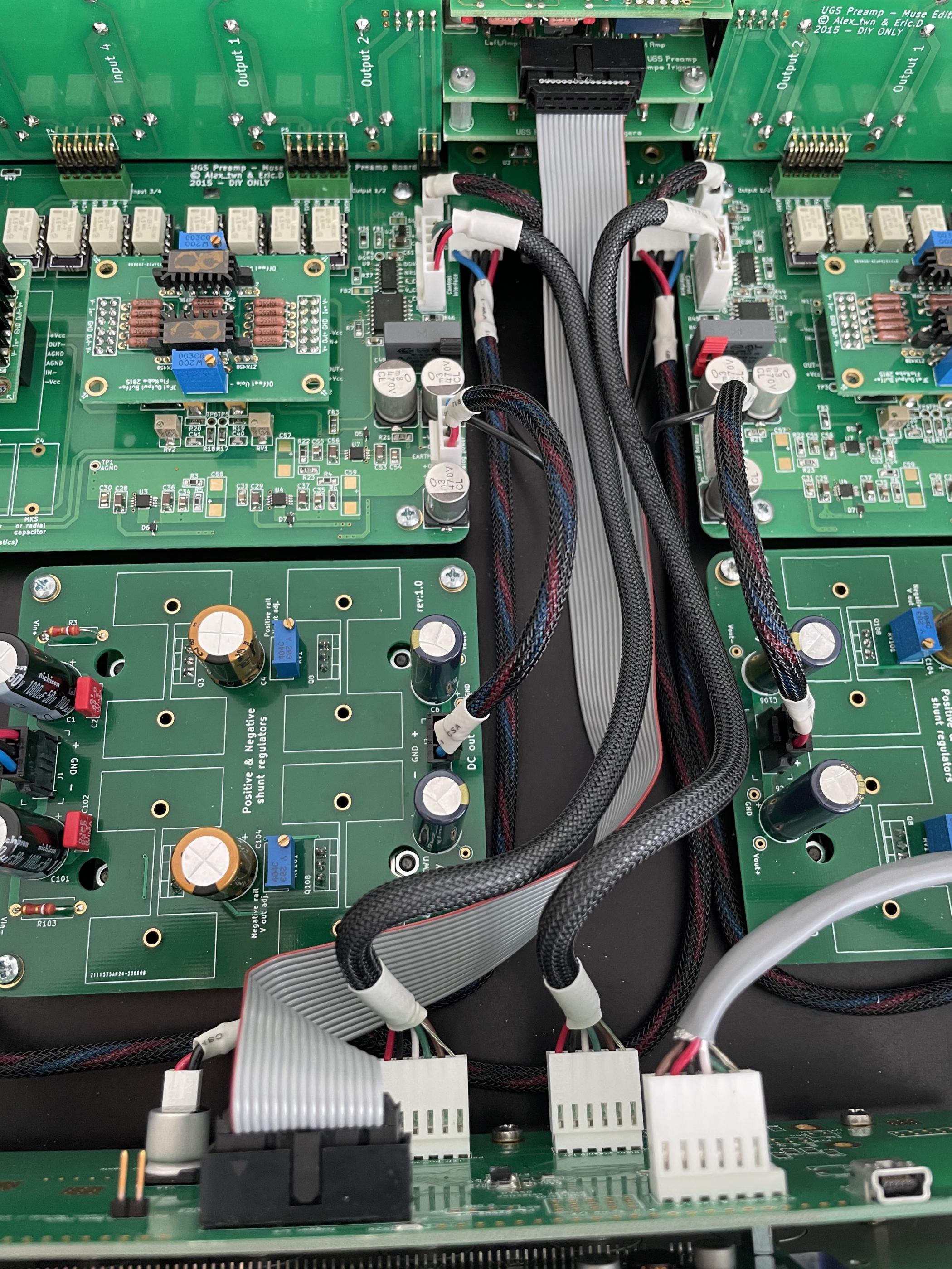

... there's something i need to know to make trigger works ?
i have connected the OUT A from the preamp to an UGS Up with a stereo TRS jack-jack cable.
i expected when waking the preamp up that also the amp will follow, but nothing happens.
Trigger set as : Latched.
any insights ?

You need to check the pinout of the 3.5mm jack connectors you are using. It happens that some are swapping the signals...
i will.. but the jack used are the one from bom.
both for the up and also for the muse preamp
You may want also to check flat (?) cable connection between uC board and trigger board - it is easy to make a mistake here...
I second Jacek's suggestion. At one point, the 16 pin IDC connector on the Muse UGS MCU board was rotated 180 degrees compared to the All Inclusive UGS (see: <<UGS - Muse edition - Page 38>> - 30058092 - sur le forum <<Amplis et Preamplis>> - 1056 - du site Homecinema-fr.com).
I'm not sure if that was changed on the latest PCB. I just verified on a picture of my implementation and the IDC orientation cut-out is facing the top of the MCU, if that can help.

I think I have found the issue... I have not thought and just terminated the idc cable as a previous photo reported.You can also trace out pin 1 or pin 16 to make sure the orientation is correct.
Paul
Now i can see from yours that is indeed reversed from what I have.
Tomorrow i will try to fix it.
Should be easy enough.
Thanks !
i think is fixed !
wrong cable orientation.
