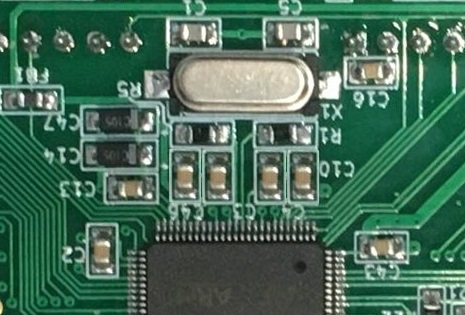

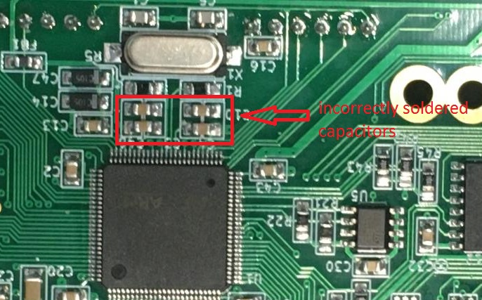

attention
Incorrectly soldered capacitors C10, C4, C3, C46!
It should be like this:
Yesterday I soldered my mcu board and today I uploaded the firmware successfully(the last version) and after that powered it up shorting sw1 and sw2 pins on the encoder connector. To my surprise the oled displays didn’t go on. Doing a few attempts to short sw1 and sw2 for different amounts of time(from 1s to 5s even more) the displays went on but displaying small pixels and turning on/off aleatory. Now they don’t start at all.
In bootloader mode the mcu draws ~30ma and in application mode it draws ~17ma.
I tried also to upload older versions of fw but with no luck, the issue is still there.
I checked also x1 and it’s working.
Can anyone suggest what else should I check?
