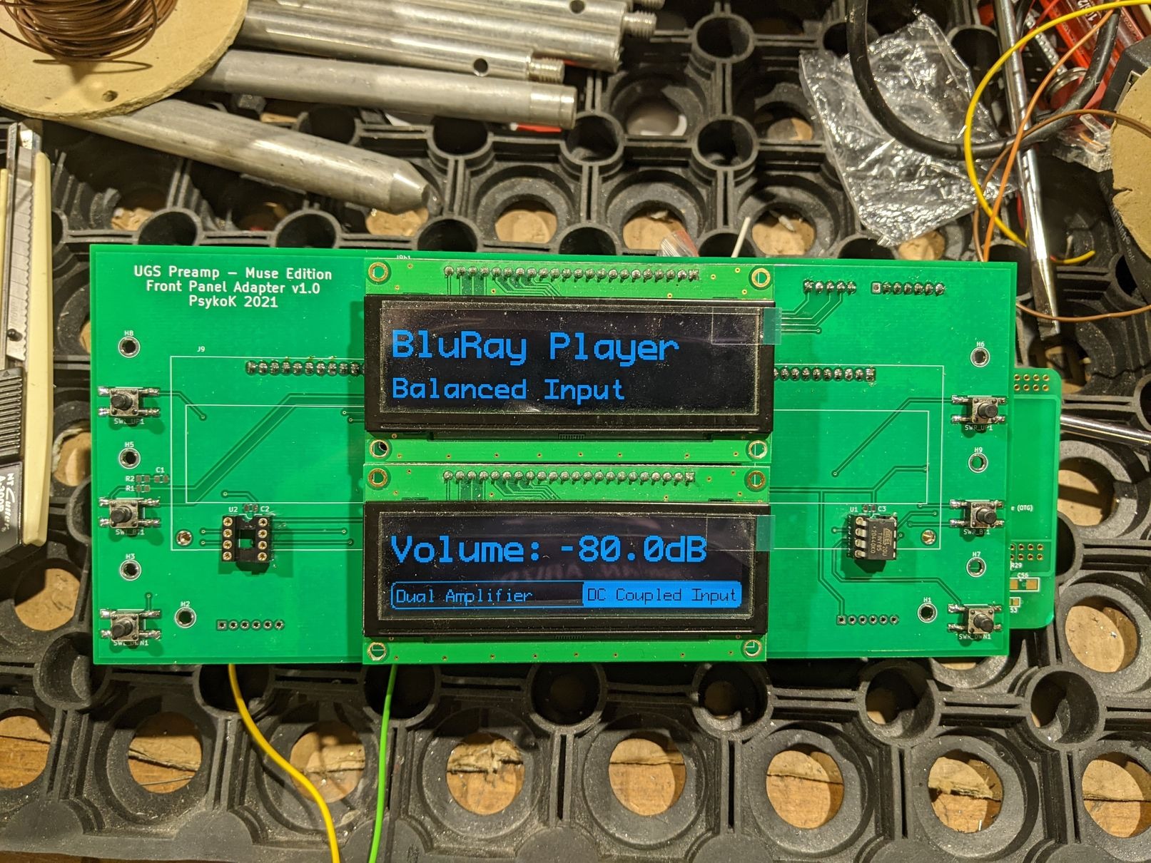

My new front display setup is ready

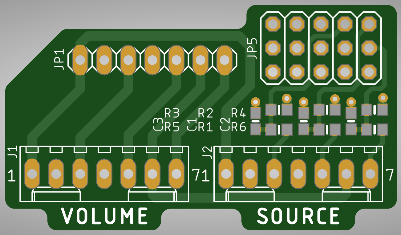

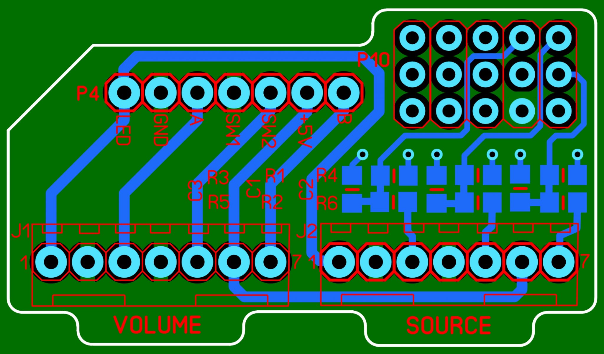

Gionag, I would be interested in your adapter board, hope you could help me out for the 2nd encoder. Thanks!
Anyone has a p/n for JP5?
Are all caps 10nF and all resistors 10k?
Single row male/female pin strips would do the job for JP1 and JP5, I guess.
If gionag or someone can help me with that board would be great, otherwise need to fabricate one myself. I guess the flipside of the board must be GND and one pad of each of the caps goes to GND and then to pin12 of the spare I/F. Using 10k resistors and 10nF caps, 0805.
schematics are public ... made some pcbs for me. Everything else is only diy. Dont want to share gerbers files, etc... If anyone is interested, I have permission from Papa to make a copy for myself UGS V6.
Made some modification, position of components. First is Muse attenuation, second is UGS module and last is buffer. SOUNDS GREAT. THX people...
