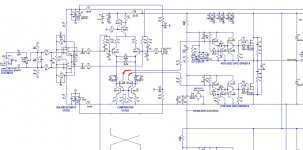

UcD Xlite Fullbridge PCB and Schematic
Ver.5 is not yet tested.
Hi Kartino
for Halfbride change RED marked at comporatir stage ? is this correct ?
the rest from circuit 2 amp will be removed
Buffer Mosfet Drivers 2SC2655 and 2SA1020 OBSOLETE !!!! replacement with BD139 / BD 140 ?
regards

Hi Kartino
regards

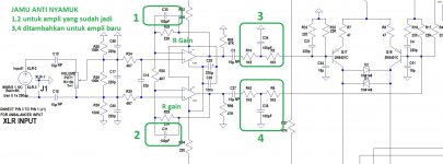

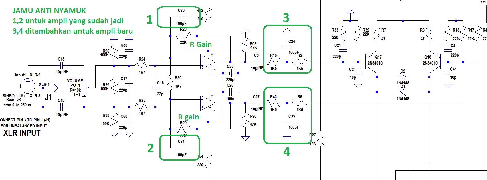

Keep it twisted as before. Just remove half side and move negative feedback removed side to GND.
Using BD139 / BD 140 is fine.
This is anti hiss... I found recently. In indonesia we call it anti nyamuk (mosquito noise) for UcD.
Put cap No, 1 and 2 should be enough.
If still not working, add cap No. 3 and 4
