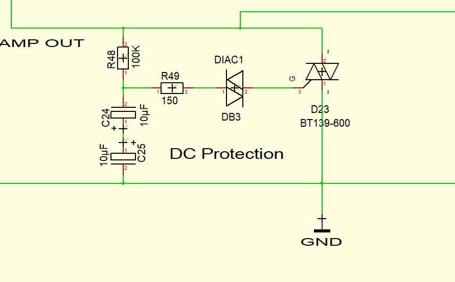

for temp control i never made it anymore, buy from china is more cheaper than build itself, having digital meter and setup trigger controller what temperature should relay on, dc protect easy with ne555 simple and effective, also ocp can make with 555 cheaper one.

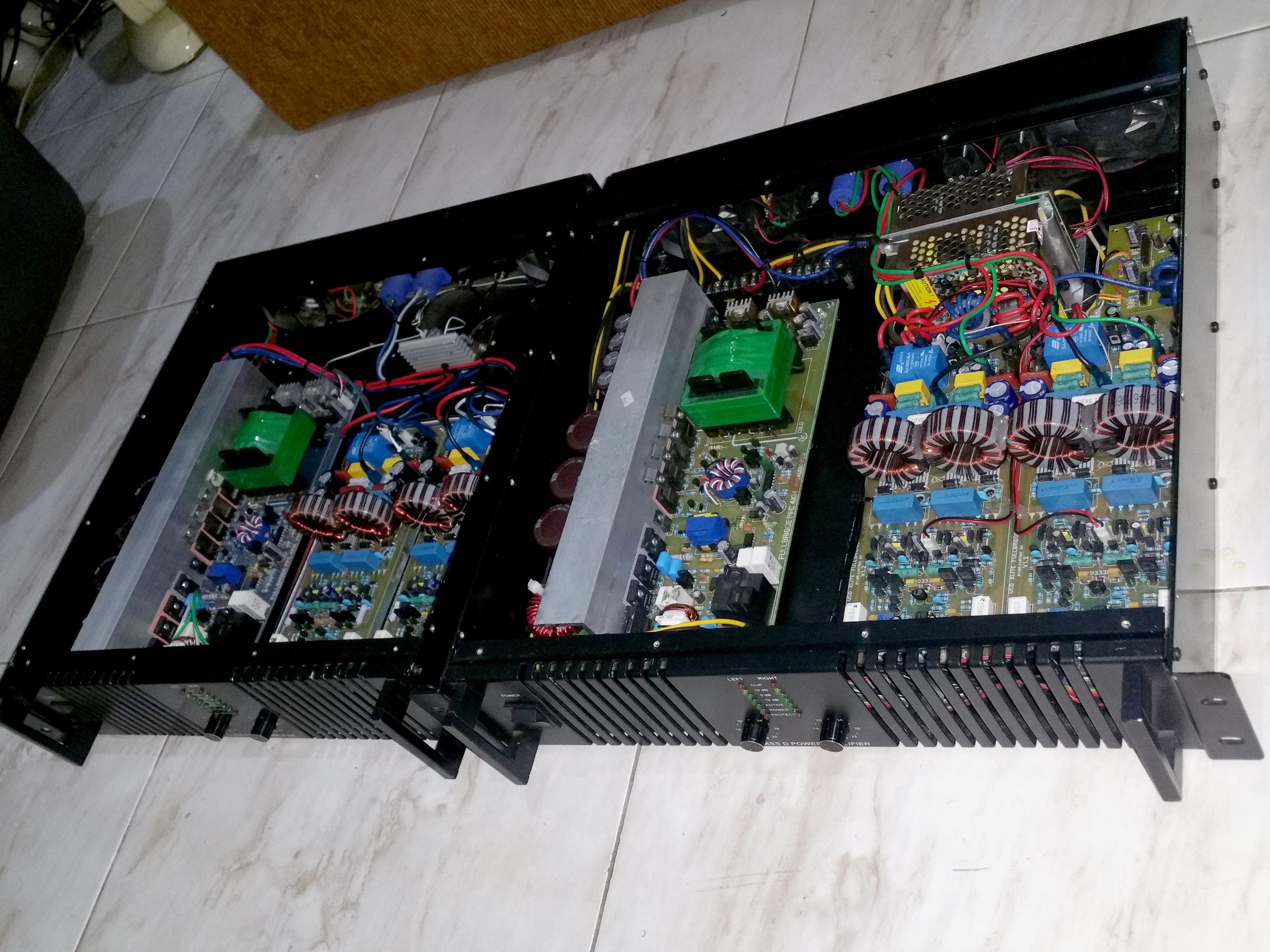

an improvement of kartino's amp . thanks to wahyu from youtube for his amazing videos .
one with relay and oc , dco protection loading , for insane power just make two of these and drive them in btl mode .
