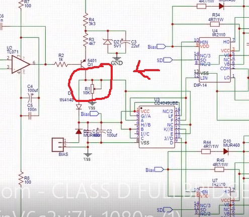

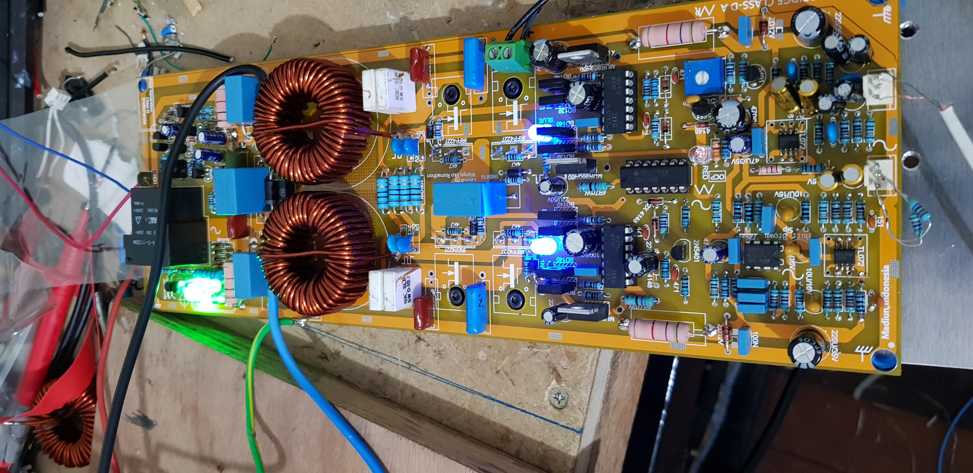

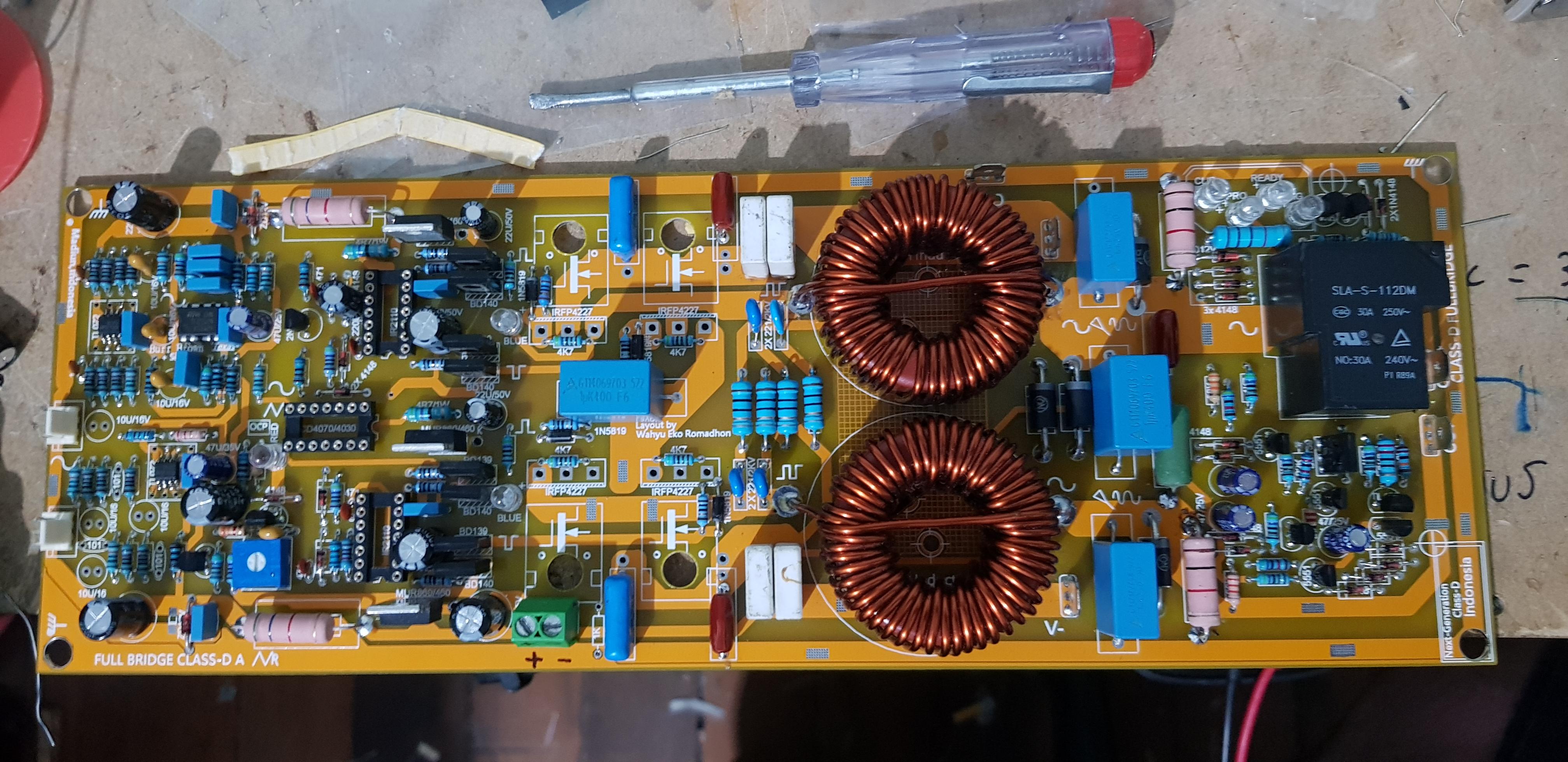

I set up this fullbridge and it worked, extract about 1500w at 4ohms with 2000w source, I am using 2 pairs of irfp260, the problem I have is the output set with about 900mv, does anyone know how to solve it? thanks

look attachment schematic
I cant see you have this in PCB,

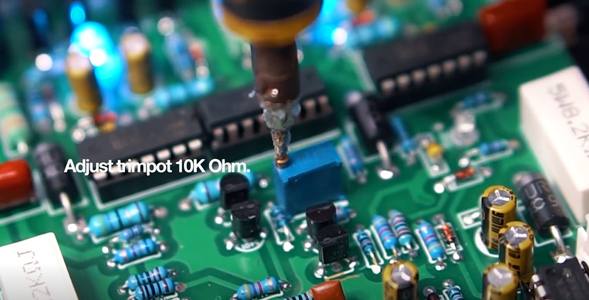

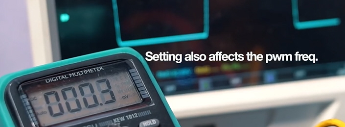

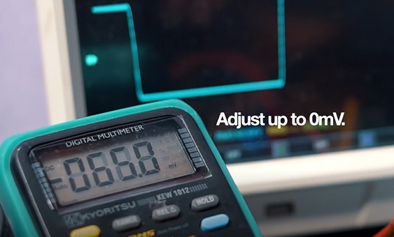

add 10K pot like in schematic and try to have DC 0 - 10 mv
You have old design PCB with error, 10 K Pot for DCO is missing, you cant adjust to 0mv if you not add 10K Pot to ground look attachment.
After add you can adjust DCO to 0 mv look pictures

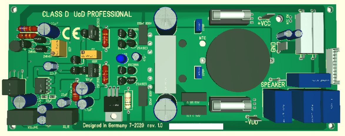

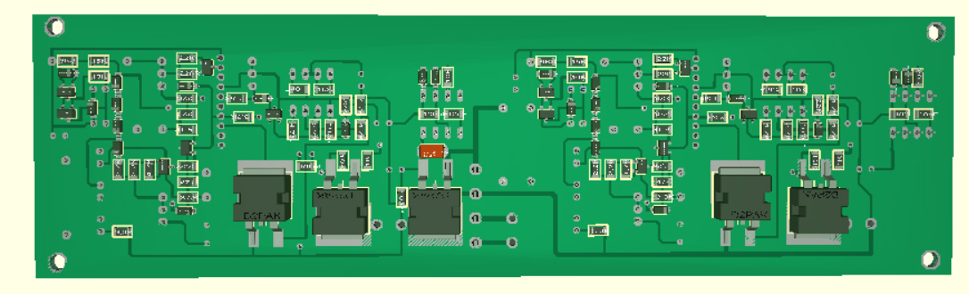

There are some updates
1. look schematic and PCB 3D
Important is Flattening and anti Hiss Update
I have add DC Protect Triac Crowbar

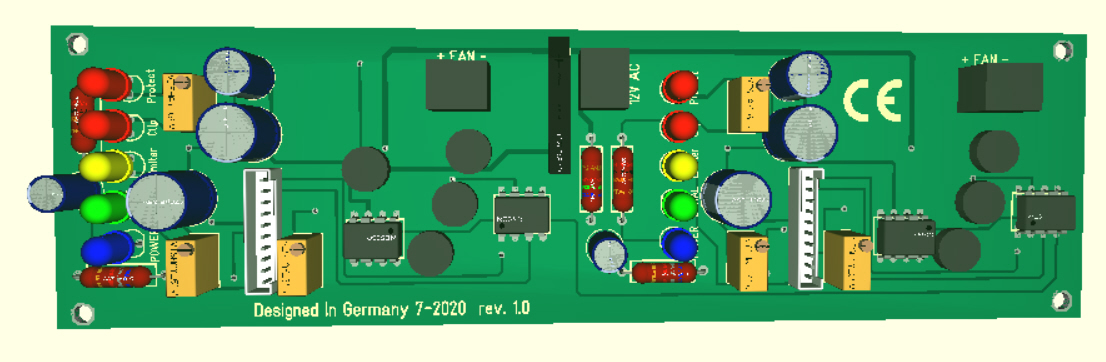

2. also i have make control Board with Limiter and PWM temperature Fan control
look PCB 3D Top and Bottom
Do you want make new PCB ? believe me its a nightmare
I did it during 2 months Covid-19 lockdown
