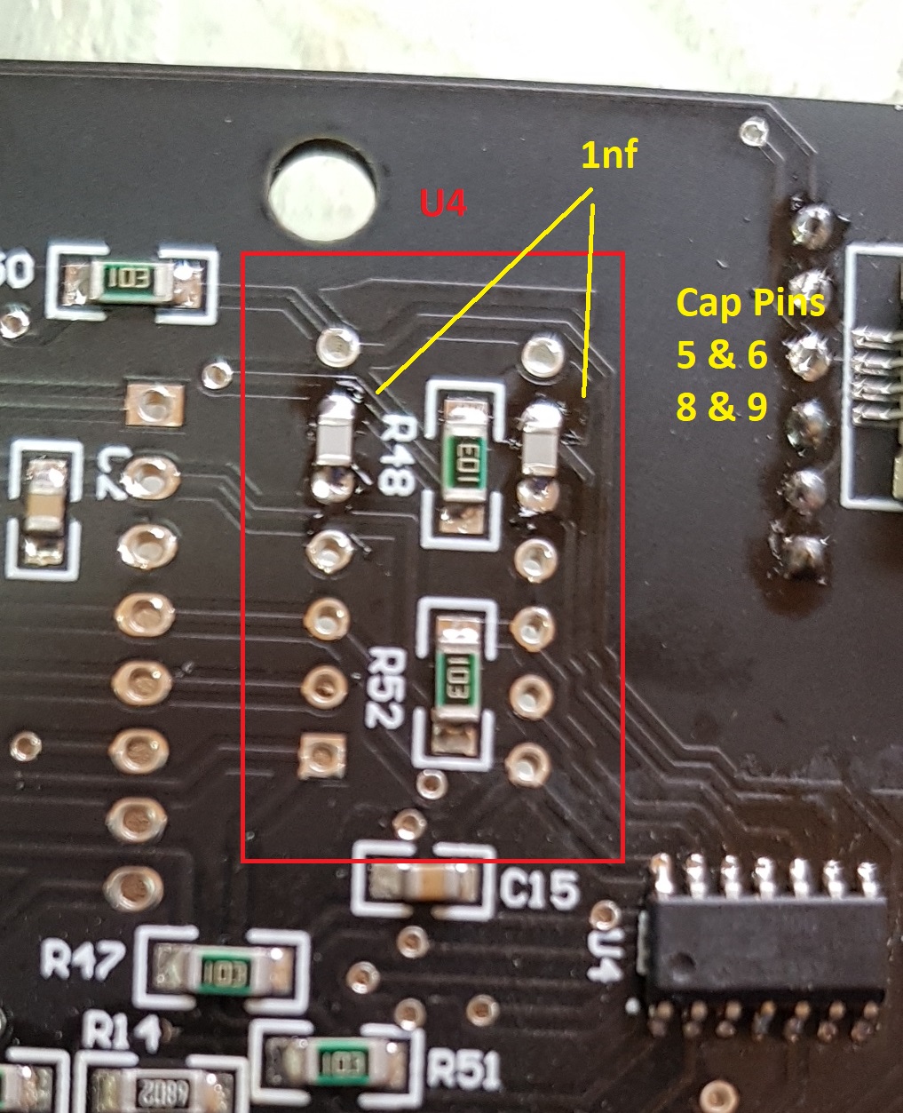

HF noise improvement
Just a quick note for anyone who received a motor controller board before September 2020. You can get a significant HF noise improvement at the output by installing a 1nf capacitor between pins 5 & 6 and 8 & 9 on U4. I have posted a picture using 0805 SMD 25v caps but you can also use 1nf disk ceramics soldered to the DIL chip legs on the top side instead. (This picture has an SMD U4 mounted and the DIL position vacant but the DIL and SMD pads are electrically connected). Your board may have slightly different component positions to those illustrated in the picture.
Adding the capacitor creates a Low Pass filter.

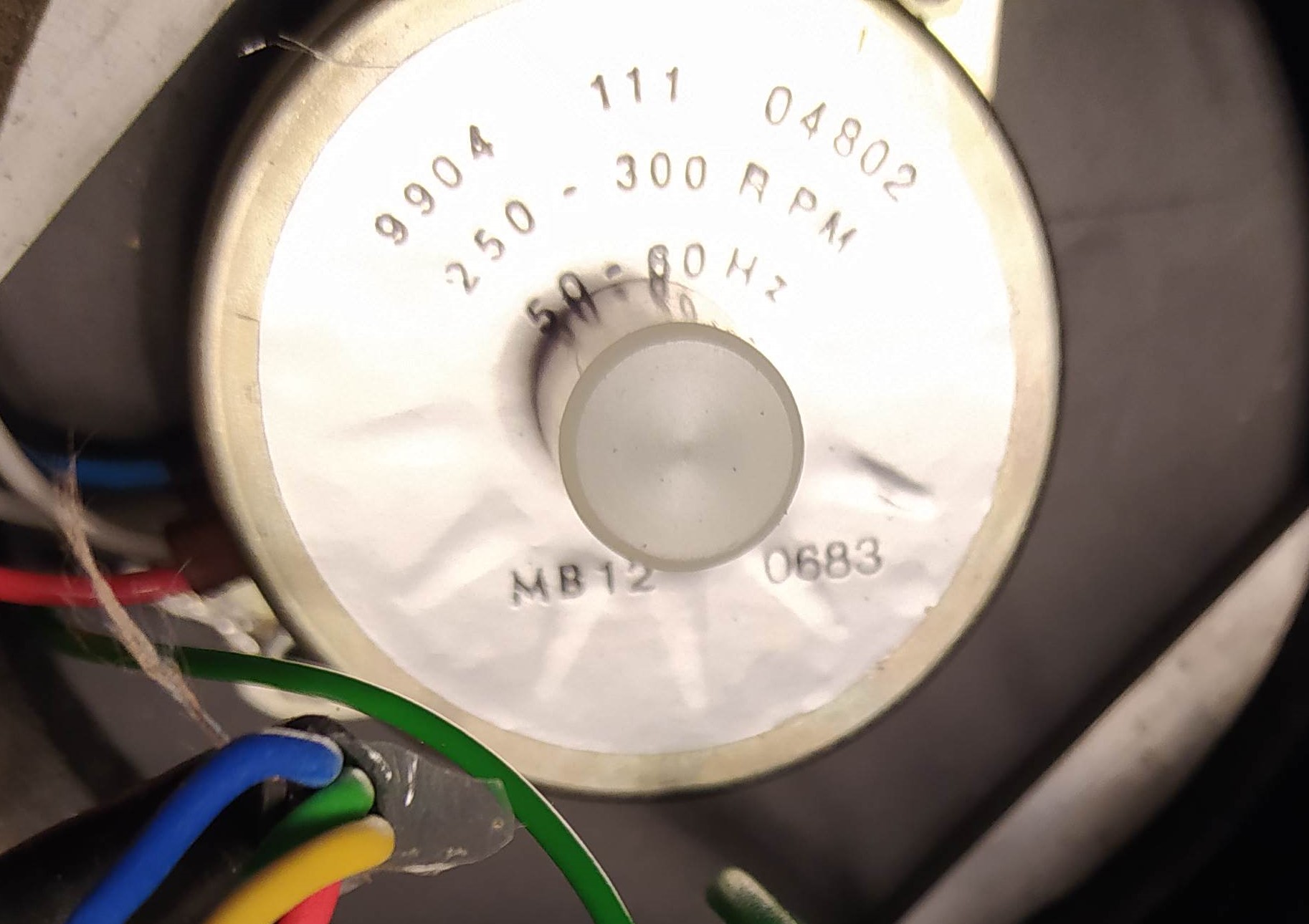

Fitting the motor controller board to my Heybrook TT2....and am falling at the 1st hurdle!!
Need to establish if the motor is a 110v AC 2-phase synchronous type....or NOT!!?
So far....can't find anything definitive on t'interweb....
Here's a pic showing info on label of the motor:

HF noise improvement - Update
It seems I can't count. :eek: The upgrade is pins 5 & 6 and 9 & 10 (not 8 & 9 as I previously posted)
Just a quick note for anyone who received a motor controller board before September 2020. You can get a significant HF noise improvement at the output by installing a 1nf capacitor between pins 5 & 6 and 9 & 10 on U4. I have posted a picture using 0805 SMD 25v caps but you can also use 1nf disk ceramics soldered to the DIL chip legs on the top side instead. (This picture has an SMD U4 mounted and the DIL position vacant but the DIL and SMD pads are electrically connected). Your board may have slightly different component positions to those illustrated in the picture. (Post #263)
