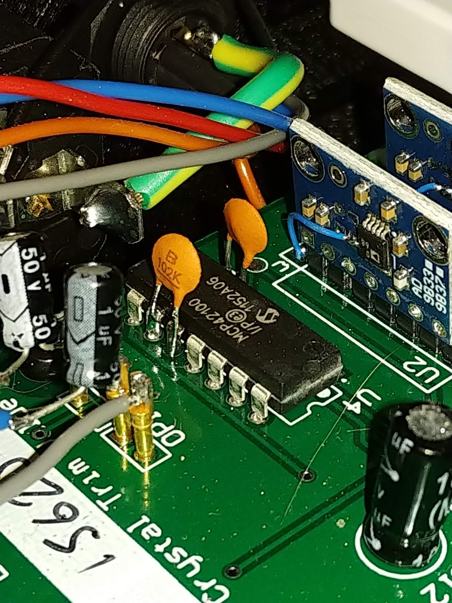

Thank you Garf, I just soldered a couple of 3300pF Wimas, hopefully they are close enough in value. I checked datasheet for U4 (MCP42100) and did not find reference for these caps there, the parallel connection seems indeed a low pass filter, I cannot test it though at the moment..
