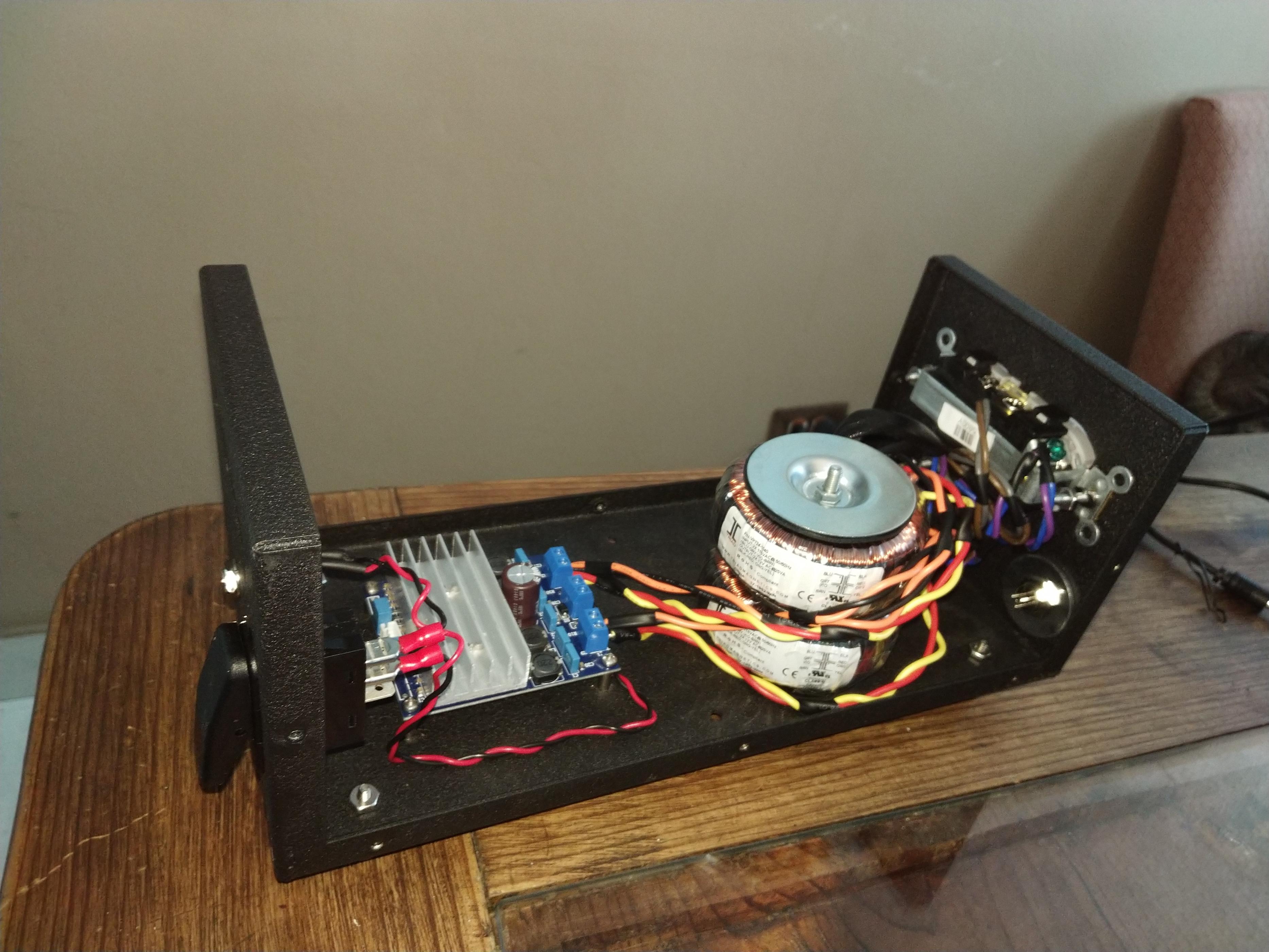

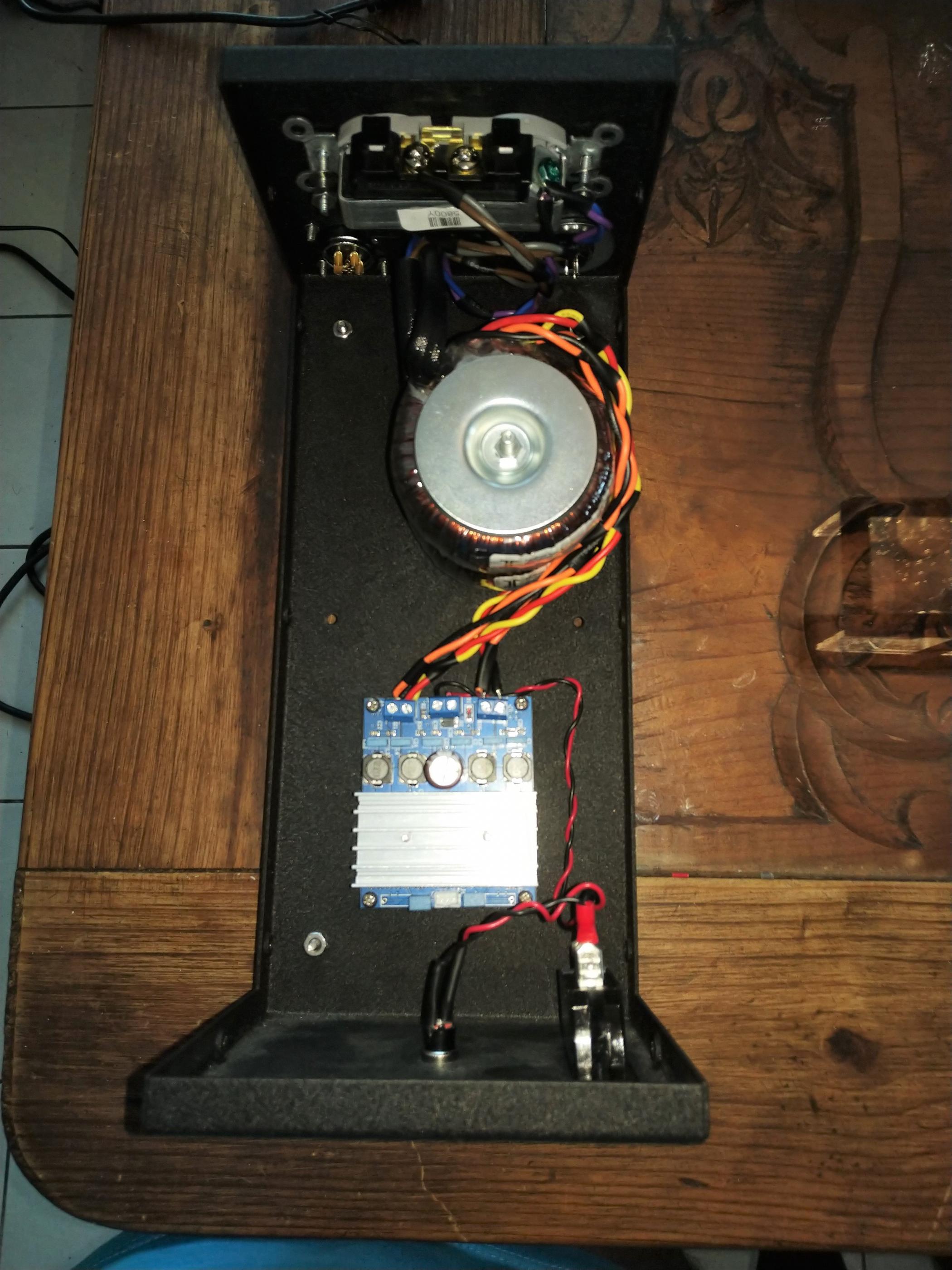

Hi iaRIVR & sachu888, I don't know the kind of motor in all turntables but I think the Thorens 125 & 150 probably use 2 phase 24 pole 115V synchronous motors. (I did a quick google search). If you can confirm then yes the controller is suitable in native form. If it's a shaded pole motor you will need a Class D booster amp and transformer as well. This has been discussed in earlier posts.

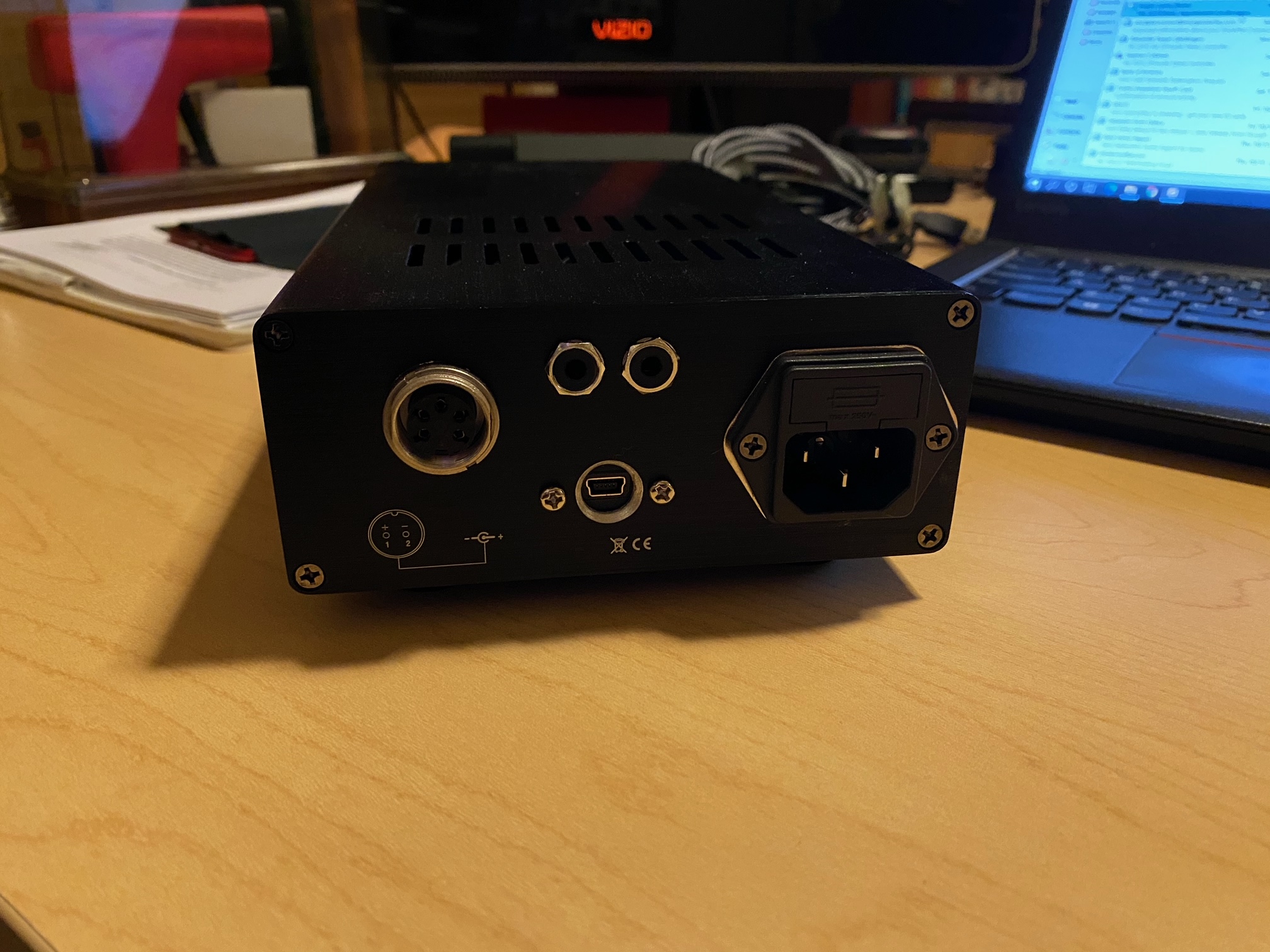

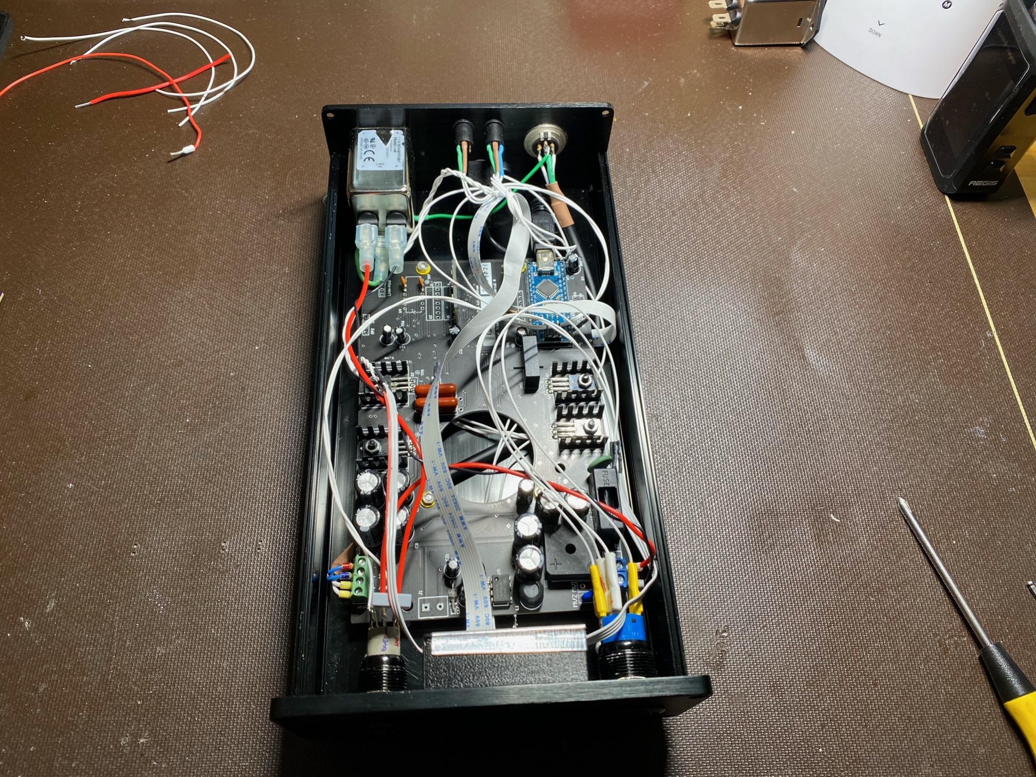

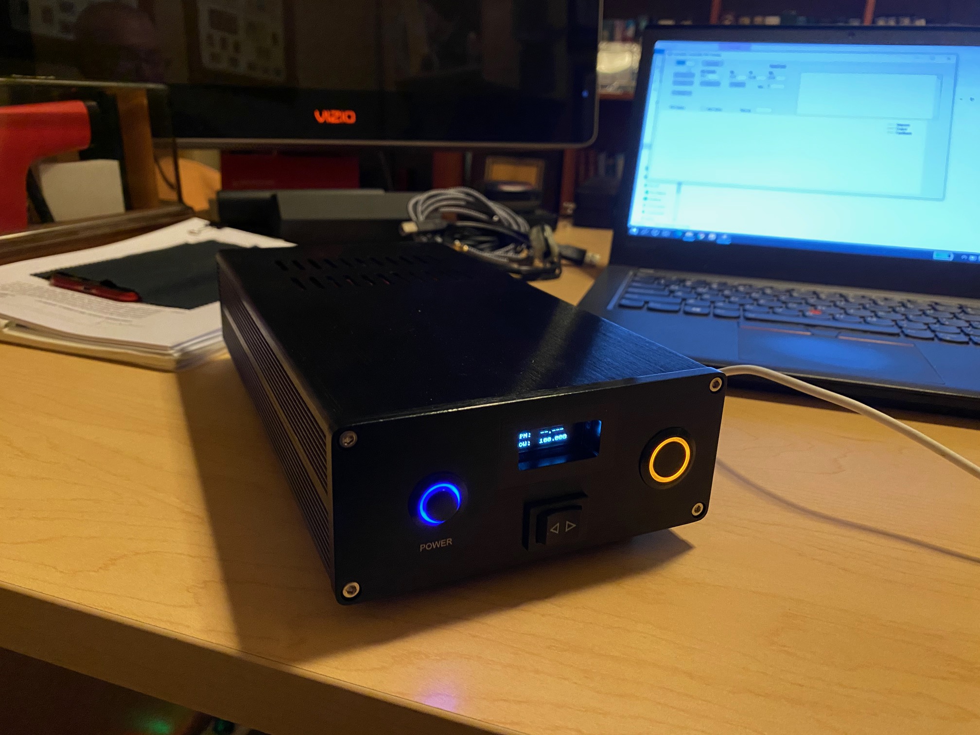

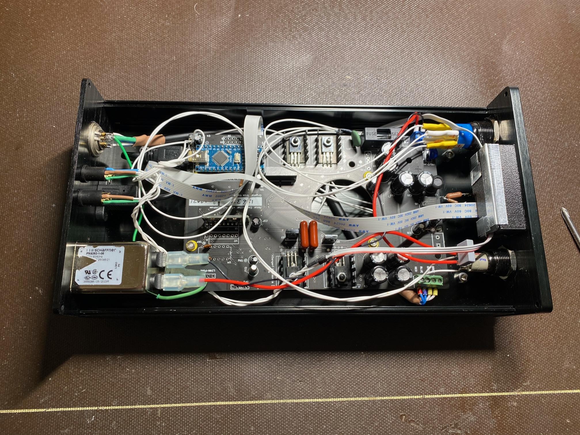

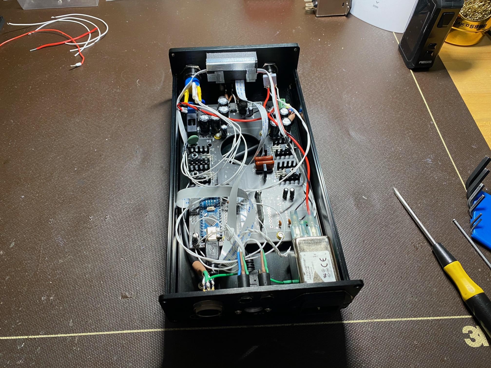

Here is my assembly. I use Zeus on my fully rebuilt Conrad Jonson Sonographe SG-3 turntable. Motor is new Premotec 9904 111 31813. Thank you scobham for very nice piece and prefect addition to DYI world.
Hi Sachin, 16 pole does not matter but the current and voltage will. If it's between 9v - 115v and less than 20mA total consumption you will be fine to use the board without a Class D and step up transformers.
Very nice casework alexkosha!

NICE...
Wow... super nice casework.
where did you get it done with the openings and white markings?
I purchased that box from eBay and all additional holes are grilled and filed here in my home. White ring seen over USB port is a cone shaped with 90 deg cavity made by my drill-bit and black anodizing is removed from that area.

Congratulations...
Well congratulations on the customization, you did a great job and look factory finished.
