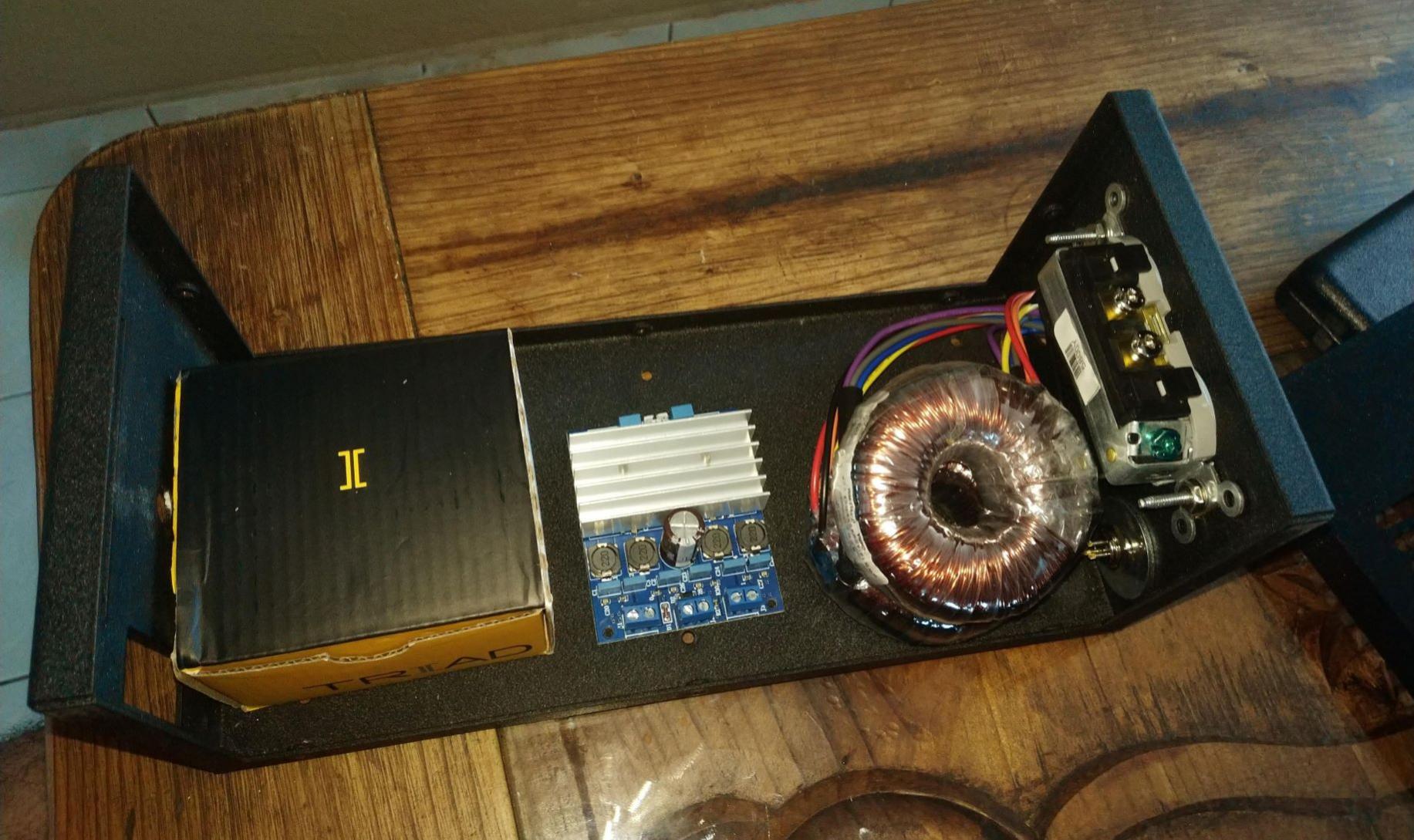

Years ago I purchased 2 power conditioner cases for a reasonably cheap price. One to use on a battery bank project to power my DACT CT-100 phono stage.

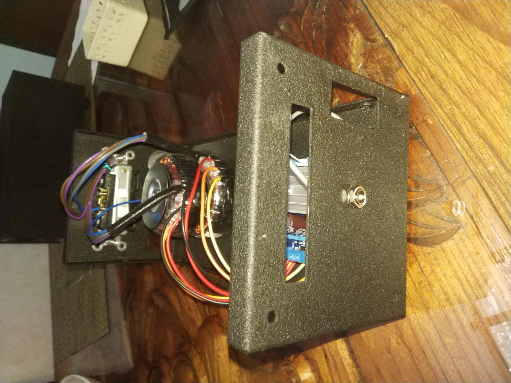

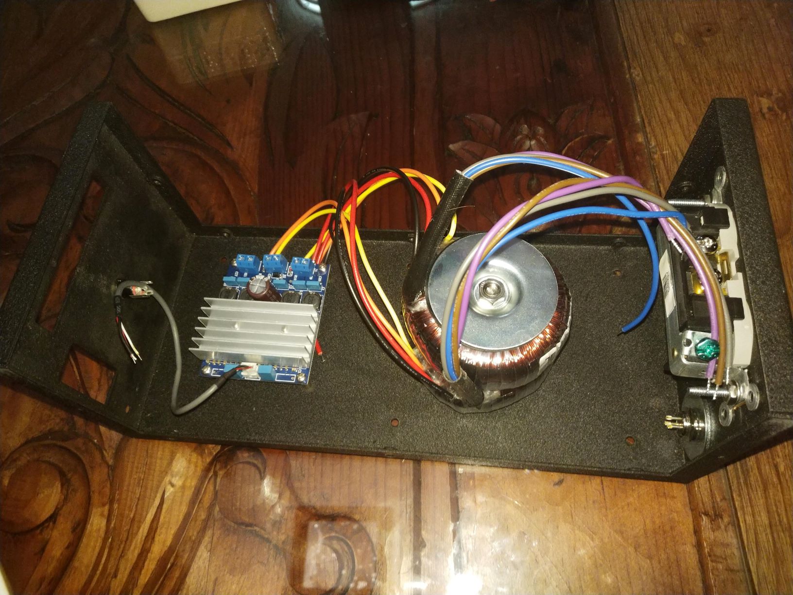

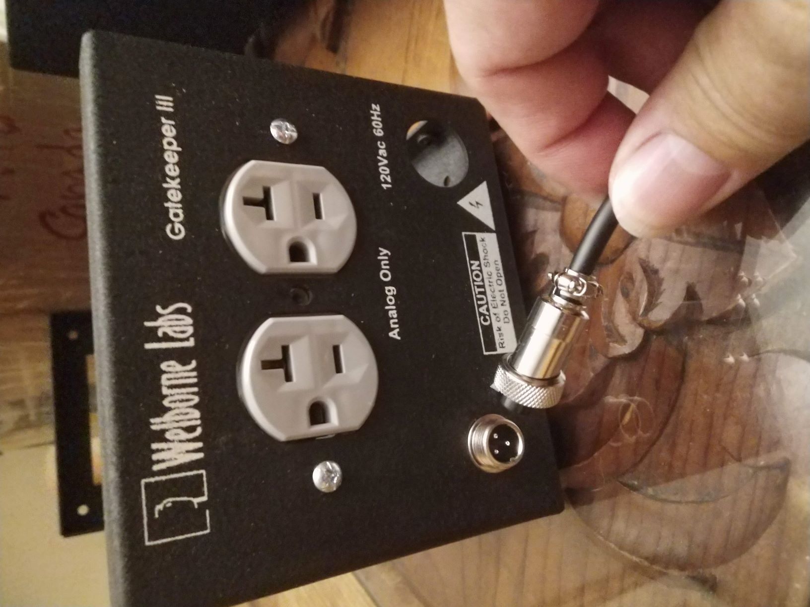

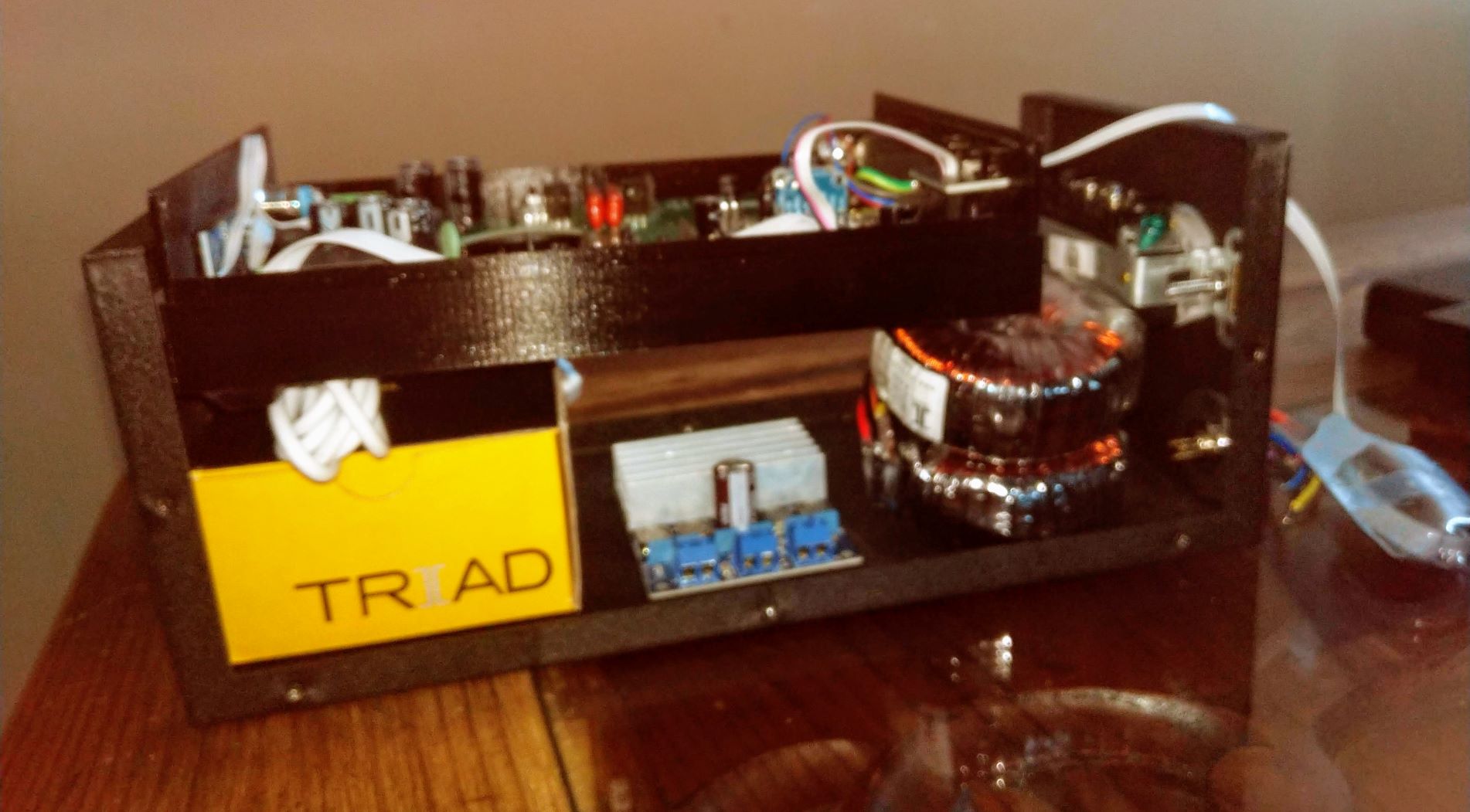

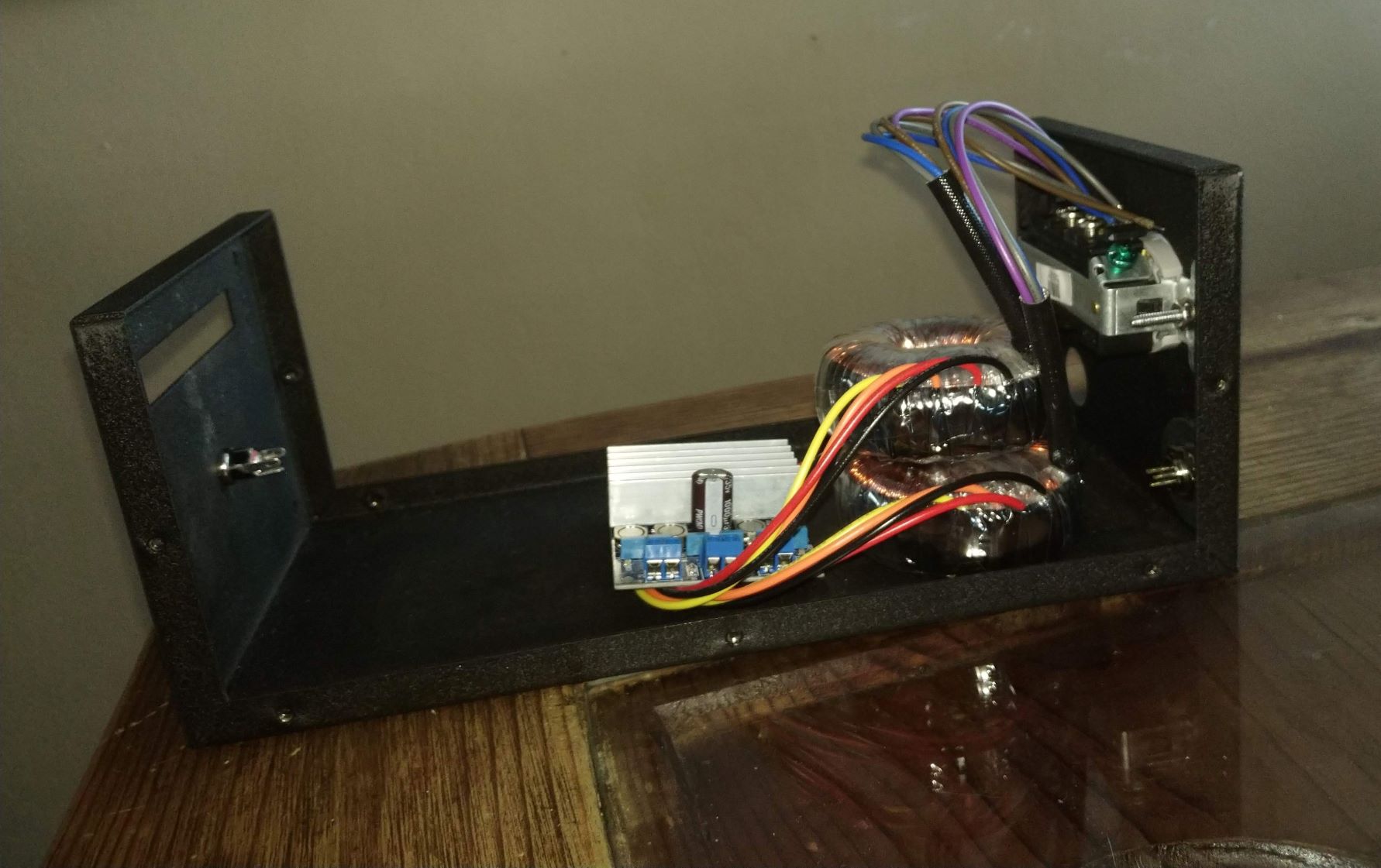

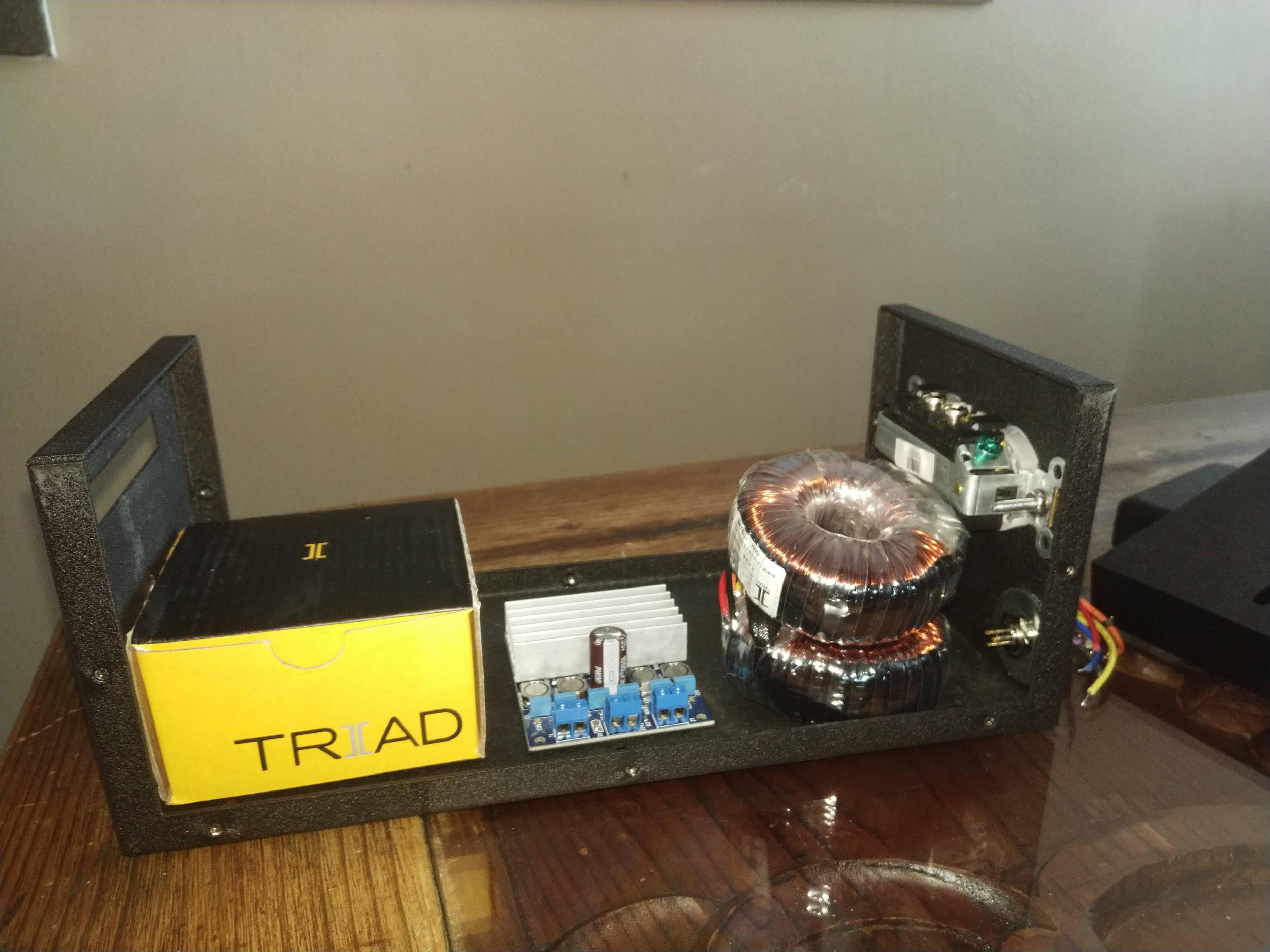

The other to a then "undetermined future project". The class D amplifier to be used with the Zeus has become such future project. So, while waiting for the arrival of some wire and connectors I decided to layout the amplifier main components on the case.
From left to right on the case are the SMPS power connector, the TDA7492 amplifier board, the 2 Triad toroidal transformers stacked, the duplex outlet I will use to to connect the motor cord to the amplifier's output power, the 3 pin connector to wire the existing motor on/off switch.

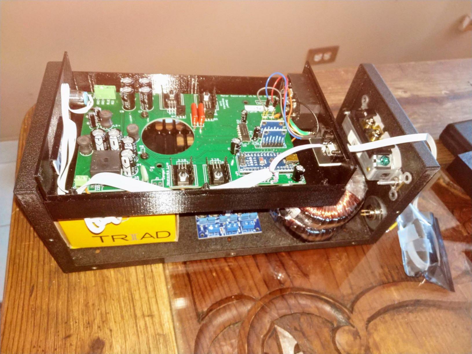

I just did some laying out and putting everything in my case is doable. But I think it would require mounting the controller in a second tier inside.
Also, I would rather not have an AC power chord and the SMPS connected to the case as it would look odd... So just thinking (and stating again, that I don't have any real knowledge on how to do any of these things) I guess I would place some sort of DC power supply inside the case where I placed the Triad box (in the pictures) instead of using the external SMPS like I will in the 2 box install.
I guess I would also need to procure a 3d printed faceplate to mount the display and the momentary button.
Any suggestion or opinion is welcome..

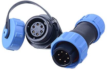

Scobham I have one more question for the 2 box install.
My plan is to have the amplifier box located in the floor behind where my turntable is installed. Thus the umbilical connecting the 6 wires from the controller to the amplifier will need to be longer than the one supplied.

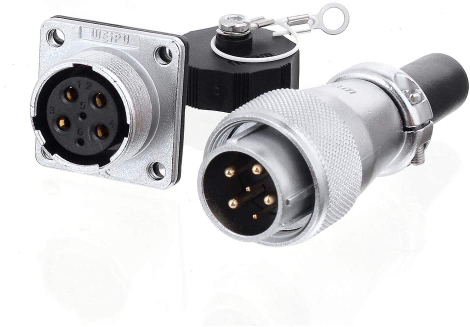

I already ordered some of the 22 gauge Alpha Wire you use and a larger WEIPU SW20 6 pin connector to install in my case (I known is an overkill but the existing opening in the case is 21mm and was not easy to find a fitting conector), but I need another of the sd13 connector you used in the umbilical cable. Picture attached. ( link for info Amazon.com: WEIPU WS20 Aviation Connector Male Plug to Female Socket Waterproof Metal Thread Panel M20 Connectors 6 Pins for AC DC Signal LED Industrial Equipment: Home Audio & Theater)
The WEIPO connector is similar to the one used in the Hercules II PSU.... not the same.
I found one in Amazon and would like to know if its the same ( or compatible) as the one you used, so I can order it. ( link for info Amazon.com: SP13 Aviation Connector M13 Male Plug + Circular Female Socket Φ13mm Outdoor Waterproof IP68 Plastic Connectors with Cap Panel Mount Gold Plated 6 Pin for Industrial Device Power Signal: Home Audio & Theater)

That link does look like the same connector. Check ebay as well as I think they may be a lower price.

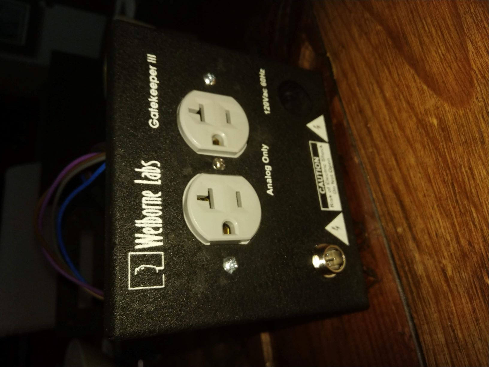

Just missing one connector...
This morning I received most of the parts to complete the project.
Just missing the SD13 6 pin connector.

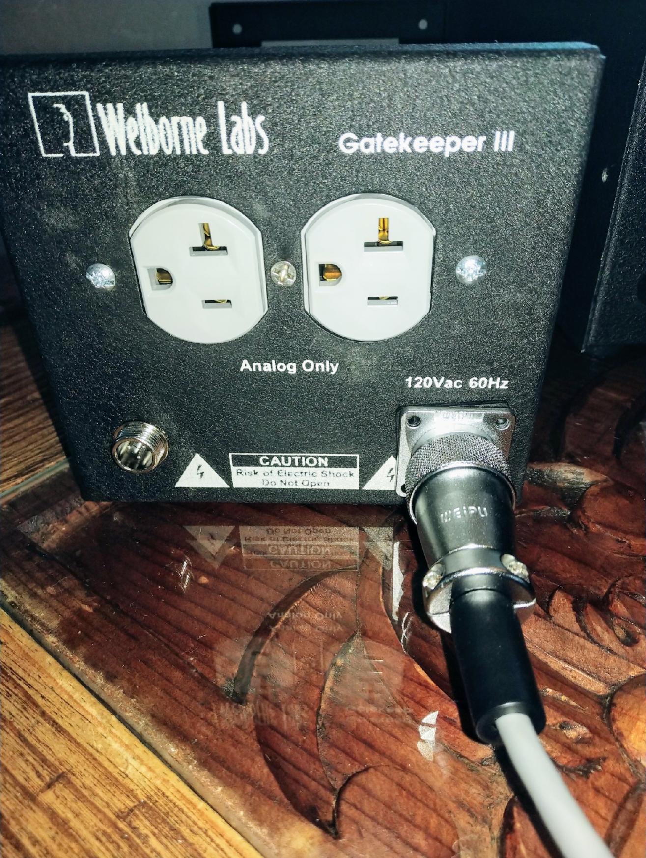

This is the back of the case with the WIPEU WS20 presented..... Nice.... Still I ordered a set of the Lumberg KFV-60 and SV-60 to check which one is more convenient with the case.

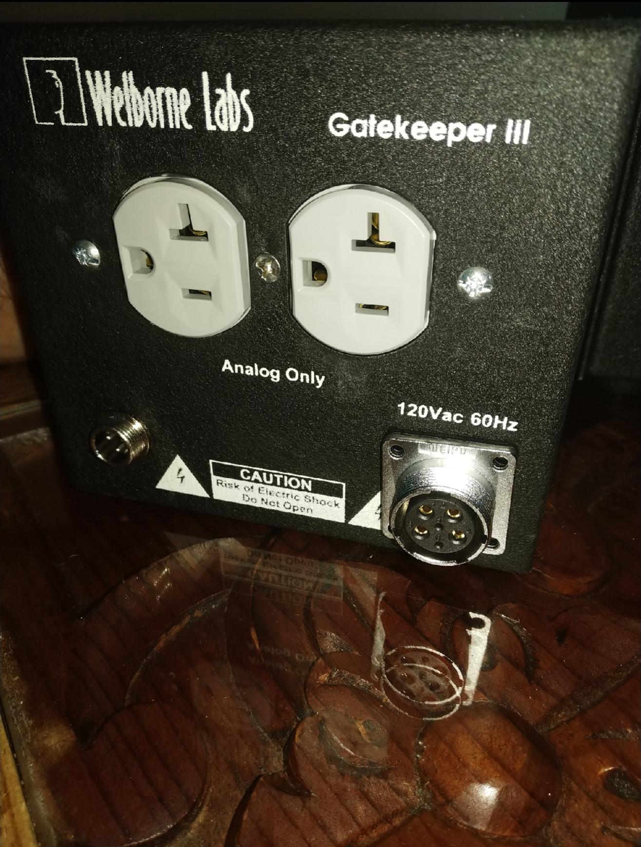

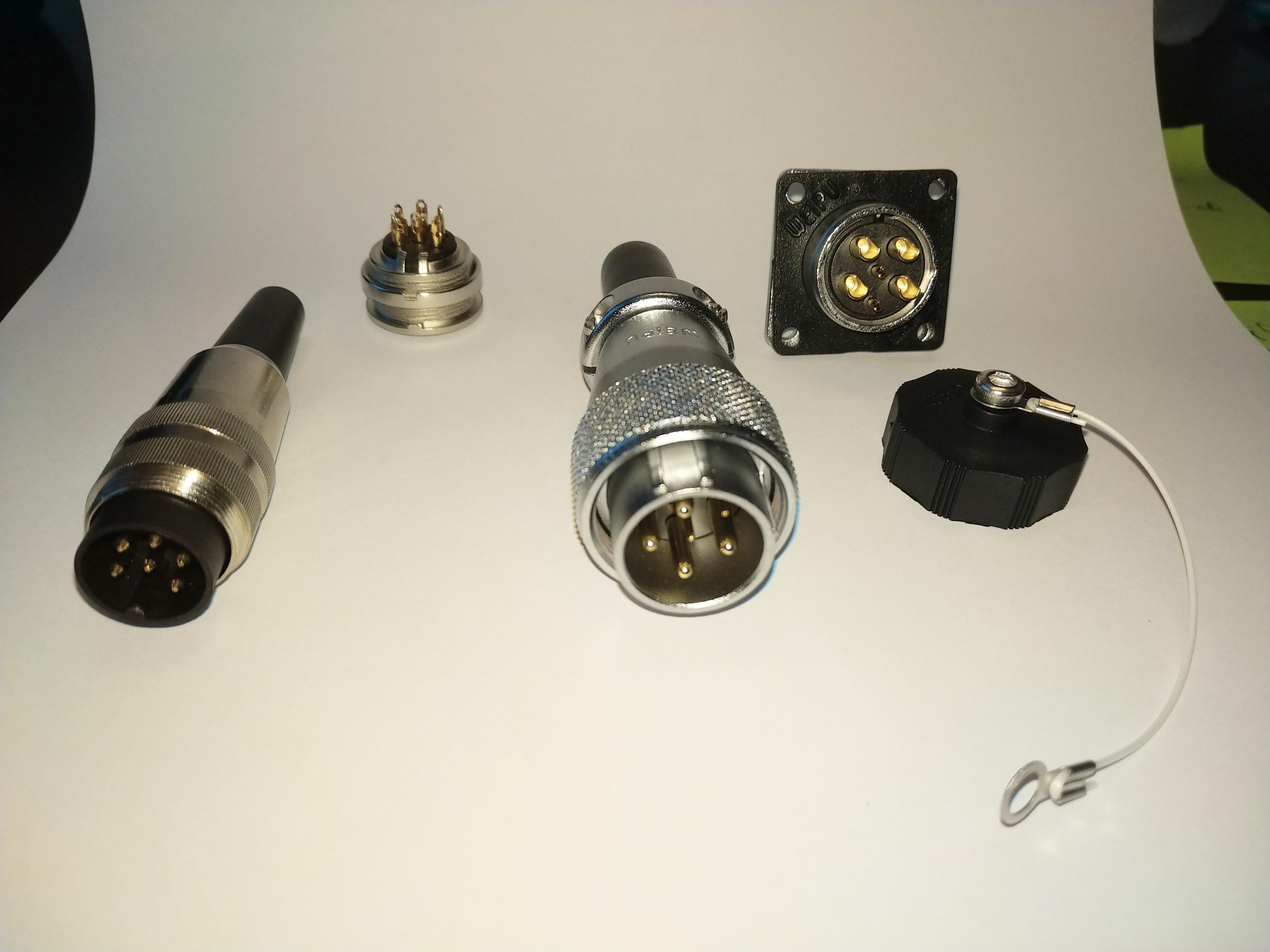

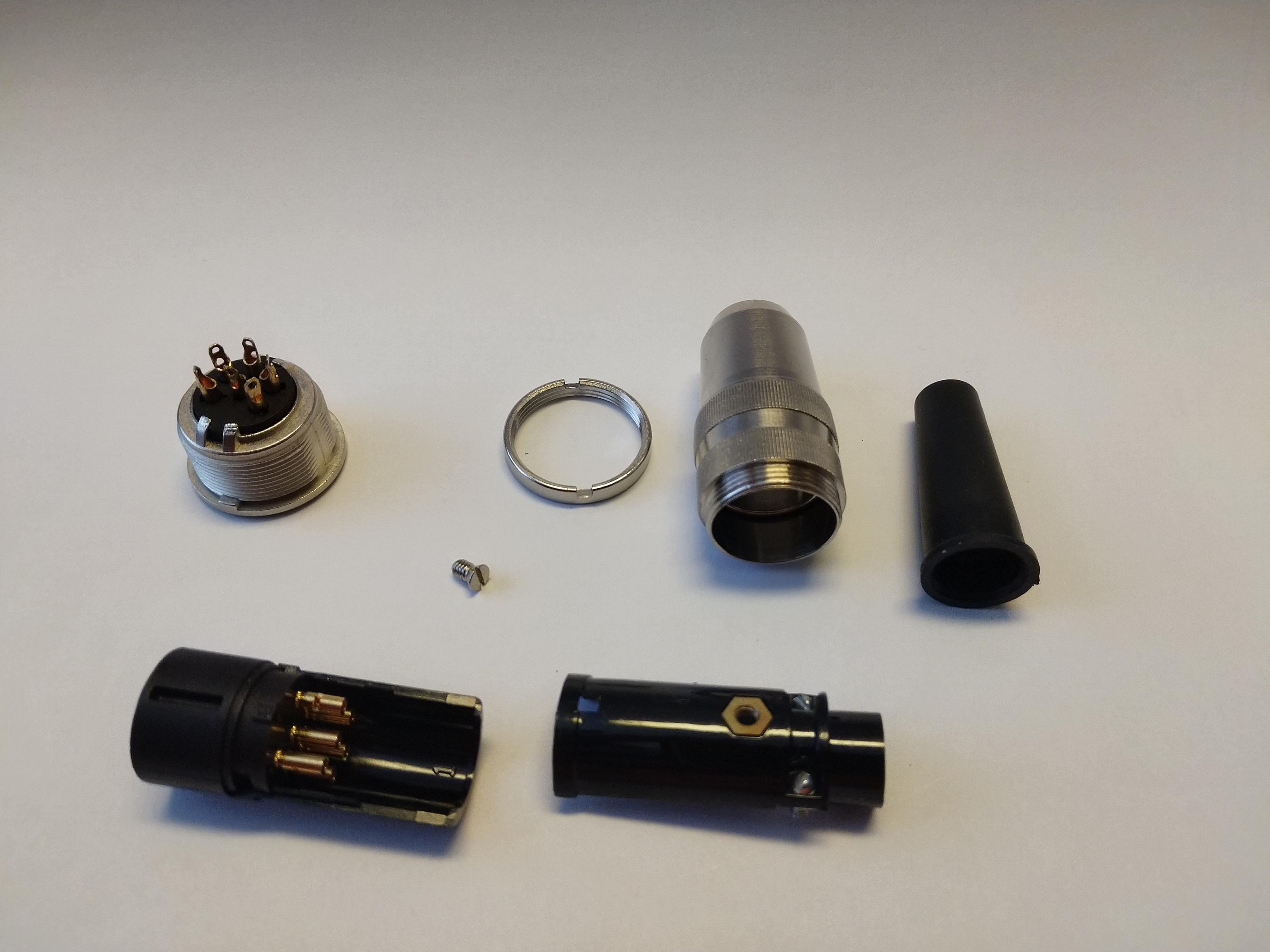

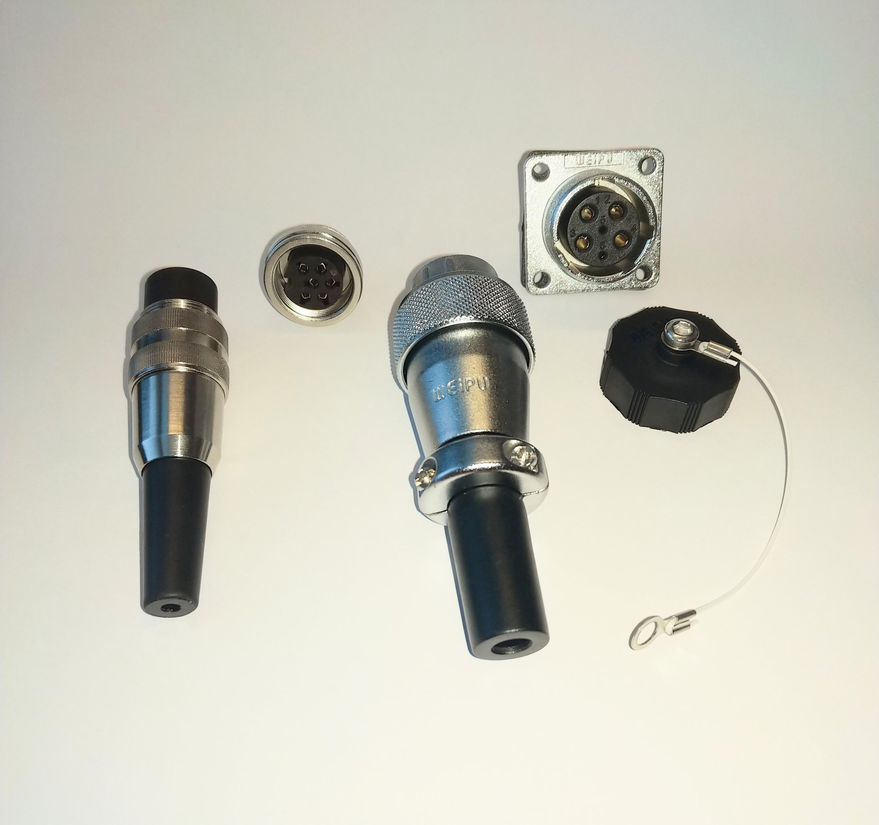

Attached the pictures of the 2 6 pin connectors.
On the left the Lumberg SV-60(male) and SKV-60(female), and to the right the WEIPU WS20 ( male and female set).
Both are well constructed and terminated, but the Lumberg seems like a more refined and better terminated design.
The Lumberg is for mounting on a 18mm diameter hole and the WEIPU is for mounting on a 20mm diameter hole. As the existing mounting hole on the case is 21mm, I will be using the WEIPU since it would require no adapter.
For the benefit of other users, attached are several pictures of the 2 conenctors.
