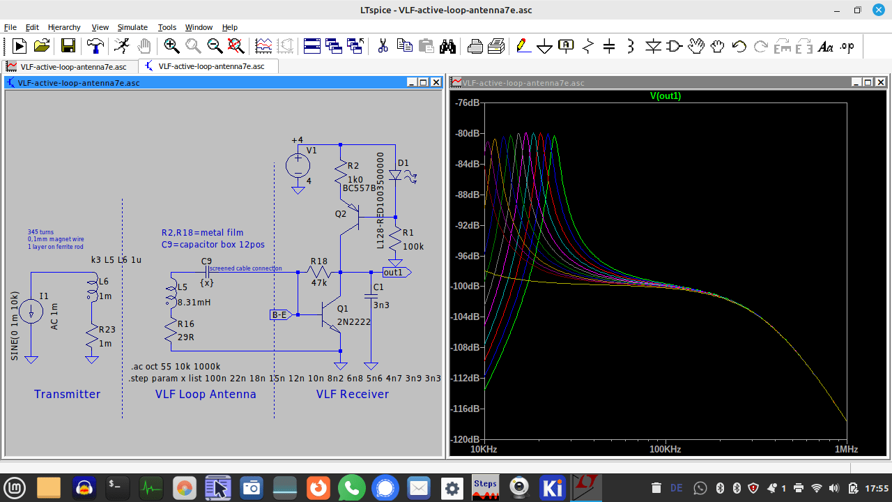

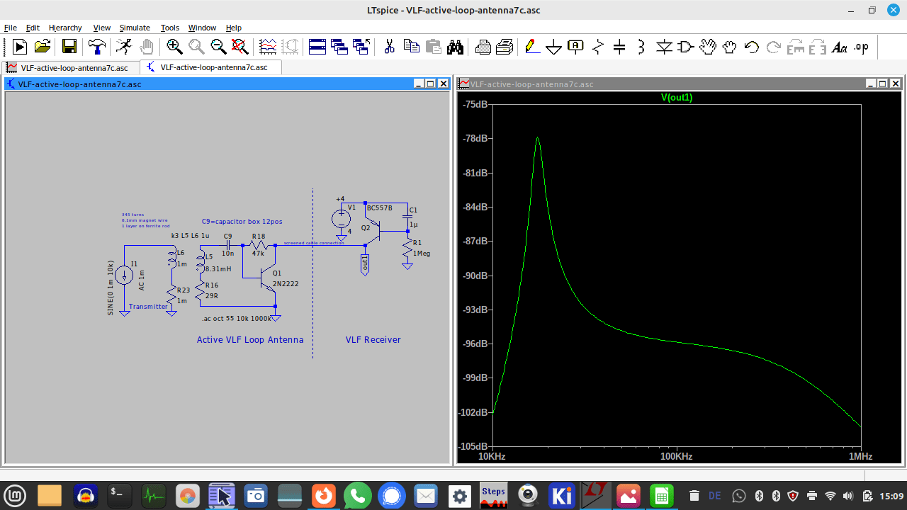

That's an interesting and surprising result. My guess would have been for a bigger difference, just goes to show how useful simulation is.I repeated the sim from #417 with C2=1p/200pF (green/blue trace). Obviously the additional 200pF do a small resonant frequency shift downwards. And that's it.

Look at this simulation.
The npn transistor may be mounted close the ferrite rod.
Its collector drives a screened cable.
At the other end is the VLF receiver with further amplification that delivers supply current of the input npn.
Instead of a resistor, a pnp current source inside the receiver provides current and a high impedance.
Thus open loop gain of input npn increases and the resonant peaking is improved similar to the results with an op amp.
Next step is placing a 12pos rotary switch with 12 caps close to the ferrite rod antenna to select 12 different resonant peaks.

Corr.: The high impedance driving a screened cable will result in a unwanted low pass response, not a good idea.

So I verified the proposal from #425. The pnp current source with its high output impedance increases voltage gain to about 60dB.
With different resonant caps an additional resonance boost of 20dB showed up that roughly confirms simulation.
Another advantage of the current source is constant gain over a wide supply voltage range.
With the following dual OPA set for 60dB gain output signal is big enough even to feed the poor internal sound card of my laptop.
Supplying the pre amp via USB this could become a simple mobile setup.

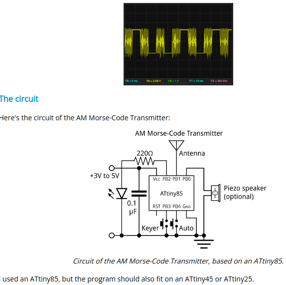

Now that the SAQ is just down, where will you detect your CW signals. Here is micro CW you can run in your home.
http://www.technoblogy.com/show?3QEF
The antenna is a meter of wire. The signal is detected on an ordinary AM radio selected around 600khz

Without the code flashed into the attiny this will not work at all.
Btw carrier frequency is far above SAQ - and using the internal RC oscillator frequency may vary with some percent tolerance.
So I propose to wind a big coil - similar to a Helmholtz coil -
and feed it directly with 17.200 Hz generated by your soundcard
creating a weak magnetic field in the center of this coil.
