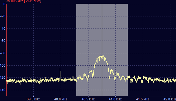

I posted the pictures to show how really simple it can be to create a home-brew coil with material from the work shed.
And using this coil as a transmitter I did this spectrum from 10k~100kHz.

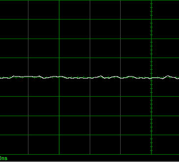

The second plot is the spectrum without my noise h-field, but at a noisy place of my lab.
Oh yes at first glance I thought it was noise but its signals maybe electronic noise or real signals? I'm not used to looking at such a wide spectrum after concentrating on SAQ. The signals ofter seem to be at multiples of 10 KHz! I had another look at your circuit, it looks to me as if Q2 is a constant current generator whereas Q1 is providing the gain. If it works well its a very minimal low cost circuit. 2N2222 is very popular npn and the pnp is quite common too.Removing the noise h-field this is the noise floor remaining
Understand this is intended to be a flat response - for non selective operation from 10 to 100 kHz so that's an interesting range. My original thinking for a strongly resonant circuit (for SAQ a long distance away) was to do part of the filtering as analog components and the rest digitally. Doing all the filtering digitally runs the risk of strange aliasing effects - digital filtering isn't perfect - the best possible digital filter is (Sin x)/x but unfortunately it has infinite number of coefficients! But digital filtering is pretty good.
Have you tried comparing the circuit noise generated by this transistor circuit and an equivalent OpAmp circuit? Have you tried feeding your home-brew coil from a signal generator and checking how linear the response is?

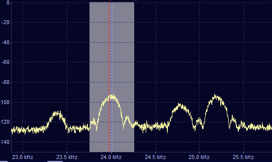

I have seen that shape many times on VLF, it looks like some form of truncated sinc (sinx/x) function.Most maritime mobile VLF stations are using a protocol optimizing data rate vs bandwidth, which shows a characteristic spectrum.

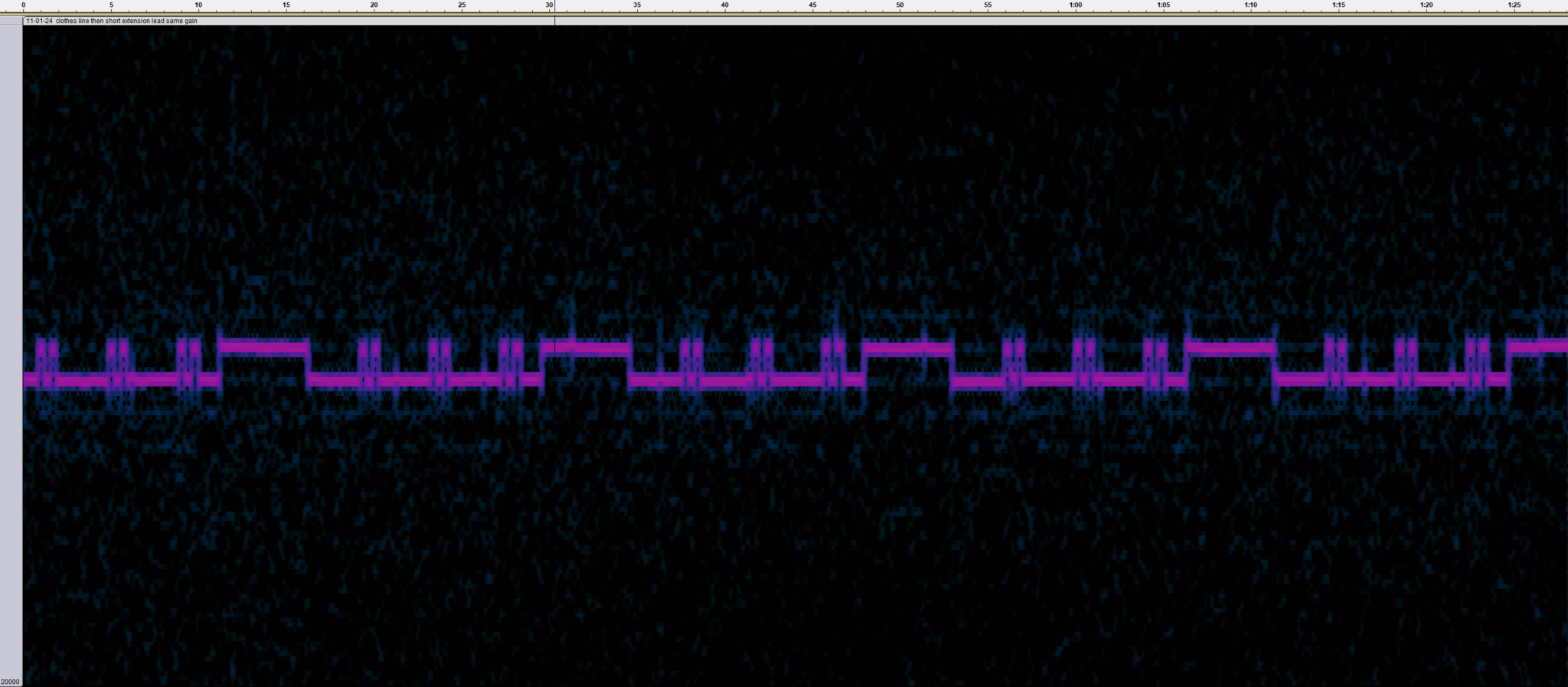

I have seen some stations on there where they have two carrier frequencies close together and they switch between them.
That could be FT8, each transmission has a carrier that varies by only a few hertz, changing about twice a second. I think it's actually eight frequencies it uses within its narrow band (thus FT8). On most HF bands there's an established frequency where a dozen or more transmissions occur simultaneously within a SSB voice band (2.7kHz). It's generated and decoded on a computer connected to the radio's mic and audio out connections, and uses a lot of DSP. You can send and receive messages around the world with a 100 watt radio.I have seen some stations on there where they have two carrier frequencies close together and they switch between them.

Due to my distance from most VLF transmissions I can see the sidebands of just a few. Long ago I treated FSK as two ASK signals which worked better than any FM demodulator (including PLL). It even worked well for MSK and similar modulations, up to 200 bps. I think a major reason to optimize modulation for maximum speed is the use of a coding protocol to hide the information for those who're not intended to be reading along. While with plain text it's easy to correct errors, that's different with a coded signal. So it's likely some form of FEC is used and the modulation is tweaked for maximum depth of the submarines. With an FM demodulator at the previous source, the rise and fall time are obvious.I have seen that shape many times on VLF, it looks like some form of truncated sinc (sinx/x) function.

That above is the CW switching I referred to.

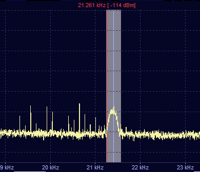

At 21.4 kHz I receive Hawaii NPM, using MSK as well. Only when using a too high demodulation bandwidth, some rectangular pulses are visible.
