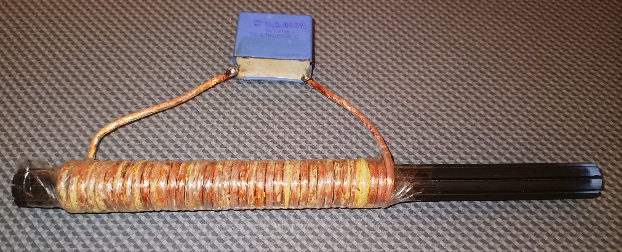

I'm building a simple receiver feeding into a preamp plugged into my Laptop PC that is running a sound recorder program. So far I have wound a 35 turn coil using many-stranded Litz wire onto a long ferrite rod and plan to resonate this at 17.2 KHz with a good quality capacitor. Then feed into a preamp built with a second tuned circuit. Simply then connect to the Laptop PC using 3.5mm Jack plug.
Can anyone advise me as to the best way to build this simple receiver? For instance will the ferrite rod be enough of an antenna or should I connect to a long wire? Will a preamp with effectively two tuned circuits likely provide enough gain? And so on....

There are several operating VLF transmitters globally running at different frequencies. The VLF band goes from 3KHz to 30KHz. There is also noise. I think you will see something on your spectrum analyser at 17.2 KHz. Shed at the bottom of the garden good idea.
Think you need at least one resonant circuit at 17.2 KHz.

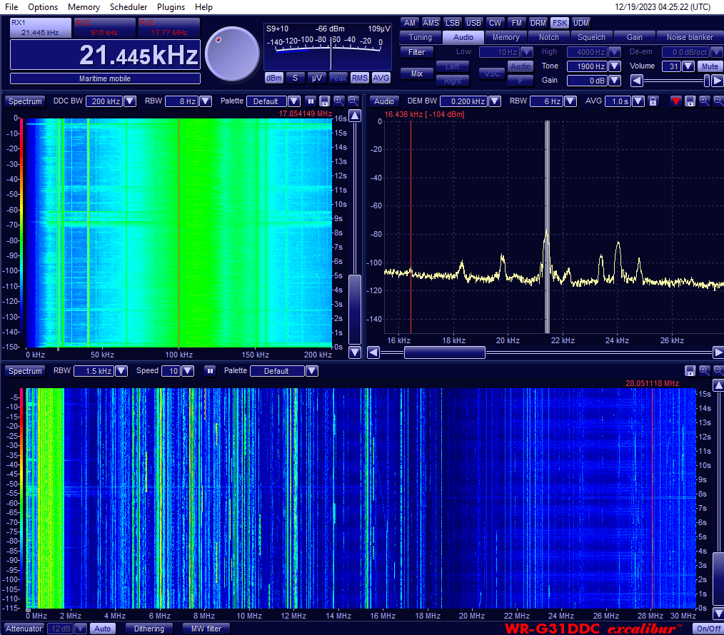

The active WB loop antenna I recently designed, (clumsily) built and installed is my best antenna, yet. Although not designed for VLF, the following stations in the range of interest are visible in Panama near the border with Costa Rica. If I don't forget it I'll try to see if 17.2 KHz sig is visible. The "fat" sig at ~100k is from the power company.
@fubar3 That's very interesting so having worked in this field you understand the respect and admiration I have for same especially the Grimeton SAQ effort. Yes I read that SAQ is vertical signal so the vertical whip makes good sense as does a coil wound on a large wooden frame. Thanks also for the PCB link. I think that my ferrite core will concentrate the signal enough but will make an additional setup probably the vertical whip using a long wire. Thanks.

@Aridace If you do see SAQ from Panama it's likely that they would welcome a report from you. Very impressed by your spectral representation! I'm guessing that a spectral peak will almost certainly show but another matter if you can read the morse code above noise.
Not sure about loop antenna for VLF, consensus so far seems to be "long wire preferably vertical" With a wavelength of around 17km it's pretty clear that no way to tune the antenna by it's geometry. Thanks.
@Kay Pirinha My first thought was to record the 17200 Hz carrier on my Laptop using the sound input then replay at half speed or less, then I would surely hear the carrier and the gaps made by the morse code, I might even be able to read some of the morse at a slow enough speed.
However to be realistic it would be better to hear the morse as it's transmitted in real time and your suggestion as regards a local oscillator is the way to achieve real time and 18000 Hz sounds like a good choice for the local oscillator. Logically this could be followed by a bandpass filter at 800 Hz to make the morse even clearer.

No, I can't read morse code, but I could record the audio. There are no other signals at the frequency. It's likely I can receive it because at night I could receive the German time signal at 77.5 KHz as well (power company messes it up, so still visible and audible during a nightly power cut).
BTW for VLF it's easy to build a receiver using cheap amps like the old quad mos series TL074. When using the grid for power supply, you need a balanced input on the ferrite antenna, then a ~ X100 amp. The 4th can be used as tunable ~sine wave18 KHz oscillator that feeds a single balanced mixer, suppressing only the oscillator. After the mixer a LPF at ~1KHz, also with opamps. The 800 Hz or lower, via amp to speakers. Because of the high interference it might be wise to add clipping diodes after the 17.2 amplification chain.
