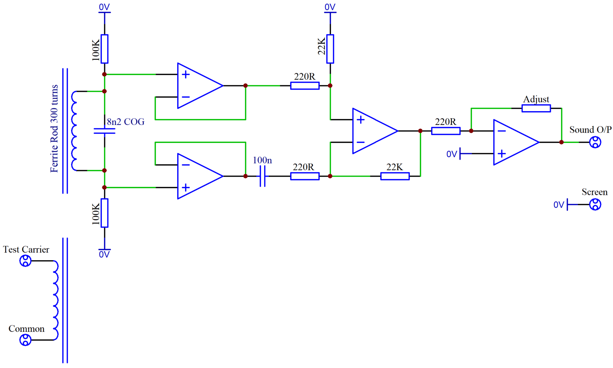

It will work, for this kind of circuits up to 20k I always used this topology. Thanks to to the symmetry no issues with "antenna effect" that requires shielding.

Yes the symmetry of your circuit looks great. I can't think of a better way to design this.

Small (in terms of WL) antennas exhibit high impedance and are capacitive. Hence for reception, the easiest way is to feed it to the top of a tuned LC with a high Z amplifier (or mixer).

Software decoding works well. I would use as long a wire as possible or a very big loop and high pass it to a PC soundcard, to reduce mains pickup. After capture, Audacity can bandpass filter - You are talking about 50 Hz B/W.

This thread is about "Tuned Sound Amplifier/Receiver" I wanted to look at receiving and processing the signal from Grimeton SAQ as purely a signal in the audio spectrum rather than the more conventional receiver approach. Notably most of the receiver designs I have seen (historical and recent) use a frequency mixing to make the Morse code more audible and often show an untuned front end.
Essentially what I am proposing to construct (and other posts above have elaborated on similar, notably @Aridace ) is as follows:-
- tuned front end (Ferrite rod / Capacitor) with high Q
- optional vertical antenna/earth connection input
- high impedance sound preamp
- buffer amp feeding directly into the sound input of a mobile phone or Laptop PC
- mobile phone or Laptop PC recording sound input into standard audio wav file or similar (with high sampling frequency).
- optional processing of the sound file
- replay of the sound file at slower speed (0.5x or less) such that the Morse code is clearly audible
