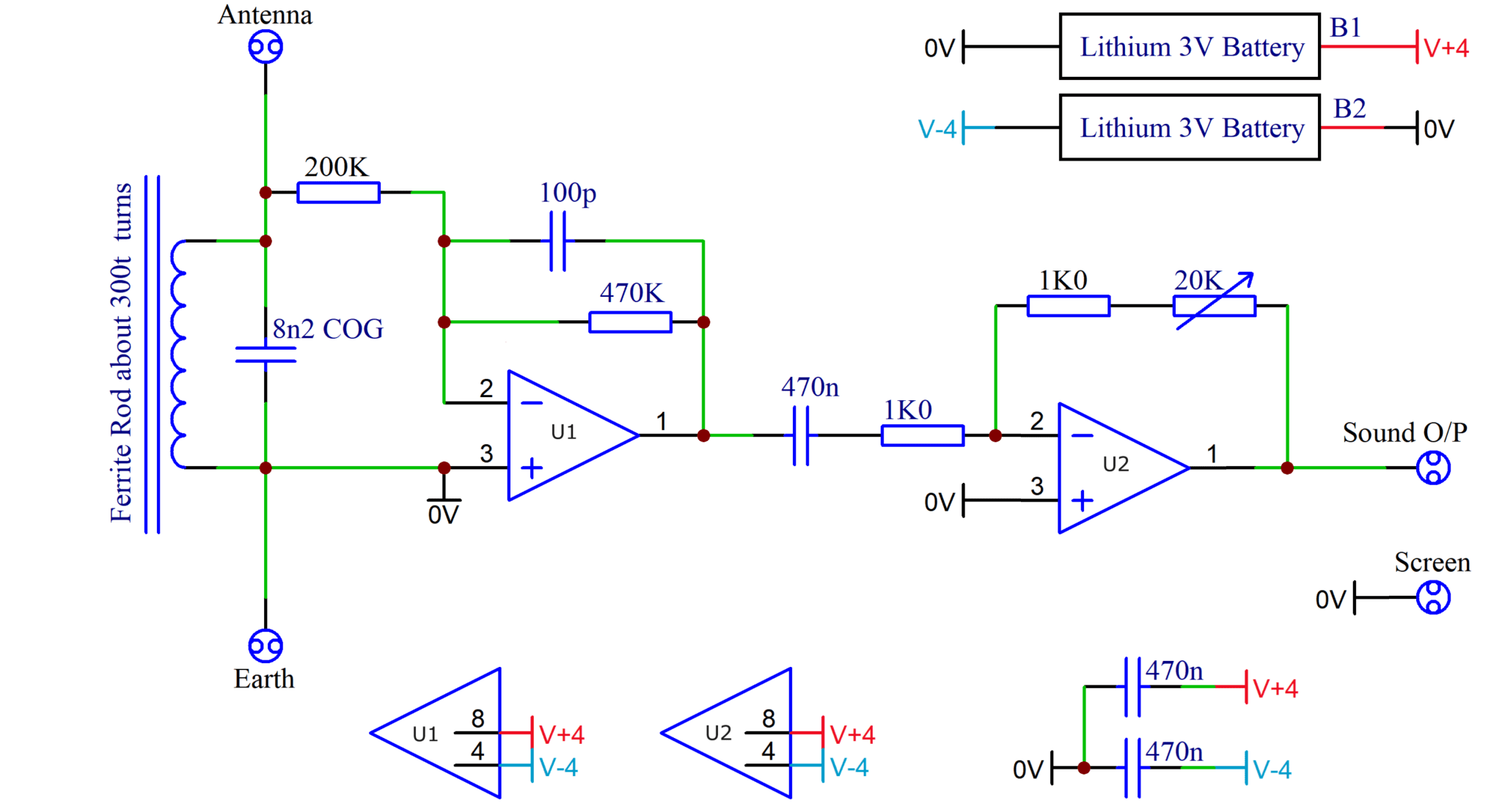

Proposed Tuned Sound Amplifier/Receiver for the VLF Christmas Eve transmission from SAQ, Grimeton, Sweden
The Ferrite Rod is wound to resonate with the 8n2 COG capacitor at 17.2 KHz, U1A provides an initial gain of x2 with an input resistance of 200K. U1B gives a variable gain from x1 to x21. Power is from two Lithium batteries. No on/off switch is shown but can be included. The Antenna and Earth (Ground Earth) connections are optional. Sound output and screen to be connected to Mobile Phone, Tab or Laptop PC by 3.5mm Jack Plug.

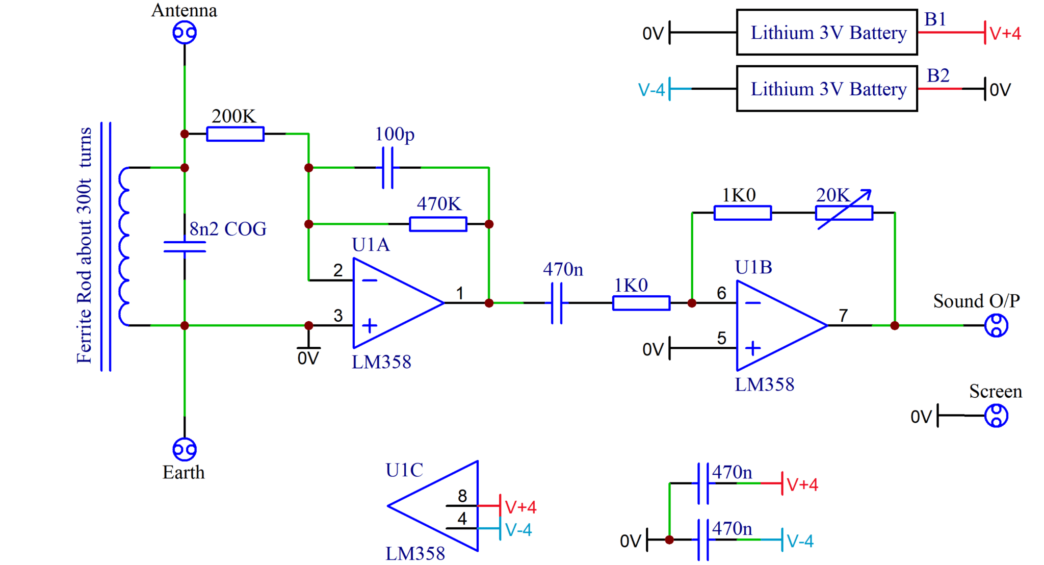

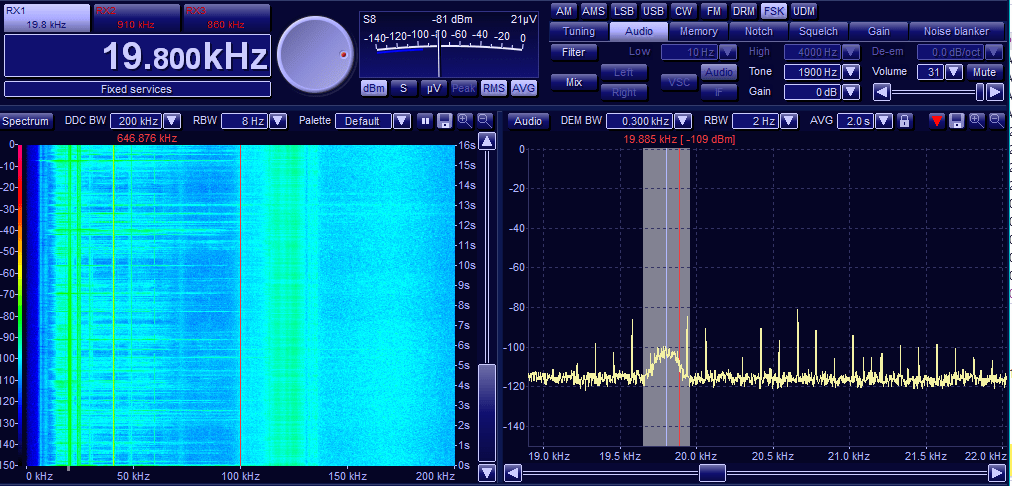

The nearest to SAQ station here is at 19.8 KHz, according to https://en.wikipedia.org/wiki/Very_low_frequency Australia. It's likely, coverage is global, so a good test station.
Low noise is pointless the signal to noise ratio of the received signal is very bad. Its affected by global lightning storms that never stop. Resonating and narrow bandpass filtering around 17200 Hz is my only way of removing noise.
The efficiency of a ferrite rod aerial at low frequencies is also very bad. In fact, as far as I know, the usual way to design a ferrite rod receiver with a decent sensitivity is:
1. Look up the atmospheric noise levels at the frequency of interest and calculate what efficiency the ferrite rod aerial needs to have to ensure that the received atmospheric noise is still a couple of times larger than its own thermal noise
2. Design the aerial to have that efficiency
3. Design the rest of the receiver to have an equivalent input noise of the order of the thermal noise of the aerial or less
If you did a calculation or experiment showing that your amplifier is good enough, just say so, instead of shouting RUBBISH and mentioning battery chargers.
Regarding crossover distortion, you will get it when in the negative peaks, an LM358 output has to draw more than 50 uA (could also be 12 uA due to exemplaric spread). I don't see how you can exclude that possibility. A resistor to the negative supply can fix it, if needed.
By the way, the simplest way I can think of to interface a ferrite rod to a computer would be to connect the ferrite rod and capacitor between gate and source of an N-channel JFET with an IDSS of about 0.5 mA, like those that are used in ordinary two-pin electret microphone capsules, and to connect drain and source to a microphone input with plug-in power. No idea if it is good enough to be usable, though.

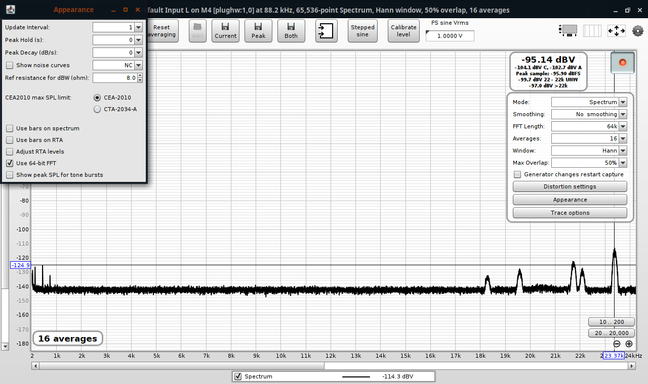

Got interested whether I could detect any VLF stations with a simple ferrite antenna. The attached plot shows some peaks that I attribute to Skelton, Cumbria/UK (22.1kHz), Antharn, Cumbria/UK (19.58kHz) and the biggest peak from Rhauderfehn, Germany. The ferrite core pointed north-south resulting in an east-west sensitivity maximum.

The noise floor in VLF is far-far above resistor thermal noise. You have both distant lightning and smps noise everywhere

The discussion as regards choice of OpAmp is rendered trivial simply by using single OpAmps rather than dual or quad and 8 pin DIL sockets, people can then fit what OpAmps they like within design constraints.

A major reason why I presented a complete receiver is the amount of EMI in the average urban household. With a mobile RX it's possible to find locations with low enough EMI for good reception and the sound can be recorded with a phone and later processed with a PC for morse decoding. BTW my loop antenna is located at ~40m from the house and on the SDR some of the EMI still is visible. I had to use a transformer to match the 75 coax to the 50 ohm SDR. SWR has to be as close to 1 as possible, as any deviation results in unwanted signal pickup. Ground is a nonissue here, any ground rod works just as a buried part of a dipole. Not exactly the usual textbook stuff.
