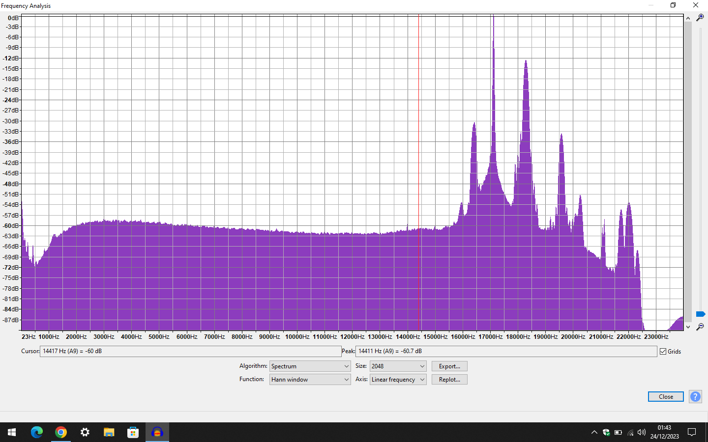

Quick test running first with test generator at 17200 Hz and then without test generator, the test generator peak is about 40dB stronger than others, what are these other peaks ? Are they VLF transmitters or local interference?
Most of the wide spectrum noise is picked up when I connect antenna wire and earth wire.
The frequencies of the other peaks are 16.42 KHz 18.22 KHz 19.56 KHz 20.27 KHz 21.68 KHz and 21.99 KHz.

The peaks correlate with UK, France, Norway, India, Italy. I will try without antenna wire and earth wire and move the ferrite around. Looks like I am picking up VLF stations so should be able to see a peak when SAQ transmits.

Keep in mind that the amplitude scale is logarithmic so even though the low frequency noise looks bad there is about 45 dB between noise and the strongest VLF peak.

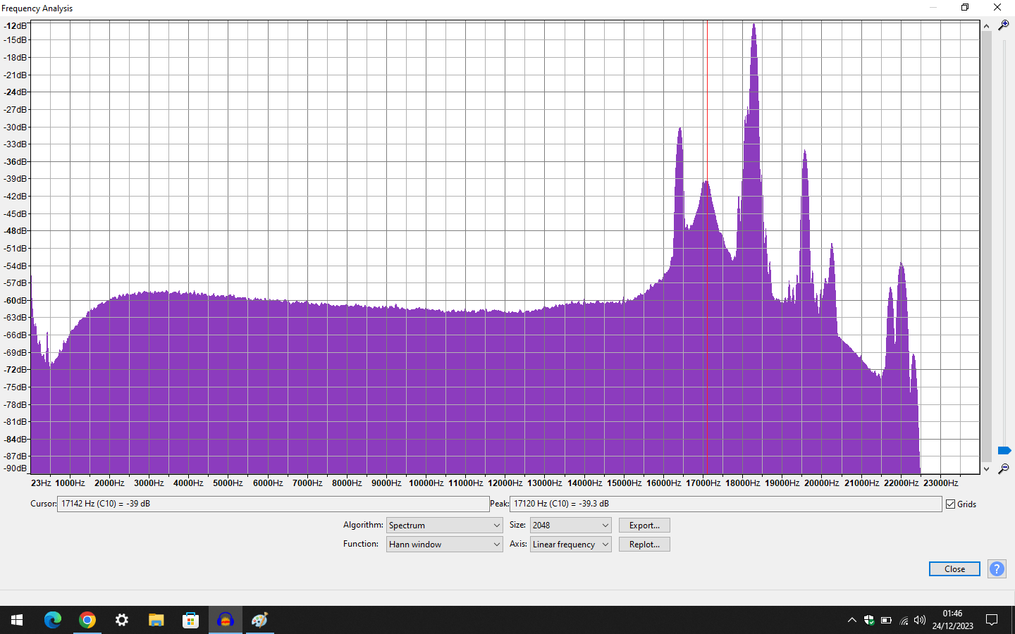

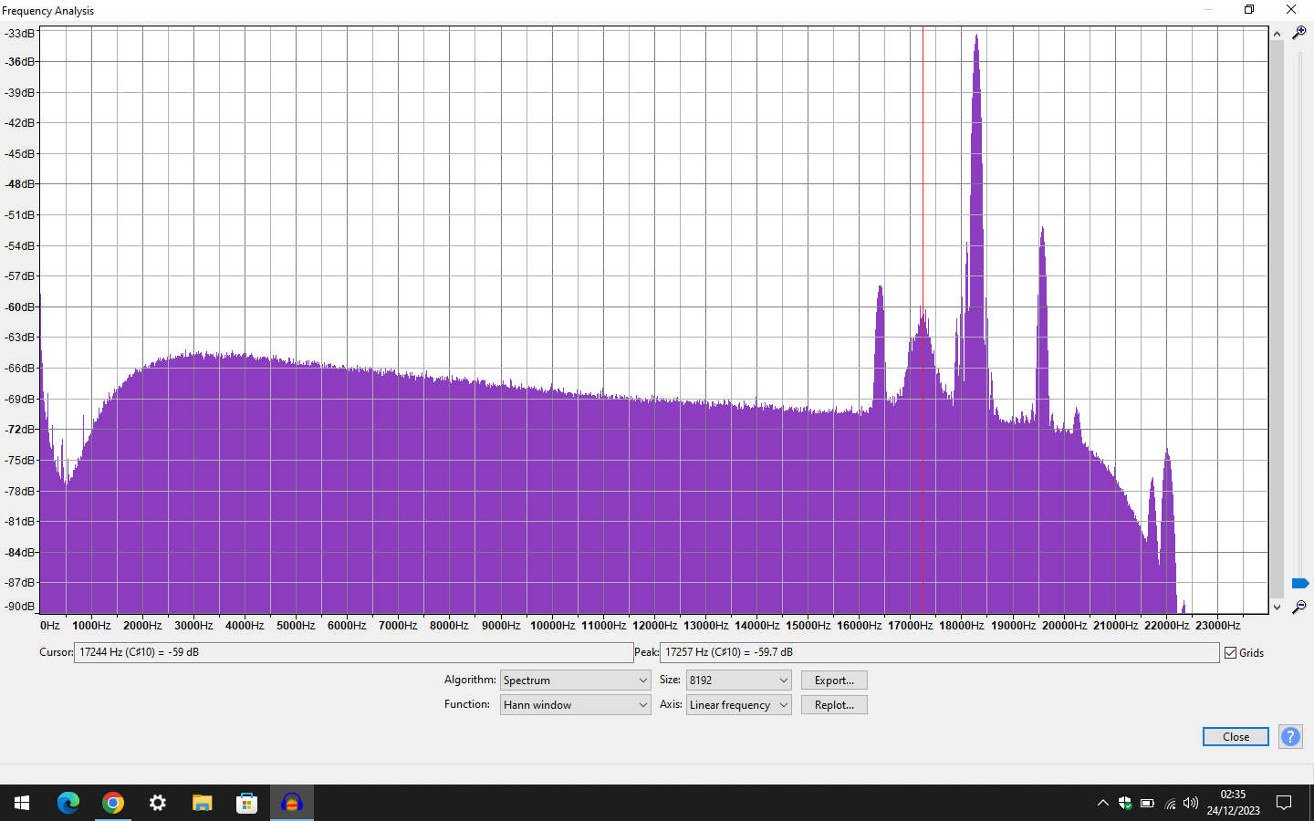

Yes I have done some tests and moving the ferrite does select peaks when no antenna or earth connected. However the signal is many dB stronger with Antenna and Earth connected.Peaks showing up on the ferrite alone could be nulled and if so, one side of the ferrite axis points in the direction of the station.
See examples first Ferrite Rod no Antenna no Earth the with Antenna and Earth.
It seems there are no peaks very close to SAQ frequency. The peaking that shows at 17200 Hz is the resonance of the Ferrite Rod so hopefully the SAQ pulse will be quite strong.

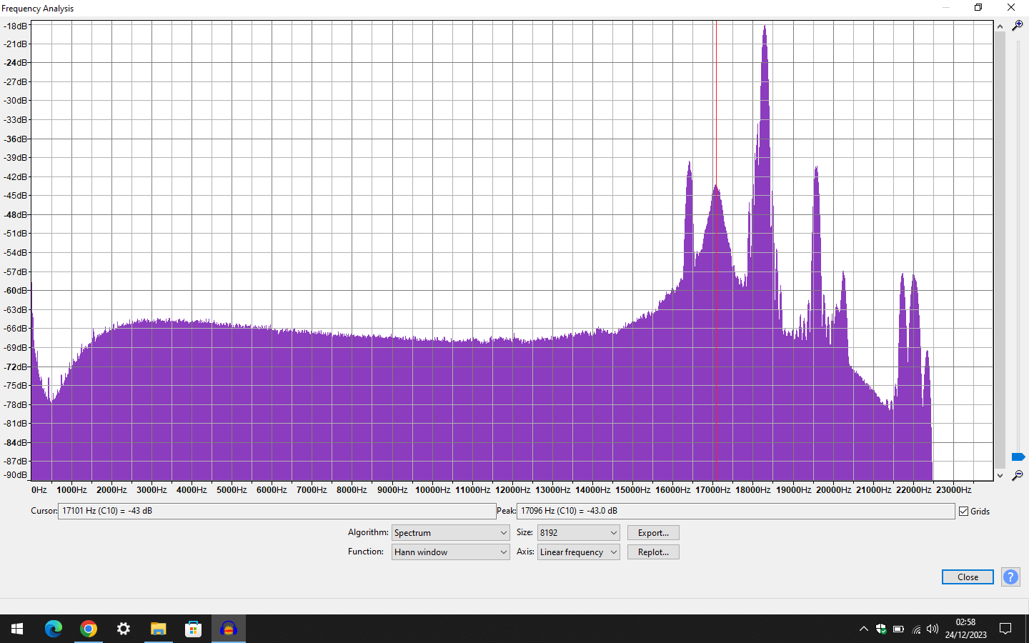

It looks like you were right about the amplifier noise being sufficiently low. Even without extra aerial, the spectral peak at 17.2 kHz is well above the noise floor. The distance to the surrounding peaks remains about constant with and without the extra aerial, so it must really be received atmospheric noise rather than thermal or amplifier current noise.
Upon reflection I would prefer to use a better OpAmp. The 300K input resistor and the OpAmp I used contribute to noise. A better JFET type OpAmp as a non inverting amp with low gain would feel better. It would also be better to have more analogue bandpass filtering. The antenna I have is not big enough (high enough) really to do a good job.It looks like you were right about the amplifier noise being sufficiently low.
TI do slate the LM358 now, probably because they have released an upgraded part, they have published a really detailed critique of the LM358! I often use the Analog Devices AD820, its a good general purpose FET amp with good noise figure and open loop gain of 40dB at 20 KHz.
