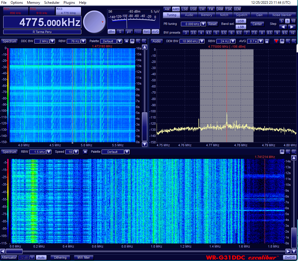

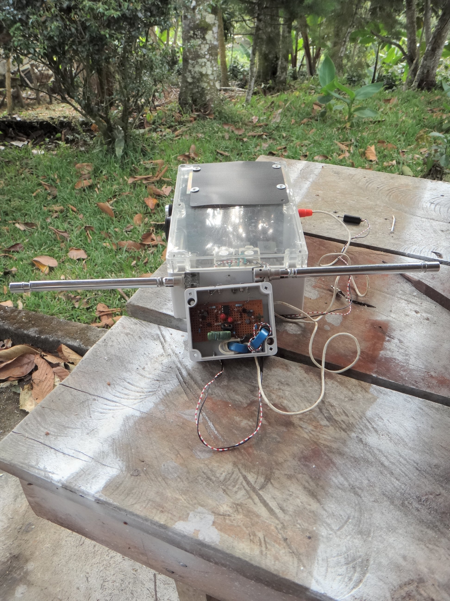

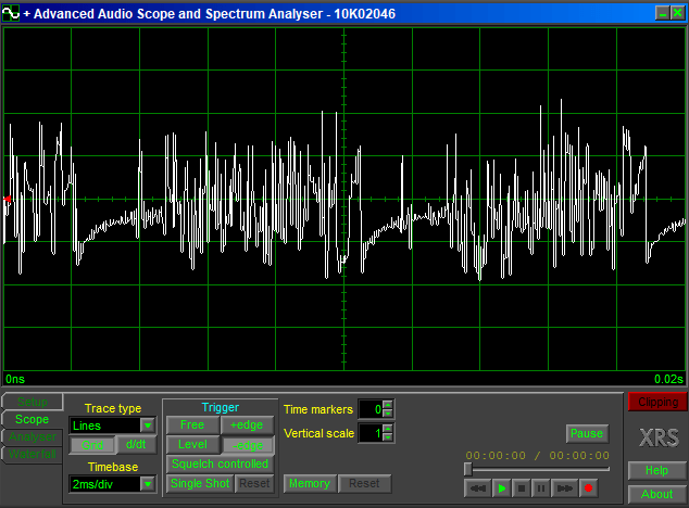

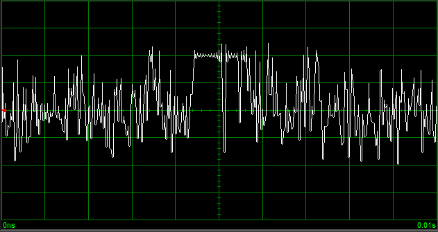

Because the power company in Panama regularly produces more RF energy (mostly at VLF) than all Panamanian MW stations combined, if I want to receive SAQ there's no alternative but to design an improved receiver. The horizontal lines on the pic (lowest spectrum waterfall), courtesy the power company. It suggest there's not only an AM but also an FM component. As the SDR has a set of tools available, the scope gives the (expected) display.

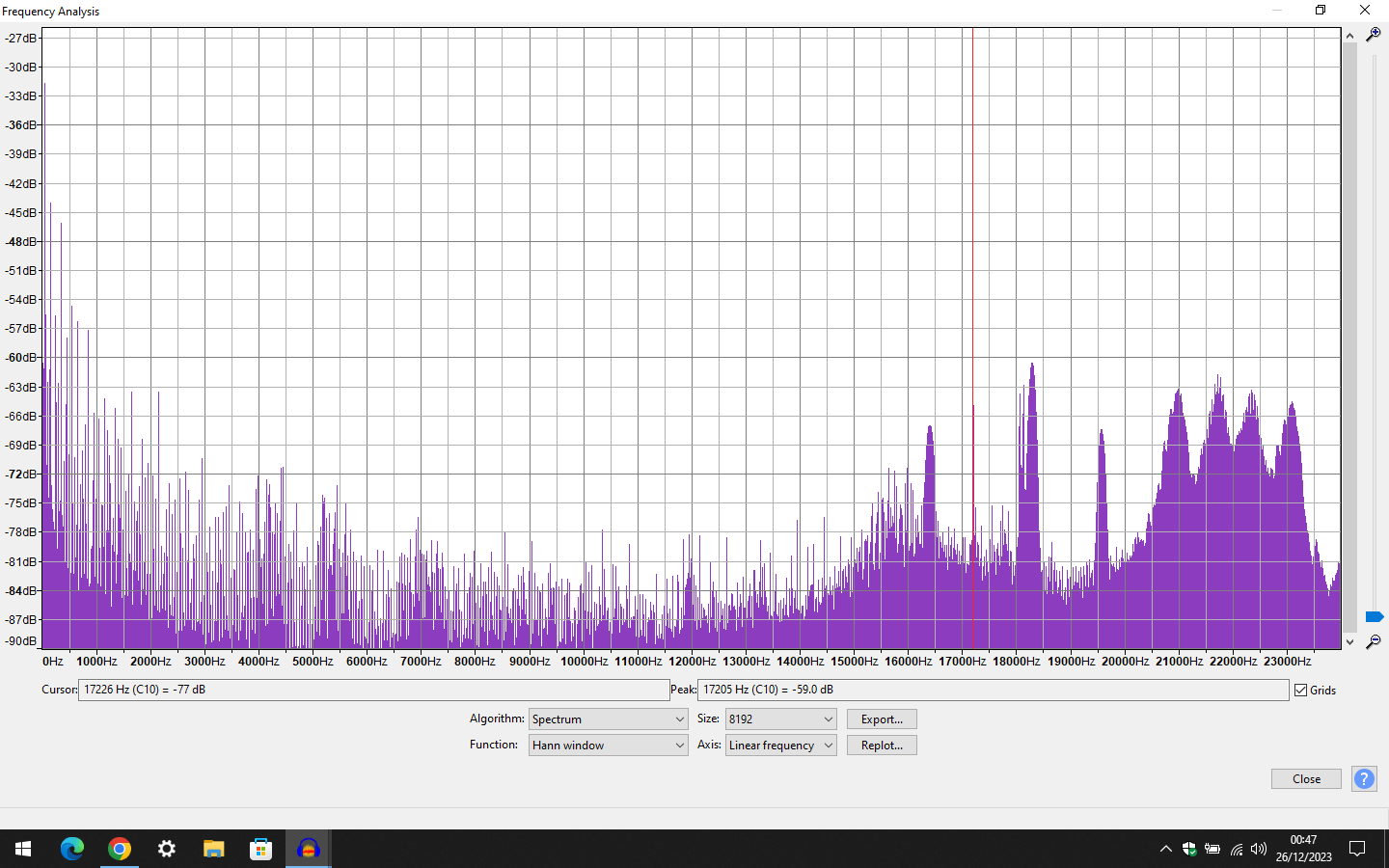

I downloaded your file telegram-17200.wav and had a look at the spectrum and yes there is more local noise. There is a lot of 50 Hz from the mains and a lot of power supply interference. The 50 Hz is probably an "audio earth loop" or a disconnected cable screen. The power supply noise is probably mostly from your Laptop or something else close nearby. I used a long audio cable between my Laptop and the receiver, also running all on battery.
Then I tried to process your file in Audacity - it took more notch filtering than my recording. I am attaching the audio file I made from your telegram-17200.wav recording.
Your recording is better because there is no "storm lightning" noise.
I also plotted the spectrum from your telegram-17200.wav file, the SAQ peak is about -60dB whereas I was getting -18dB, I think because I was using an outside antenna and a receiver resonant to 17.2 kHz.
Very interesting, the spectrum you have looks much more linear:-

I have seen this kind of waveform here locally. Its not in the line voltage waveform, rather its in the line current waveform. I associate it with line current, with older type solar panel grid tied inverters (they feed current pulses into the grid) and with other things such as thyristor dimmers and motor speed controllers.
Are you certain that your antenna is actually receiving this noise by way of EM waves from a distance? Rather than something that's getting in with your equipment power supplies, earth loops, local magnetic fields from wiring/other nearby equipment.
Are you sure that equipment and antenna and earth are all well away from mains wiring, solar panel inverters etc. Are you sharing an earth connection or have you got a completely separate earth for your receiver. Lighting especially fluorescent tubes can radiate a lot of interference also.
If not already done, I would be thinking about running a test out in the garden with power coming from a small generator (or inverter running off car battery) some distance away from anything remotely like mains wiring solar panel installation, substation transformer, power cables, or other equipment.

The power company also is using solar panels, but apart from that, this EMI totally disappears when a serious power cut happens, concerning the region. Long before that I designed and built active wideband dipole antennas plus a MW radio, most useful to locate direction and source of the EMI. The active dipole was designed to cover VHF as well but because the MW RX solved the cause to the extent that the power company had to insert filters twice, due to complaints filed at the govt. dept. in control of telecommunications, no portable VHF radio was designed. Now it doesn't violate the law because that only concerns reception of all Panamanian broadcasting stations. Ham radio operators can file complaints as well so above ~550 KHz the spectrum is useful.I have seen this kind of waveform here locally. Its not in the line voltage waveform, rather its in the line current waveform. I associate it with line current, with older type solar panel grid tied inverters (they feed current pulses into the grid) and with other things such as thyristor dimmers and motor speed controllers.

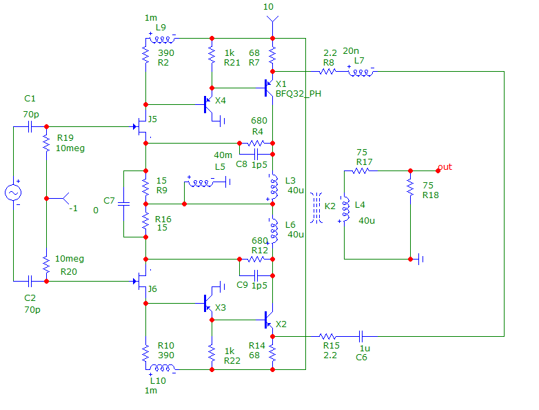

Amp in plastic box, in sim:
For positive voltage peaks, J5's or J6's gate-source junction would go in forward conduction, for negative voltage peaks in avalanche breakthrough. PN junctions can usually handle far less current in avalanche breakthrough than in forward conduction, so two extra diodes with their anodes to the sources (if the source DC bias voltage is low enough) or to ground and their cathodes to the inputs should make the circuit less vulnerable. Of course when the peaks are big enough, they will still damage things.
That's a nice design of receiver. I'm yet to be convinced that the symmetrical balance is needed but it looks like a good idea.
That design wasn't intended for VLF, which might become clear when considering the impedance of the trifilar wound RF OT (L3, L4, L6). As mentioned it was intended for ~500k to 120 MHz in order to discover the sourced of the EMI. When noticing the EMI issue could be tackled with MW only, I exchanged the amp with one, using far less supply current. One stage with single gate mosfets was enough. The active dipole also led to the discovery that in this mountainous region, MW stations haven EM field with horizontally polarized component.

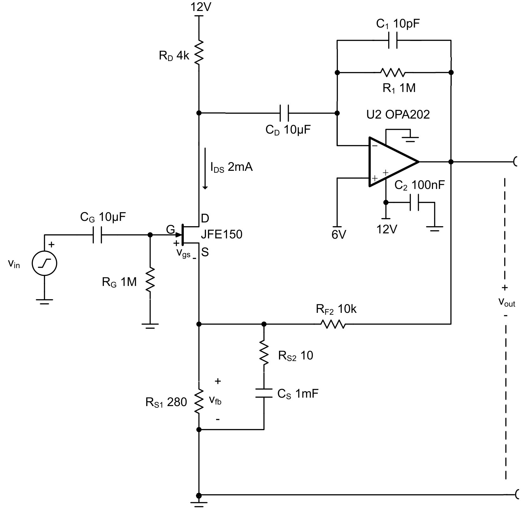

Had a look for low noise JFET's intended for condenser microphones. How about 2SK596S JFET? I also found this TI JFET device the JFE150 very low noise - interesting. TI have some application notes and they give this circuit (take no notice of the crazy capacitor values) :-By the way, the simplest way I can think of to interface a ferrite rod to a computer would be to connect the ferrite rod and capacitor between gate and source of an N-channel JFET with an IDSS of about 0.5 mA, like those that are used in ordinary two-pin electret microphone capsules
