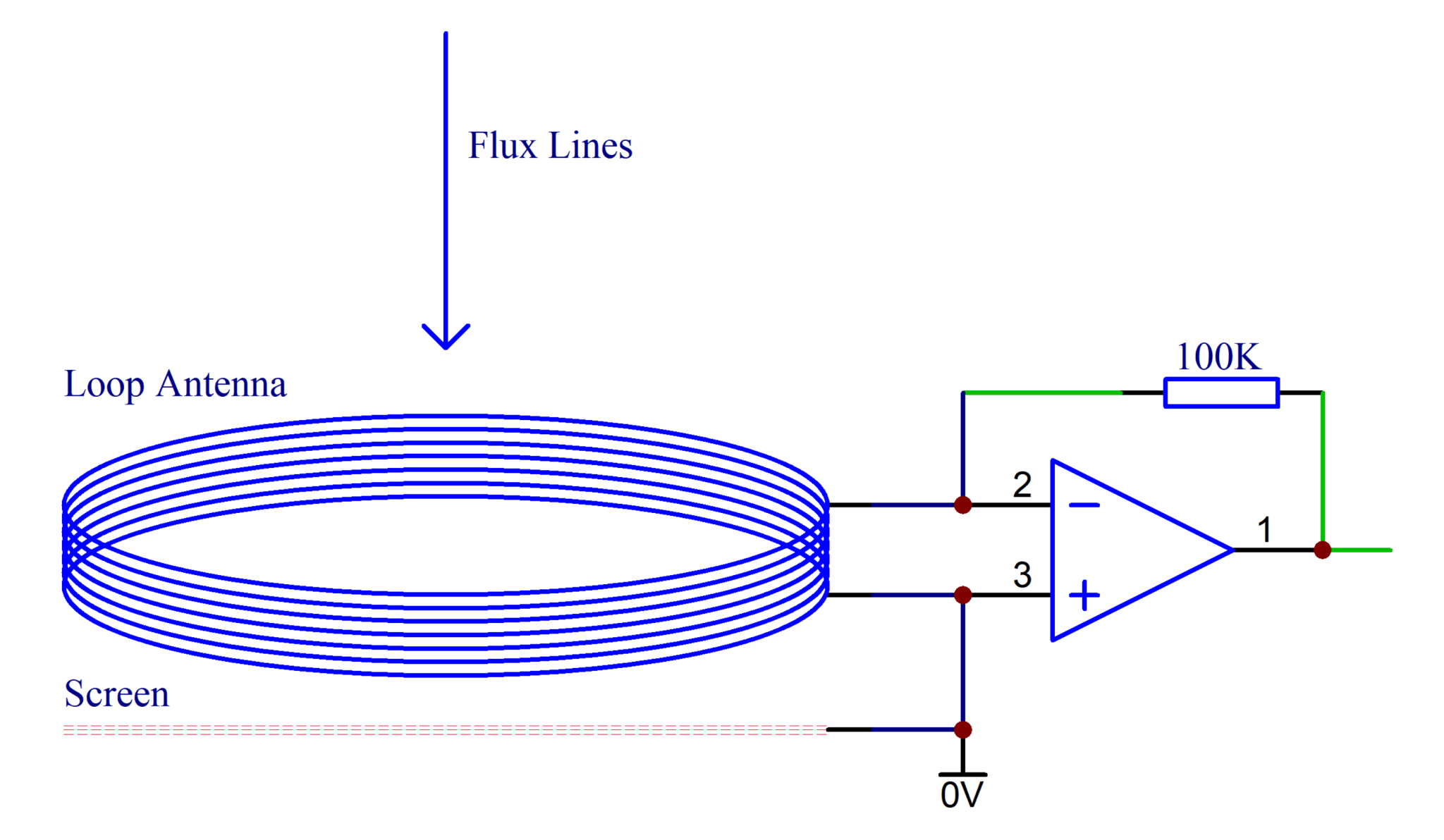

That is very interesting. It's making me think about the antenna (especially for VLF) as a transformer. Suggesting that the H-Field magnetic flux lines intersecting the wire loop are inducing current into the loop according to Faraday's law.

Well its far-field, not near-field, so the mutual inductance is vanishingly small - not really a transformer by most definitions. Better to go straight to Maxwell's equations for antenna's perhaps?That is very interesting. It's making me think about the antenna (especially for VLF) as a transformer.
Surely a Loop or Ferrite Rod antenna can only be reacting to the magnetic field component of the EM wave, and the magnetic component must create magnetic flux that couples into the Loop or Ferrite Rod antenna.Well its far-field, not near-field, so the mutual inductance is vanishingly small - not really a transformer by most definitions.
I was not suggesting that the antenna was coupling with lines of flux from the transmitter near field.
Well the flow of energy into an antenna is complex, I'd be wary of making such a simplifying assumption without backing it up with a simulation. Half the power is in the E-field and half in the B-field, and you can't have propagation of energy without both fields being present, so the E-field has to be involved too.

@jhstewart9 mentioned that "The H-Field loop was enclosed in an Aluminium E-Field screening tube with the tube broken at the end so that the H-Field was not shorted"
That seems to me to be a situation where the antenna has no mechanism for transferring any or the E-Field energy into an electrical input to the receiver.
My understanding was that energy in an EM wave was constantly being transferred from E to H and back rather than 50:50 you are suggesting.
I suppose what I'm saying (without having gone back to the maths) is that for low frequency EM wave propagation - detection of the magnetic component by a coil is more straightforward than for HF or VHF and above and works according to Faraday's law.
We know that the practical design of a loop antenna or Ferrite Rod antenna works just like a coil in a transformer, larger the loop diameter or more wire turns larger the signal, same for the Ferrite Rod.

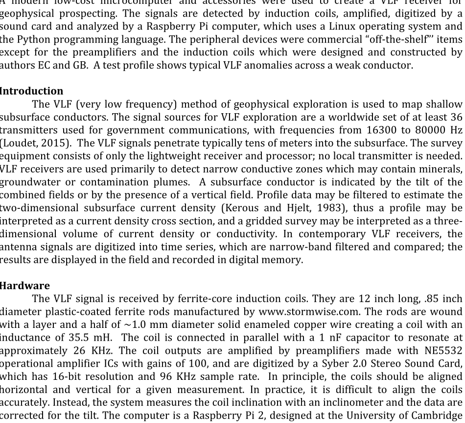

I landed upon this geophysical project using VLF signals to detect things many meters underground.
If interested, visit https://github.com/ecabuk/vlf and click ExtendedAbstract.pdf. It uses two 12 inch ferrites and NE5532 preamp.
That's interesting. Twelve inch Ferrite Rods that's a good size, the NE5532 has been around a long time but is a reasonable choice (we have been discussing JFET OAmps). They don't show a circuit diagram but I guess they would have had a lot of input noise masking the VLF. I like the sound card with 192 kiloSamples/sec sampling.

The pdf and the website are both useful interesting links. The "loop antenna" (with ferrite core) is the same as the frame antenna (but without ferrite core) at VLF except that the ferrite concentrates the magnetic field component. I think ferrite cores/rods still work well above 100kHz and will easily cover the MW band.Already in 1990 a tunable VLF ferrite loop antenna wad published, and also mentions that at VLF the VLF loop outperforms an open frame loop up to 100 KHz.
