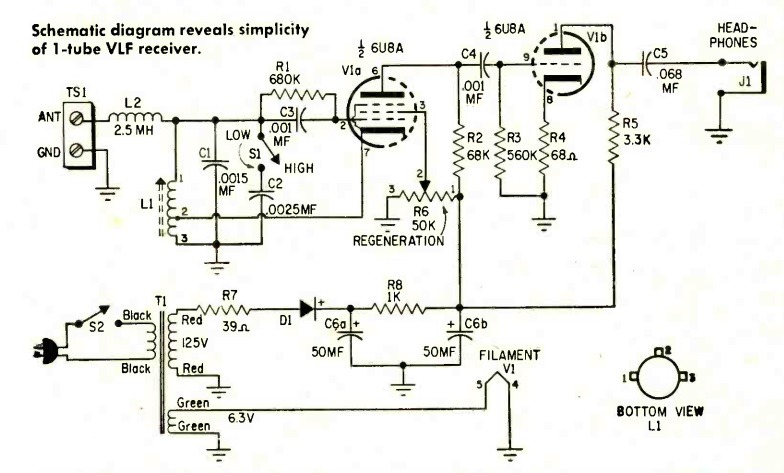

I was able to buy a slug-tuned horizontal coil on Ebay. That was probably at least 10-15 years ago, when TVs still used CRTs. One of these days I'll find the schematic of the receiver that used that sort of coil. I do remember that it was a super-regenerative circuit that used a 6U8.
That one tube VLF receiver (or sound preamplifier) from 1970 is very interesting. Thank you for finding the schematic.Found the schematic

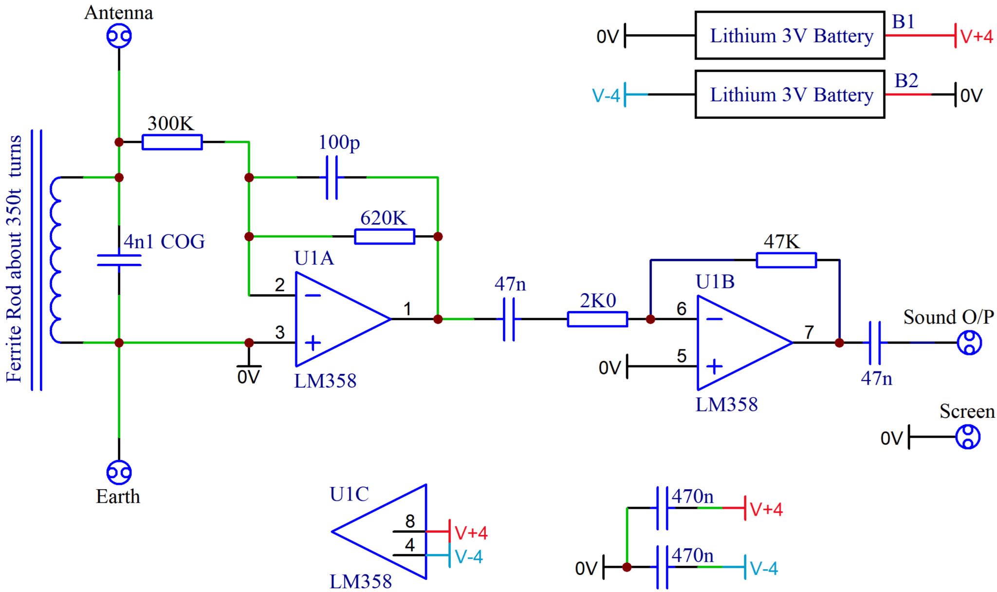

I compare it to our simple OpAmp version as follows:-
Seems that C1 and C2 in parallel for the one tube low band is 4nF same as our 4.1nF resonant capacitor. My knowledge of tubes is very basic but I think it is connected as an inverter, as the grid goes negative it draws less Anode current so Anode voltage goes up. I think the regeneration is negative feedback (or the lack of it) so the first pentode has high voltage gain.
From what you say the slug core in L1 was adjusted to change frequency. L1 must have a lot of turns (the slug core would be a lot smaller than a ferrite rod) typically it could be over 500 turns.
I'm not sure why C3 is there as it likely reduces Q of the resonant circuit, maybe they didn't want any Q? Presumably L2 is there to reduce input from higher frequency bands.
Don't see how the circuit would render the Morse code audible (unless the regeneration did that).
Just goes to show what a tube can do. In the UK the 6U8 (or 6U8A) was an ECF82, often used in TV sets I think first introduced in 1954.

Ah maybe not, well not without modifying it somewhat. I'm not too up on valves but I think the regeneration causes oscillation and to render Morse code audible the oscillation is different from the CW frequency so the resonant circuit is always detuned slightly from the CW frequency.Would be interesting to build this radio for the next SAQ transmission
I'm not too sure about how the pentode is biased but I think Anode current flows through part of L1 so as to bias the Cathode slightly positive of the Grid. Not sure what happens to the small AC component therefore on the Grid. In any event L1 has a DC current flowing through one of it's windings, not a great idea (why not use a low value Cathode resistor for bias). There is no additional high pass filtering.
Can't say I'm a fan of these "clever" but often difficult to understand circuits, think that simplicity is preferable.
To build this I would modify the circuit, remove the regeneration and configure it more like an audio preamp with a fixed gain. Most likely for SAQ replace L1 with the Ferrite Rod. So define the Q, define the Gain, define the filtering and make the output suitable for Laptop PC recording.
Not a fan of the "two in one" valves I would go with two simpler triode valves (tubes) instead of the ECF82 (6U8A) designed specifically for TV sets of the day.
Or being completely honest, think I would use only one triode valve as a front end feeding into an OpAmp for more gain.
Not such a bad idea to have DC current flowing in the tuning inductor, as it is a slug-tuned inductor with a big, big effective air gap...

True not going to saturate the inductor but why do it? A Cathode resistor is simple, accurate and easy to understand. Why mess around with what is your tuned circuit that you rely on to resonate at the right frequency with the Q you want.Not such a bad idea to have DC current flowing in the tuning inductor, as it is a slug-tuned inductor with a big, big effective air gap.
I'm just trying to understand the circuit.

You are obviously not understanding it, as it works the way it's drawn. A few ma into the inductor is no big deal.

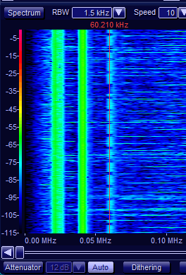

WWVB is so strong here in Panama that despite the power company's EMI the signal is visible on the 1.5k BW of the main waterfall spectrum.
Yes quite likely I'm not understanding exactly how it's intended to work - but in a way that's the point. Those kinds of articles were intended for people to build at home and many people who actually build same are kids so it's a good idea to make circuit function clear. Other than my maybe negative comments I think it's a good project.rich -
As for my comment as regards using the resonant circuit at the front end to provide tube Cathode bias well true it's not going to saturate the inductor but why do it? A Cathode resistor is simple, accurate, easy and well defined.
I can go further as regards L1, the use of an inductor with such a small core is a bad idea because of increased turns and therefore reduced Q. Even a Ferrite Rod can be improved upon by using a Ferrite core without any air gap because of less turns and higher Q
