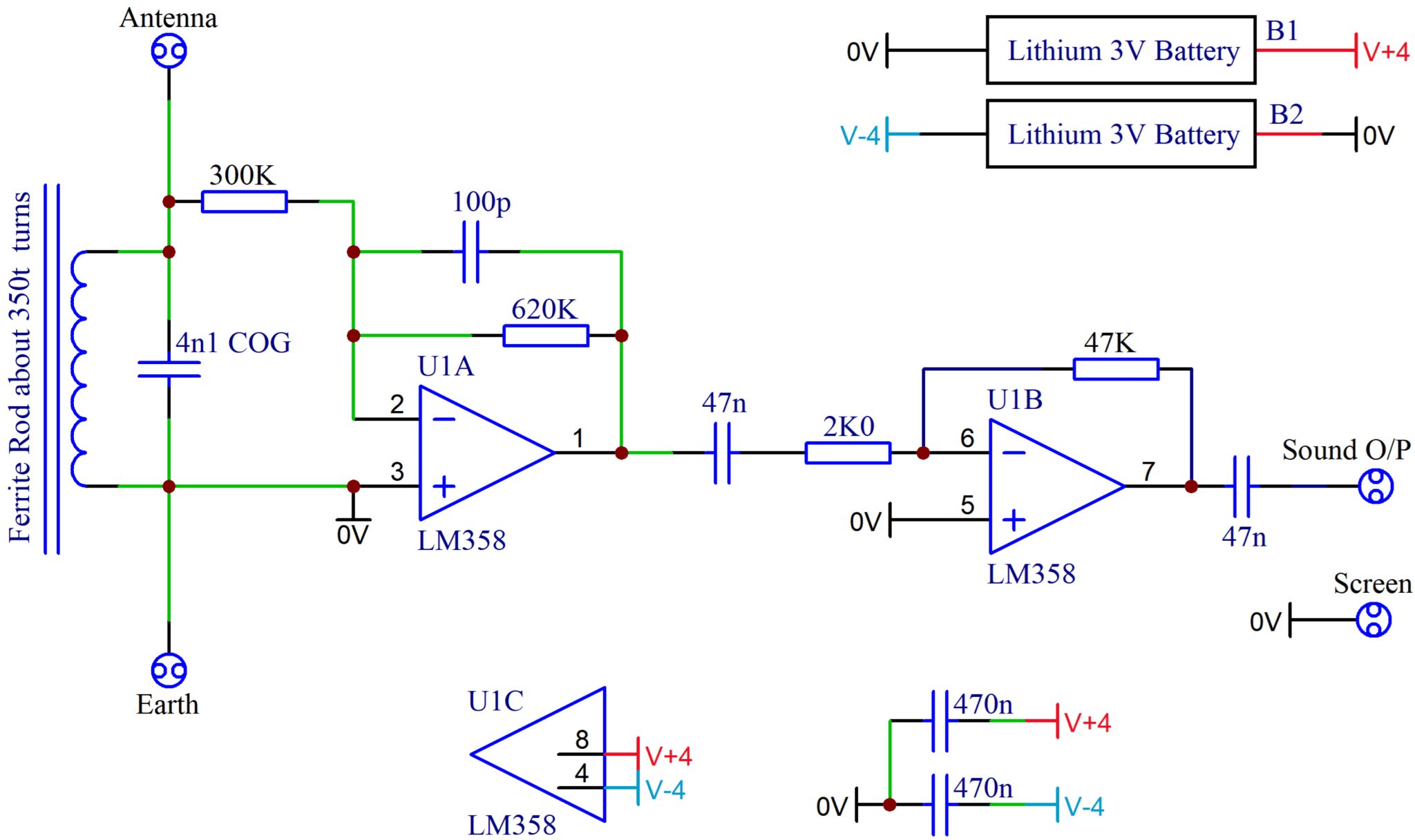

The SAQ receiver design will work for 60kHz.May I ask what kind of antenna you have for that. I am in Toronto and have a small 10cm ferrite core. Can I make a useful antenna with that. For example, to receive a CW time signal for test purposes.

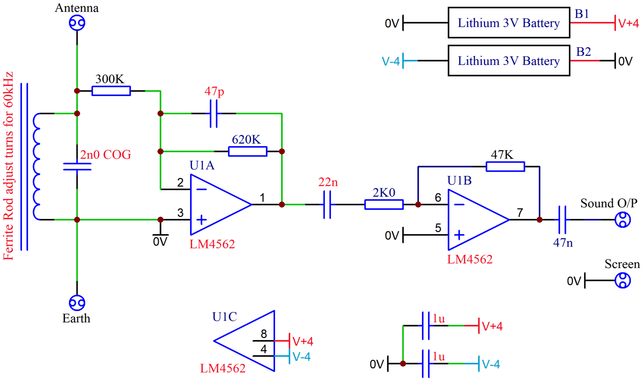

Just wind about 300 turns for the Ferrite Rod and alter the value of the 4n1 COG capacitor making it smaller so that the circuit resonates at 60 kHz, something like a 1n5 capacitor should be close. You will need a scope or something that can digitise at 192 k samples per second to see the signal.
Make the 100p U1A feedback capacitor 47p and swop the LM358 for a faster dual OpAmp.

Here is an updated version of the SAQ receiver design intended for 60kHz. As mentioned the number of turns of wire wound on the Ferrite Rod would need to be adjusted to get resonance at 60kHz.
This is a starting point. I'm sure that this design can be improved upon and will most likely need more bandpass filtering. Without antenna and earth connection the ferrite will be directional.

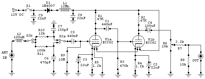

I stand a bit corrected, tubes still linger -- http://www.vlf.it/accardo/vlf_Tube_eng.htmlNot promoting the use of tubes (valves) just wish to preserve knowledge of that technology. Tubes have safety problems associated with the need for high voltage power supplies. That said electron tubes have very low capacitance and when correctly designed they could be used at very high frequency stretching as far as 4GHz.

We all do sometime or other! Yes interesting design! The first triode has very similar configuration to SAQ Valve Receiver above.I stand a bit corrected, tubes still linger
That said, and after some more evaluation, I think there are far too many capacitors and their values don't make much sense, the front end of that circuit between the antenna socket and V1a is especially weird. I'm not a fan of dual valves either, they were developed because of commercial pressures during the valve TV set era.Yes interesting design! The first triode has very similar configuration to SAQ Valve Receiver above.

I took another look at this 2003 project. The designers admit they are using obsolete technology but they believe it is still useful. The schematic and circuit assembly look messy at first but it is a sensible project and looks good when finished. The gain is lower than an equivalent opamp circuit but they claim low noise. And it is portable with a 12v battery.We all do sometime or other! Yes interesting design! The first triode has very similar configuration to SAQ Valve Receiver above.

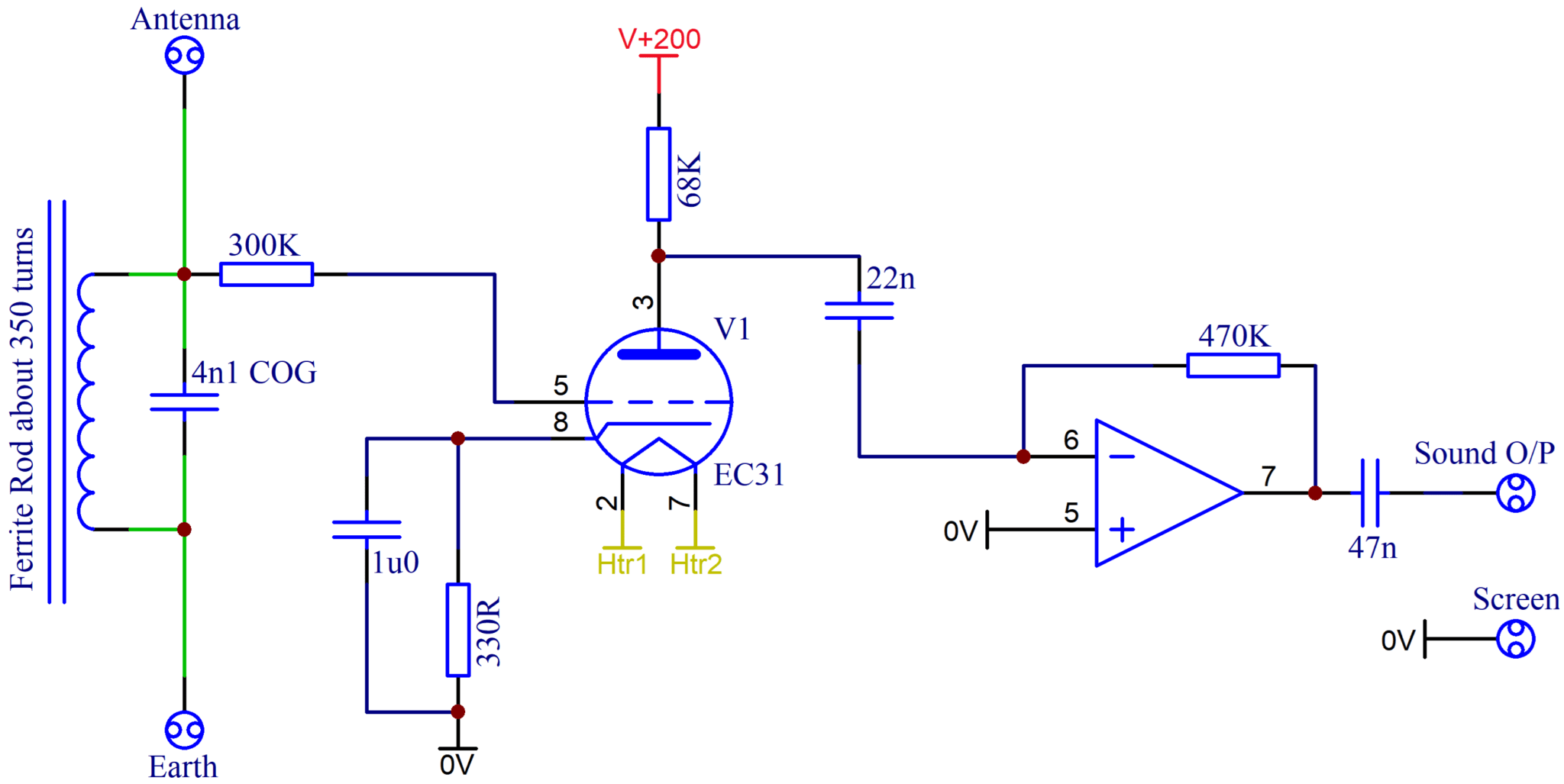

You might need a clipper to protect pin 6 of the opamp.@fubar3
Here is a preliminary design for a SAQ receiver with a Triode Valve at the front end. Completely untested at present. Notice the potentially hazardous 200 VDC power rail.

Yes, I should not be critical of other people's designs.The schematic and circuit assembly look messy at first but it is a sensible project and looks good when finished.
I don't think so because with a HT of 200 volt the maximum current that can flow through the 68K Anode resistor is 200/68000 which is 2.94mA. Any OpAmp won't be worried about 2.94mA pulling pin 6 up. However if the Triode suddenly started conducting a heavy current the 22n capacitor could pull a current out of pin 6 but again I don't think the Triode can pull much current (especially before it has warmed up). Also the 300K Grid resistor cannot push much current into the Grid to make it positive of the Cathode (needed to make the Triode conduct a "heavy" current). Something I would test if I built the circuit.You might need a clipper to protect pin 6 of the opamp.
