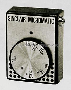

I built one of the Sinclair Micromatic radios very early on. They were advertised as the smallest radio in the world!

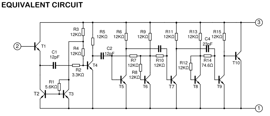

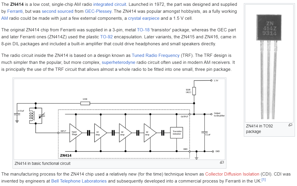

As regards regenerative circuits this little zinger the ZN414 would in its day likely be the pinnacle of regenerative possibilities:-
Only snag is that it won't work at VLF frequencies.
There are some modern clones still available, TA7642, MK484, and a couple of others. I know from personal experience TA7642 works fine at 455 KHz, better than one would expect actually. I don't recall the TA7642 spec sheet giving a low frequency limit.
MK484 is supposed to be better than TA7642, and from what I've read, none of the clones are as good as the original ZN414. The clones are still very popular with people who like to build minimalist receivers.
Win W5JAG
Don't think any of them are going to work for VLF - just have a look at the schematic they give on the TA7642 datasheet, the problem is the inevitably very low value capacitors (on the IC) used to couple the several gain stages together.
The MK484 datasheet gives 150kHz as the minimum frequency.

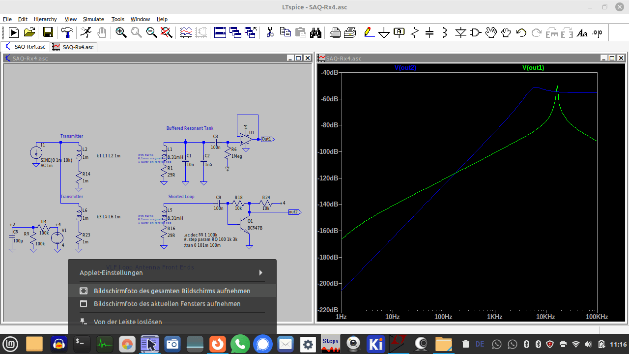

"The triode tube is a strange choice, any op-amp in non-inverting mode will work better"
Yes I agree with you - it was just interesting to try the design using a Triode, maybe a Pentode would be better.
"No, the losses of the coil, i.e. winding resistance, are the culprit"
When I was experimenting I tried 100K, 200K and 300K the Q did go up quite a bit from 100K to 300K.
It would also be interesting to forget about the Ferrite Rod and use a standard un-gapped Ferrite core, the number of turns to achieve resonance at 17200 Hz and with the 4n1 COG capacitor would be far less, giving a better Q. Reception would then rely on the antenna and earth connections.

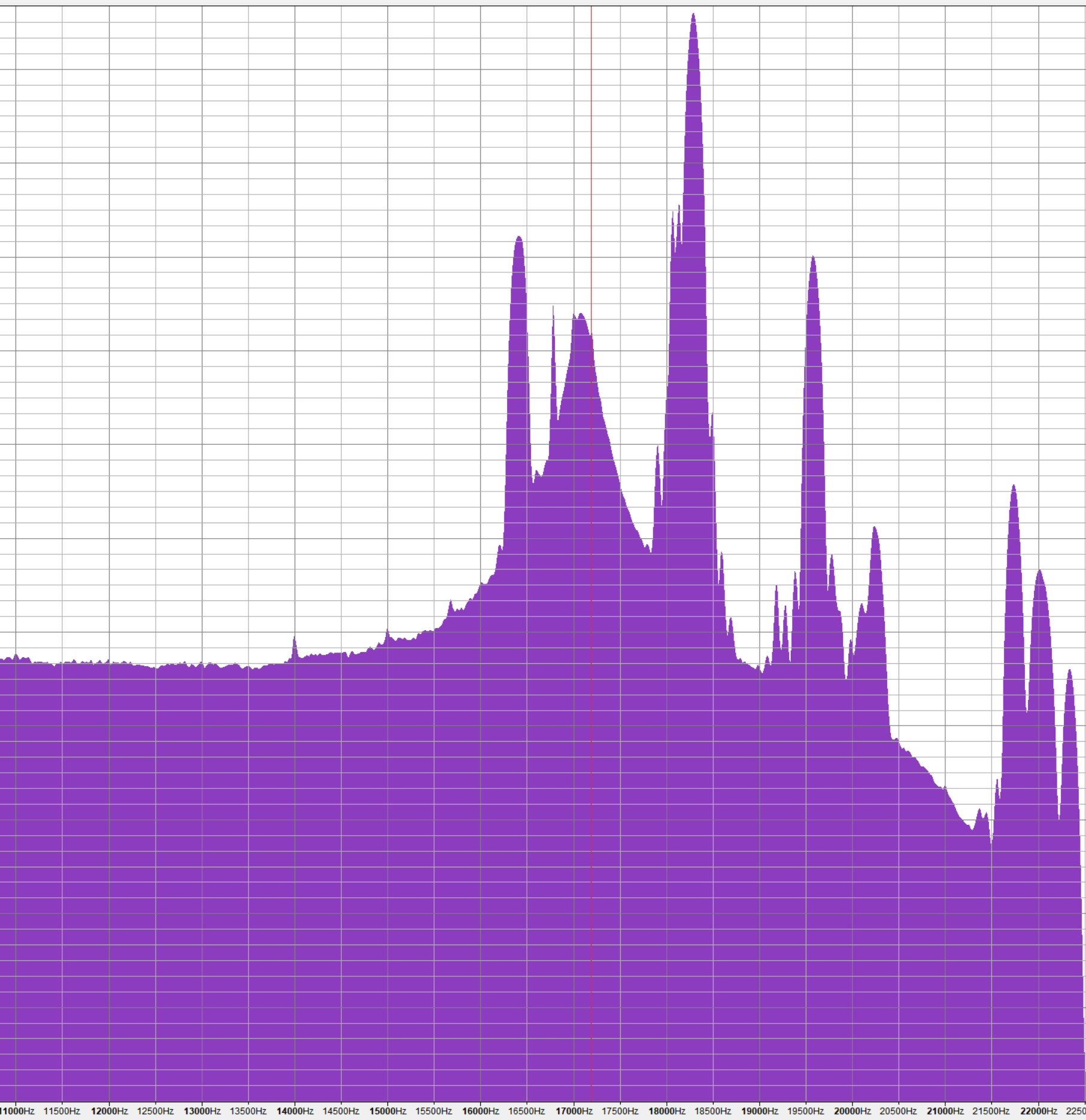

The simulation looks interesting - you can see that same peaking from the Audacity Frequency spectrum (as the resonant circuit boosts noise) taken when SAQ was not transmitting:-

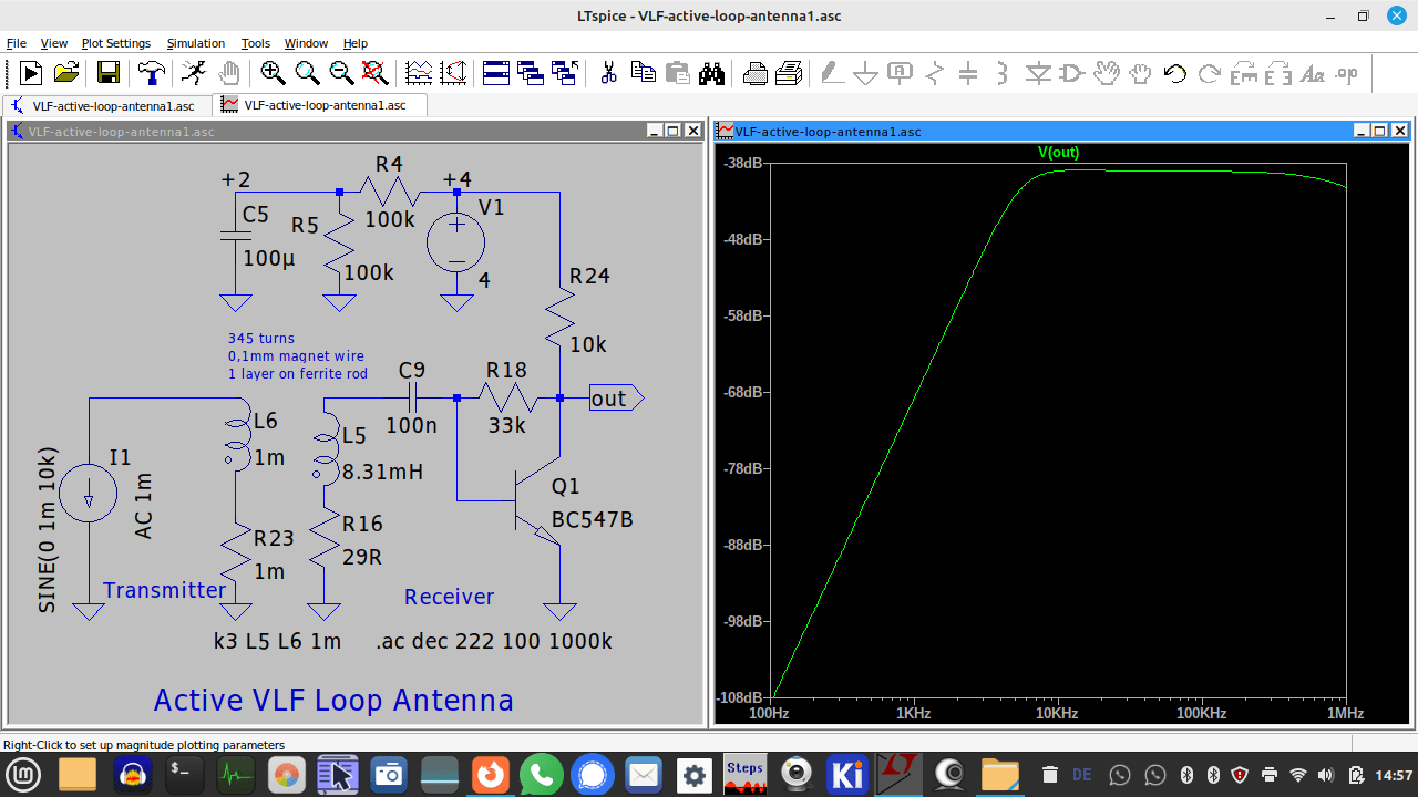

Meanwhile I extracted a very simple, aperiodic active loop antenna with constanst sensitivity in the range 10kHz~1MHz.

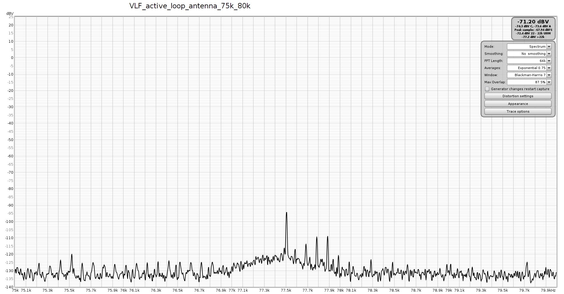

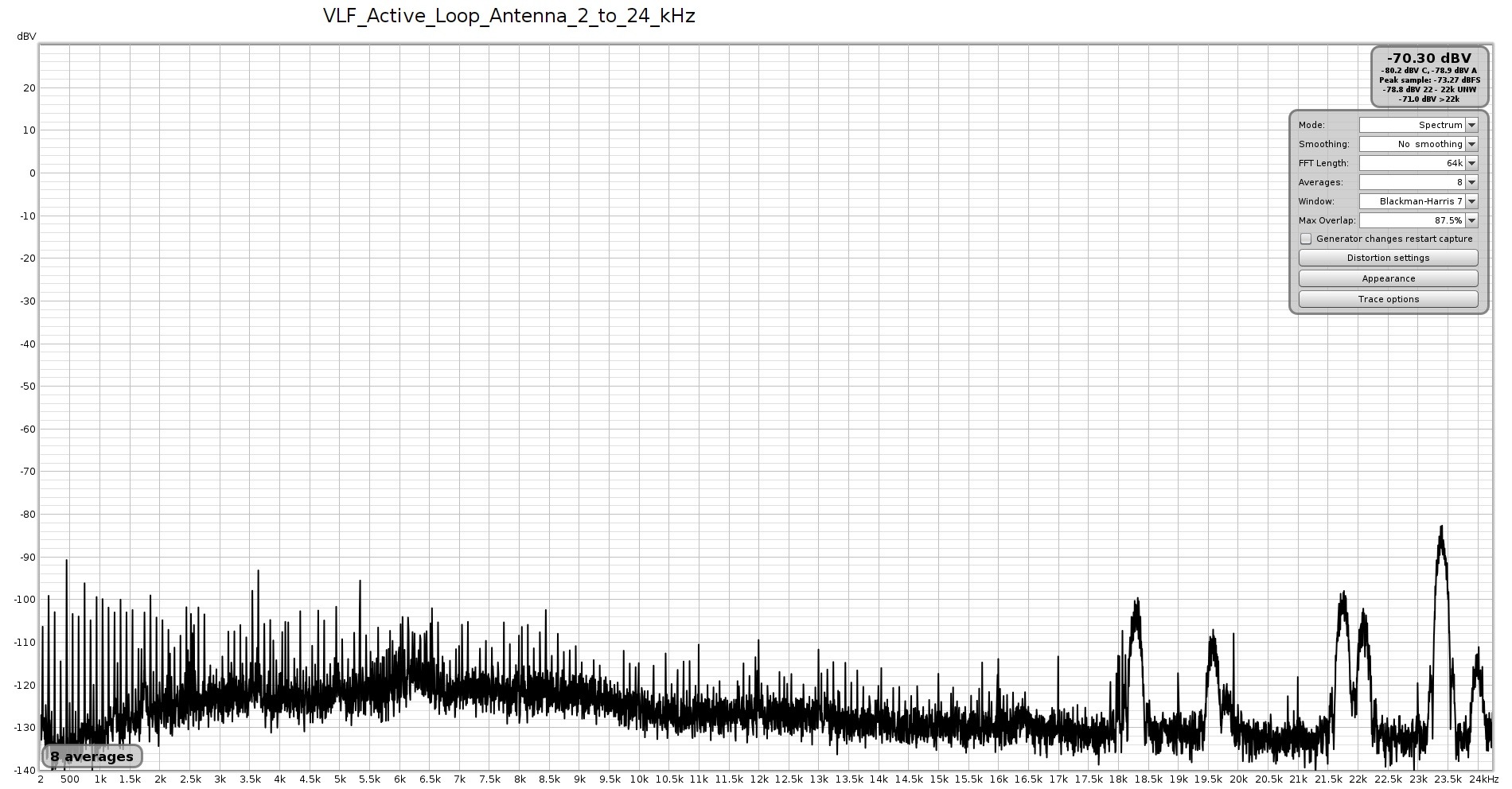

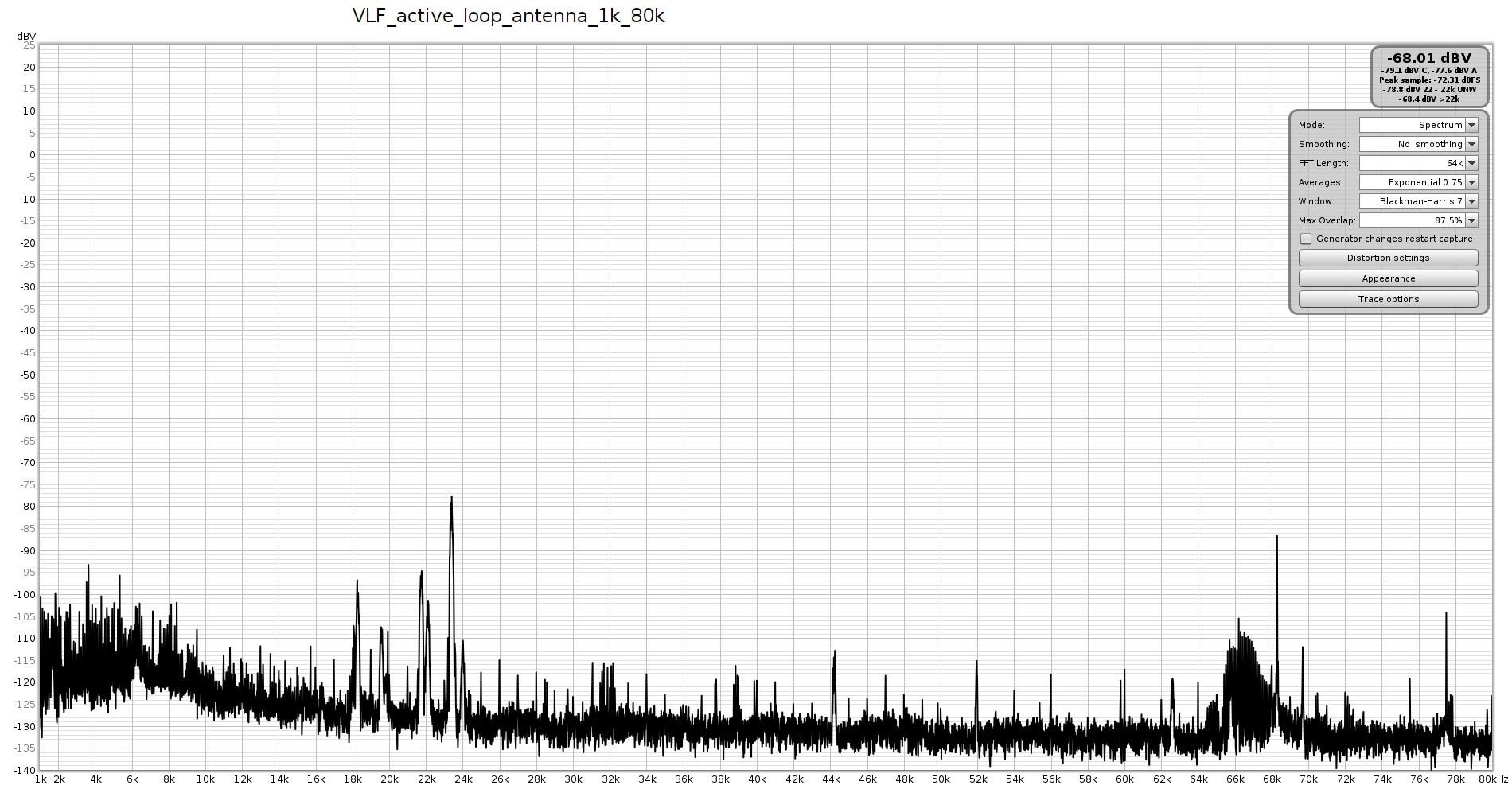

I build a quick and dirty setup. Ferrite coil, pre-amp feeding line-in of usb-soundcard Motu M4 with 192kHz sample rate. Connected to laptop with REW. And that's all. S/N is better than anything I tested before.

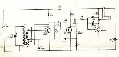

Explorer E202 - VLF Receiver for a beginner -- http://www.vlf.it/romero2/explorer-e202.html
This one is a portable receiver intended for a beginner but I think most people would find it an interesting read.
Radio signals of natural origin are a fascinating subject. The first time I read an article I was bewitched by it: Beyond well known TV and Radio emissions there are some "on air" natural radio signals that really make the sky bigger. But here appears a problem: how to hear them if there are no receivers to buy? And looking for a simple and effective project to build at home, the response on mailing lists is always the same: "There are many schematics on the Internet...., look there" And then you feel confused: which will work best? Can I use my PC? How can I assemble a system to find and process natural radio signals most effectively?
If you are looking for a small receiver, simple to build, which runs on batteries, which works with a small antenna, which works with headphones, which also provides a good signal for PC analysis... the Explorer E202 meets all these needs.
Since this project is meant for beginners there are also included in the article some basic concepts: they are also mentioned in other articles on the site so If you already know these things just jump to the next paragraph. -Romero-
The unit works with a 75cm field probe called a stylus. It needs to be hand held or earth grounded. It also can work with a long wire. I am wondering: can it be adapted to an indoor unit but there is no mention of a using a ferrite core.
The text says TL071 but the schematic says TL081 which gives it a high-impedance FET input with a gain of 30. It has a line output for recording. It has an LM386 headphone driver. Fortunately, the LM386 is not necessary in my view.
