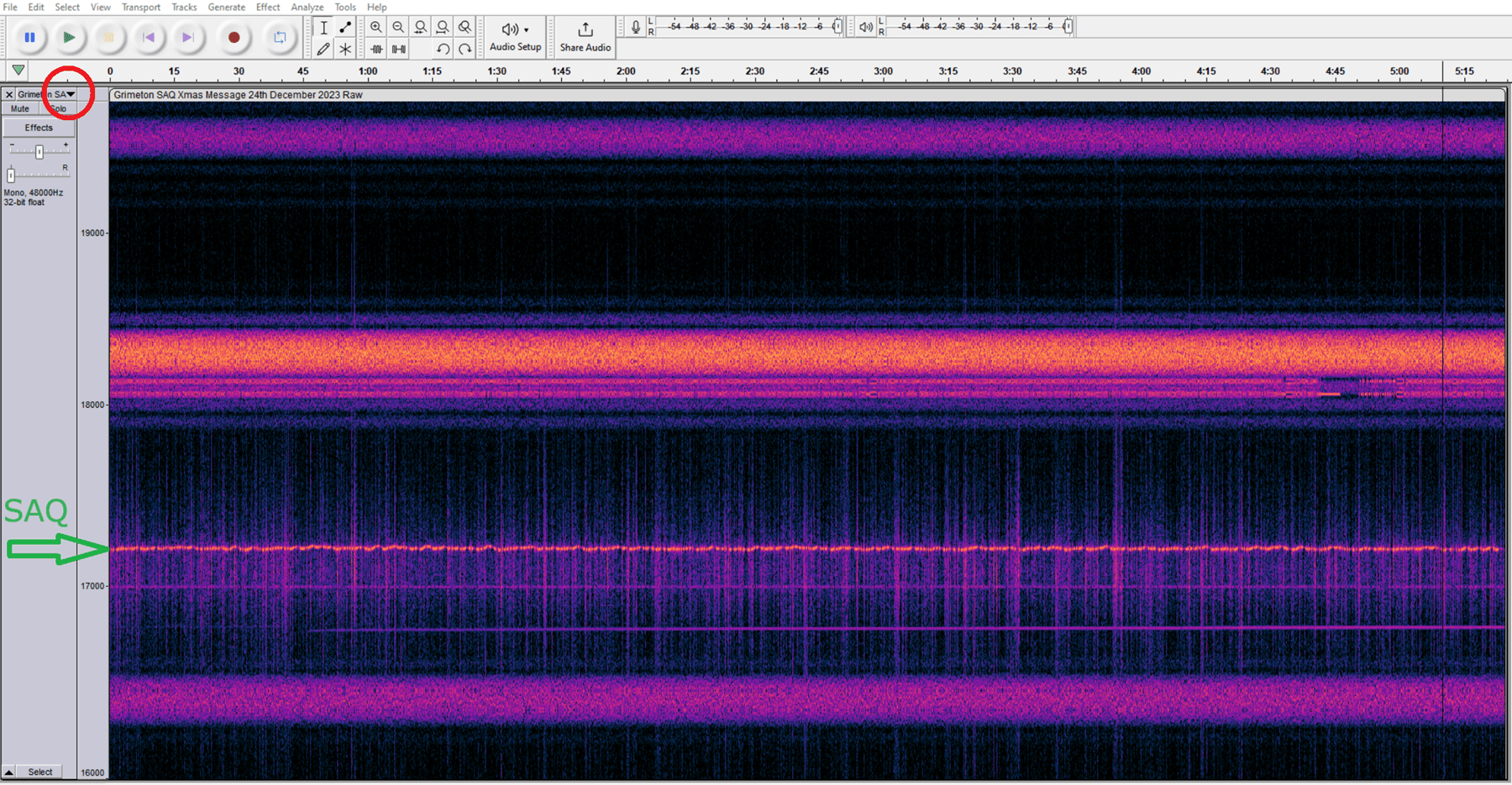

I reprocessed the SAQ Grimeton Christmas Message this morning at the more standard Morse tone of 750 HZ.
The processed file "Grimeton SAQ Xmas Message 24th December 2023 750Hz.wav" is in mono at 8000 samples per second.
During the processing I realised that the Morse code can be seen in the raw data.

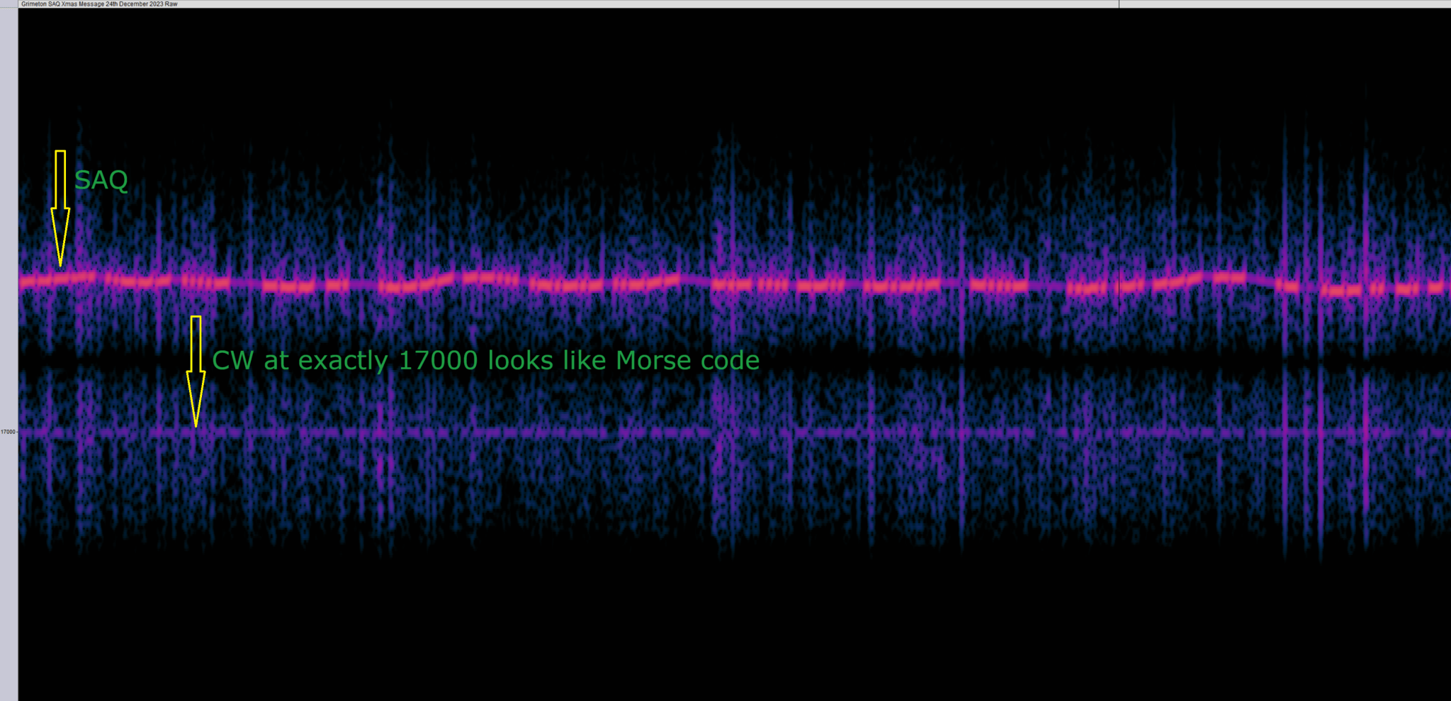

There is a very faint CW at exactly 17000 Hz that is modulated and looks a bit like Morse code ????
So I expanded it as following image:-
Also noticed the small variations in the SAQ CW frequency whereas others (crystal or atomic clock controlled) do not vary. Also noticed that the SAQ CW never completely turns off, its still there between dots and dashes. They told us this happens in the explanation.

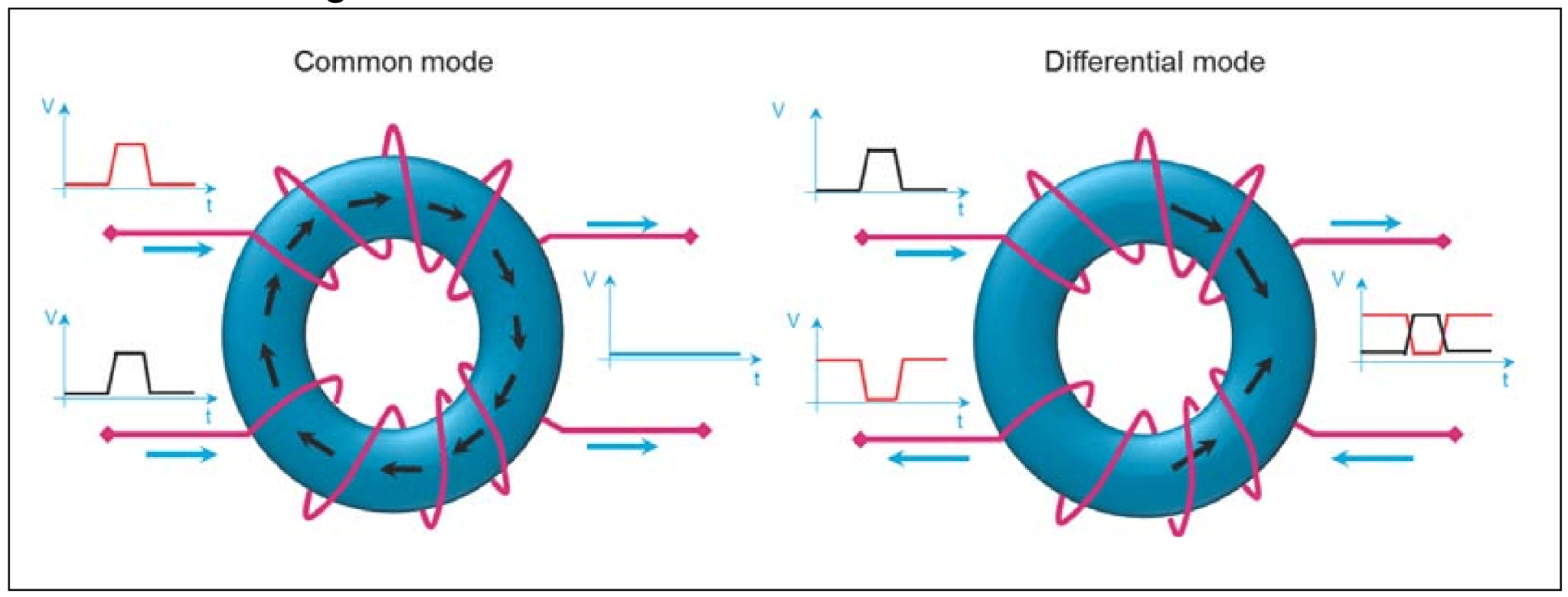

There is a paper about Common Mode Filters written by Siemens, maybe these types of filters might help antenna noise. Its just that a lot of problems in audio and electronics in general are unwanted common mode signals .
The effect of common mode filters depends on the impedances involved. With bad ground here (between 2m ground rods spaced 2m there's 140 (!) ohm) even 1k impedance (at 100 KHz) of the common mode filter wasn't enough. Hence the S/N improvement by fully symmetrical loop antennas and close to SWR= 1 feedline.
The original processed has some noise but sounds like telegraphy.Here is the CW at 17000 Hz shifted to 750 Hz - Sounds like Morse or machine made to me.
This new processed is not so clear. It sounds like a recording made underwater.
The first .wav file attached to #342 is SAQ reprocessed. The second file from a CW at 17000 Hz attached to #344 is not SAQ. It is just very close by and I'm interested to know what it is.This new processed is not so clear. It sounds like a recording made underwater.

17000 is not listed in the https://www.sigidwiki.com/wiki/Signal_Identification_GuideThe first .wav file attached to #342 is SAQ reprocessed. The second file from a CW at 17000 Hz attached to #344 is not SAQ. It is just very close by and I'm interested to know what it is.
There is an associated Discord server where people discuss signals. Perhaps you can inquire there
When you identify 17000 you can email your findings to the wiki admin
Is 17000 still active or does it just shadow 17200
