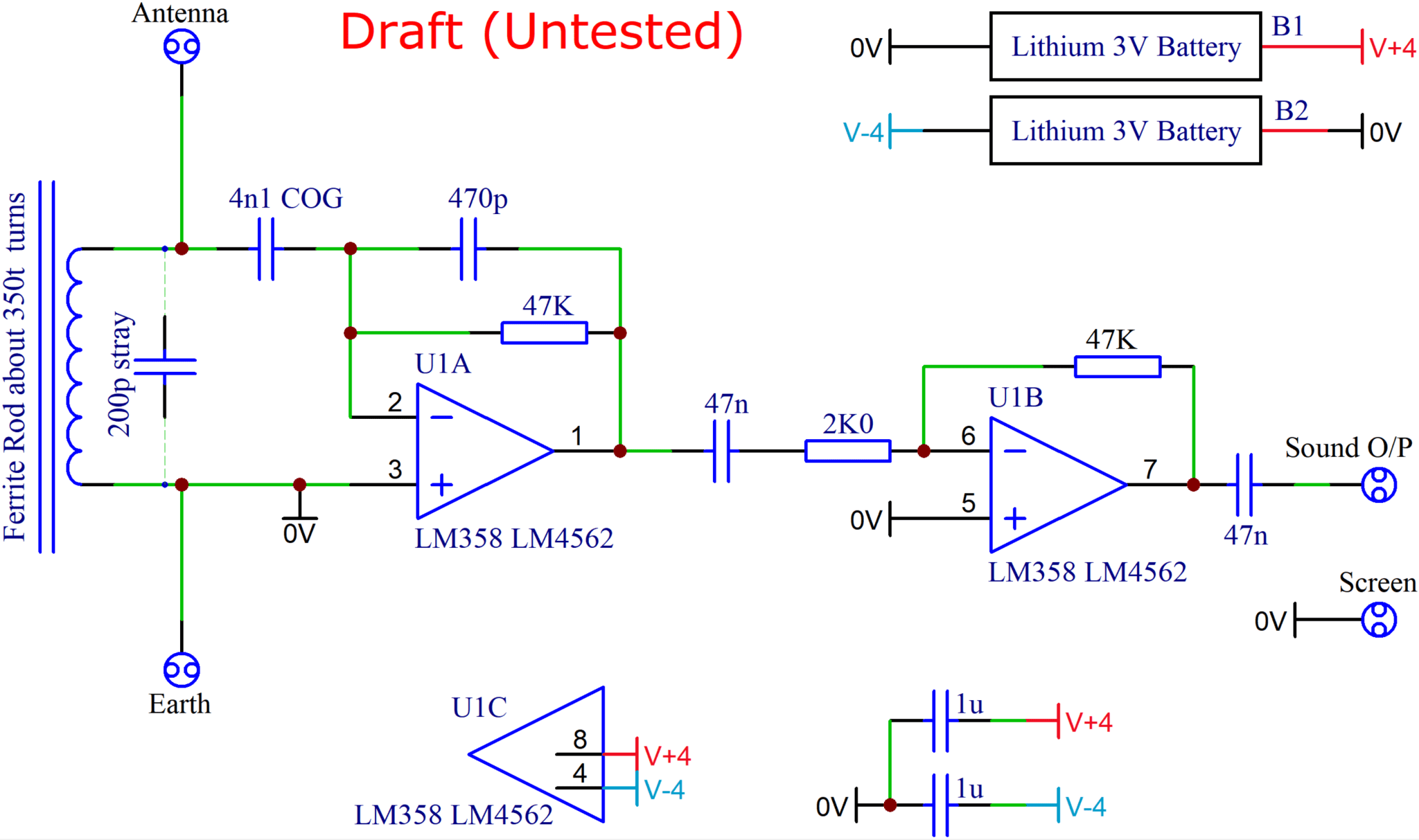

I see a lot of parallel resonant circuits here for receivers, would there be any benefit in having a series resonant circuit and feeding it into a virtual earth on an op-amp? i.e. a short circuit at these VLF frequencies
With proviso for receiving Grimeton SAQ (or some other VLF transmitters).
The parallel stray capacitor creates an unwanted resonance, lets say it is 200pF.
So converting my "Simple VLF receiver" to an untested draft series resonant circuit pitting in some values and doing some sums:-
For receiving Grimeton SAQ at 17,200 Hz:- SQRT(LC) = 1/(2 PI fo) so L = (1/(2 PI fo))^2 / C L = 20.88 mH
So 20.88mH in series with the 4n1 capacitor resonates at 17,200 Hz.
Now what does the stray capacitance resonate at? Fstray = 1/(2 PI SQRT(LCstray)) Fstray = 77,880 Hz
The low pass filter in U1A feedback loop is -3dB at 45.3 kHz so getting on for -6dB down at 77,880 Hz and software filtering in Audacity will eliminate the 77,880 Hz resonance completely.
So yes for VLF (certainly at 17,200 Hz) it looks like a series resonant circuit will work nicely - good idea @brig001

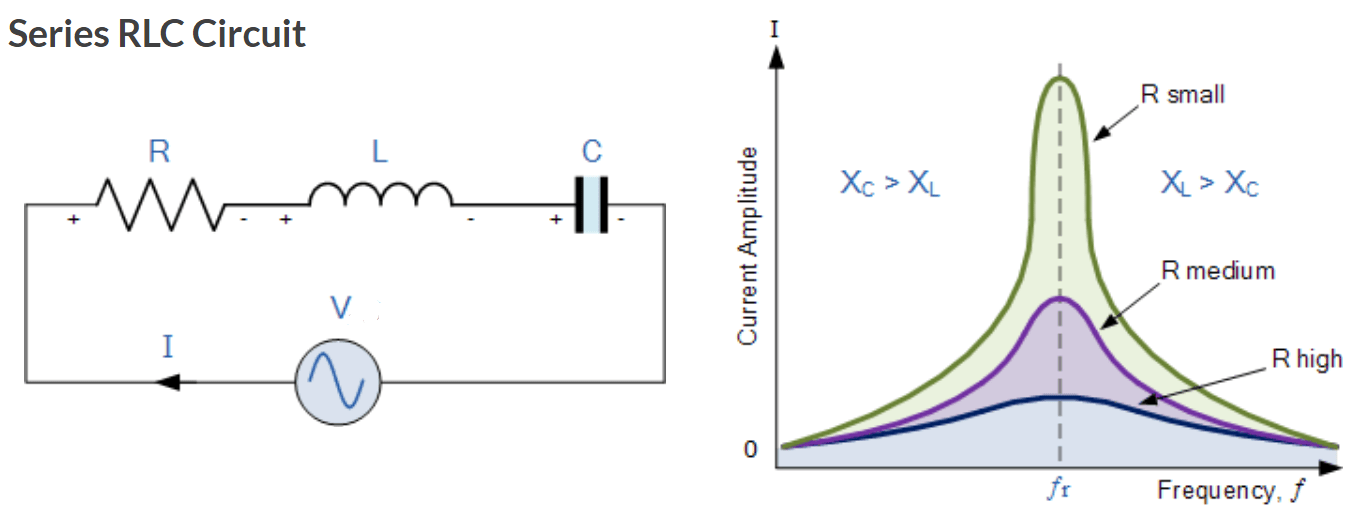

No, it isn't a series resonance. When using a series resonant circuit it has to look like the pic below. In the pic, R2 is the antenna impedance (when using a wire, much higher than 1k), C2/L1 the series resonance, L1/C1 causes the sharp dip useful to attenuate an unwanted signal. In a "real world" circuit the dip is less deep and wider because in this example the series resistance of L1 has been ignored.

@Aridace. I think you are wrong, the circuit in #367 is indeed a series resonant tank, the same as your circuit drawing.
One of the main reasons to abandon analog radio is the inevitable increase of EMI produced by power plants using digital control. With electric cars it's the same: much interference produced. In urban environment, all things switching. My first complaint against the power company concerned a level of EMI so high that it negatively affected the health of every organism exposed to it.

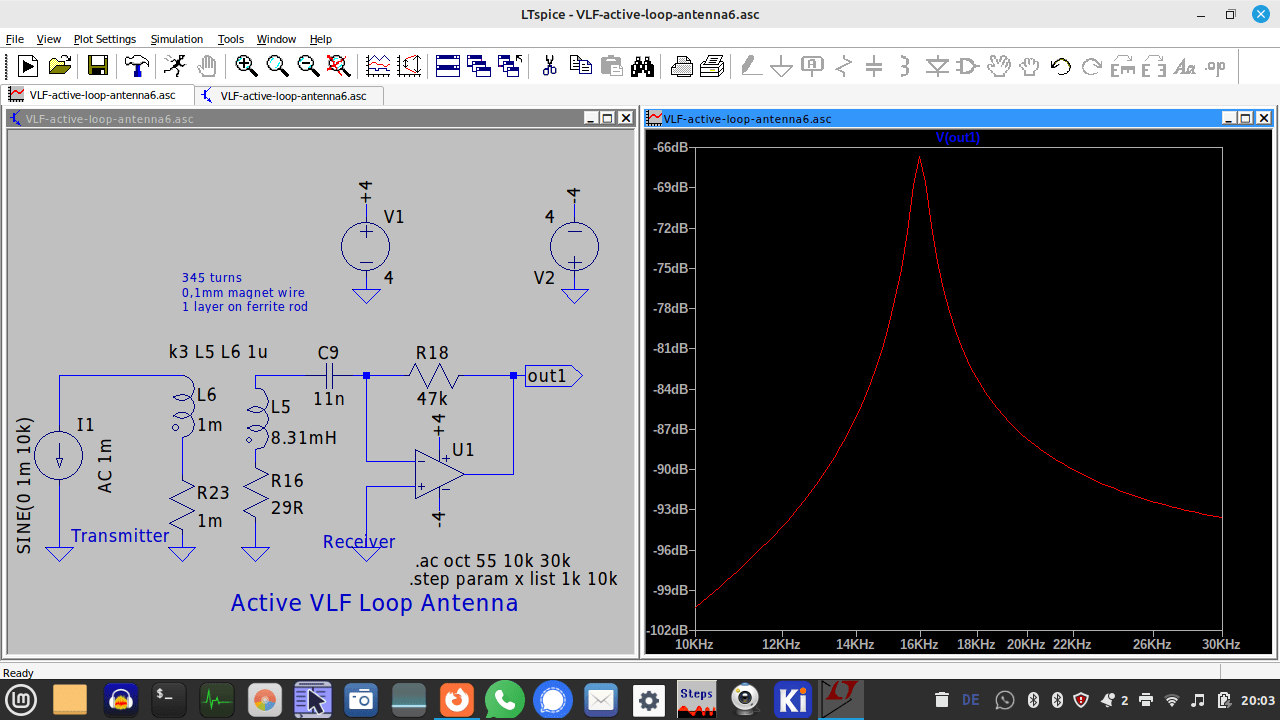

@bucks bunny I'm sure the circuit #367 concerns parallel resonance. Remember that for an ideal inverting opamp the 4N1 cap is parallel to the stray cap. Just prove you're right with a sim, showing the series resonance and the parallel resonance in #367.
The series tank is the same as the parallel tank. The only difference is the current input that senses circulating current instead of the voltage input parallell to this tank
@Aridace @brig001 "No, it isn't a series resonance. When using a series resonant circuit it has to look like the pic below"
Seems to me that it does look like your simulator circuit. I have drawn an equivalent circuit for my draft "Series Resonant Simple VLF receiver" Please consider this diagram:-
You are considering your simulation in terms of a connected external antenna that is affected by circuits whereas I'm thinking about the Ferrite Rod on its own receiving signal (magnetic flux change).
The Ferrite Rod will have current induced in it by the received CW signal (represented above by a zero resistance Current Generator). I measured the Ferrite Rod coil as 7.1 Ohms. The Inverting Input of the OpAmp is a "virtual earth" so effectively pin 2 and pin 3 of the OpAmp look like a short circuit to the series resonant circuit.
So we have a series resonant circuit where currents in the loop are large at resonance. So calculating again, the resonance frequency fo is given by:-
fo = 1/(2 PI SQRT(LC)) so fo = 17,200 Hz (as before) and again the stray capacitance will resonate with the Ferrite Rod inductance at 77,880 Hz which can easily be filtered out.
Working out the Q of this equivalent series resonant circuit as follows:-
Q = 1/R x SQRT(L/C) = 1/7.1 x SQRT(20.88 mH / 4n1) so Q = 318 which is quite high!
Now in this configuration the OpAmp is responding to current input and producing a voltage at its output which is good because at resonance currents in the equivalent circuit loop are high.
Am I missing something?

Show that in a sim please.The series tank is the same as the parallel tank. The only difference is the current input that senses circulating current instead of the voltage input parallell to this tank
simu
Can you run the simulation again please with my measured values as follows:- R16 = 7.1 Ohms L5 = 20.88 mH and C9 = 4.1 nF
It should resonate at 17,200 Hz with a Q of 318 assuming U1 OpAmp is very good.
What is a good value for R18?
@richgwilliams For a ferrite coil used as receiving element, the input should be represented by another inductor, with a coupling factor low enough, like 10^-5.
Just do that and show parallel and series resonance.
