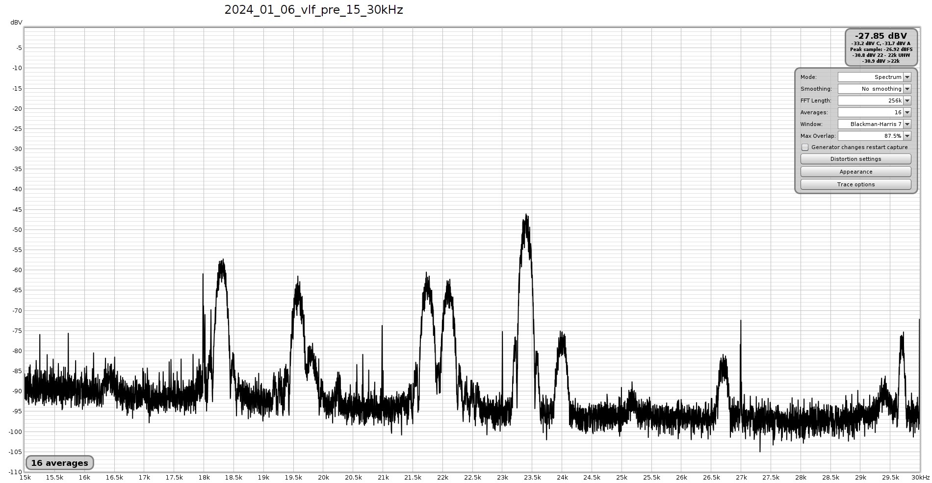

Tuned Sound Amplifier/Receiver for the VLF Christmas Eve transmission from SAQ, Grimeton, Sweden
This antenna placed in the cellar, >2m away from my electronics

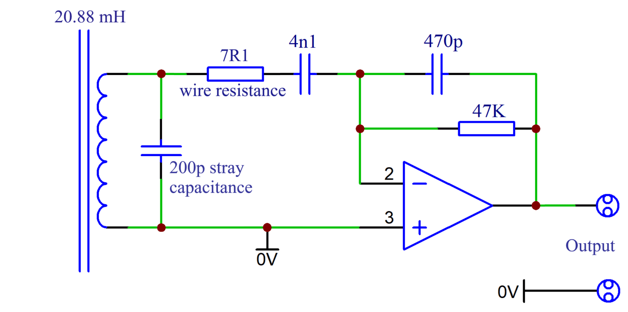

Yes the virtual earth of a good OpAmp can always be relied upon provided the OpAmp has sufficient bandwidth and slew rate and has sufficient output swing to drive the feedback network, sometimes one of the reasons why + - 15 volt supplies are preferred.

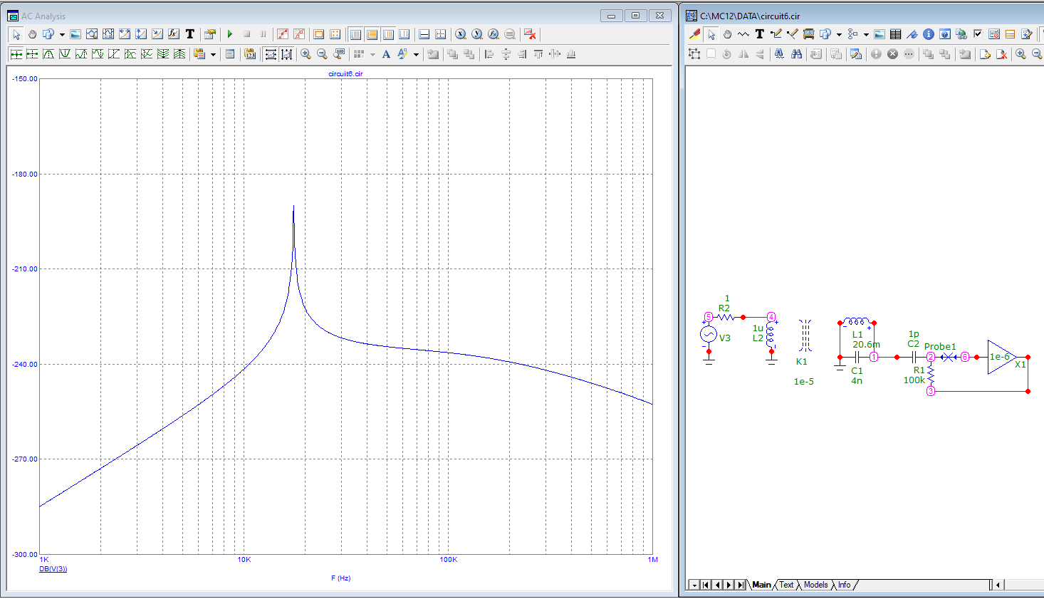

Yes I understand your simulation now the sine wave source V1 is doing a frequency sweep so the the stray resonance would have shown up if it was there.

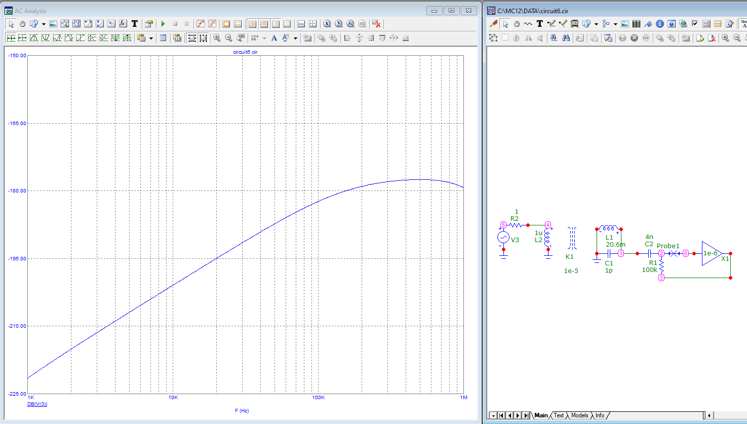

Indeed, doing a frequency sweep in Micro-cap is also called "AC analysis". But in a separate AC analysis mode it can do noise analysis, providing dB(V) per SQR (Hz) for input and output which I always for active antennas.
Reactions: richgwilliams
The blue line is the opamp output node 2 (number 2 in red circle). The red line is the voltage over the coil (and over C1).
I see an outpur voltage peak at resonance, thus input current must peak her. So input current is max at resonant frequency, right? For me this is a series resonant tank. And yes, voltage across inductor and capavcitor peak at series resonance the same way they do in parallel resonance.
It's more complex than that due to the virtual earth input. In a classical series - parallel circuit the response shows both frequencies. The circuit with the opamp doesn't.

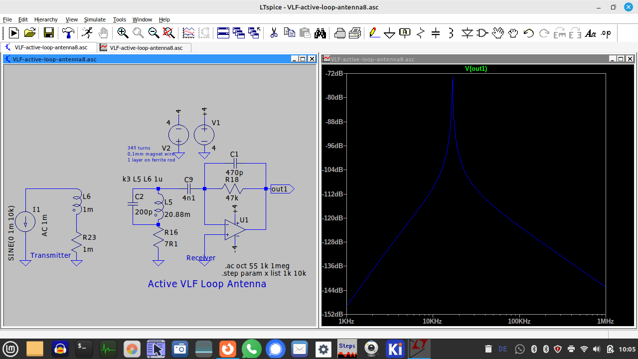

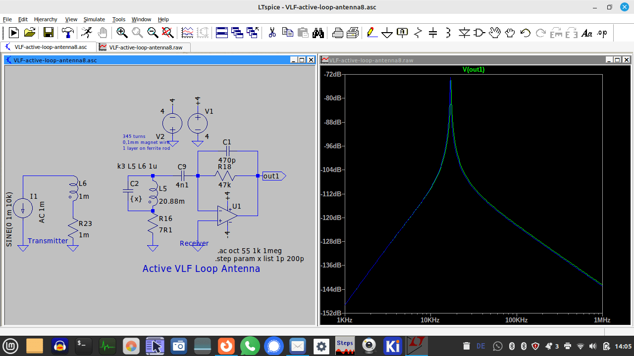

It might be useful to show the extremes re C1, C2 (with ideal opamp) as to "resonance":
These simulations don't make any sense to me? I don't understand the OpAmp with only one input, I don't see a virtual earth.
Why not simulate this circuit, it is the series resonant at 17200 Hz and has real measured values:-
L = 20.88 mH, R = 7.1 Ohms, C = 4.1 nF, C stray = 200 pF, R feedback = 47000 Ohms

With respect you posted many simulations none of which are this circuit and most of them are confusing the issue which is series resonance.
Can anyone else simulate this series resonant circuit with the values given please?
Intended resonant frequency is 17200 Hz
