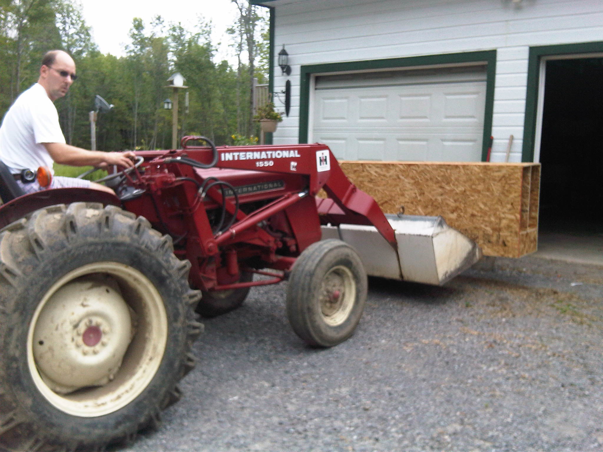

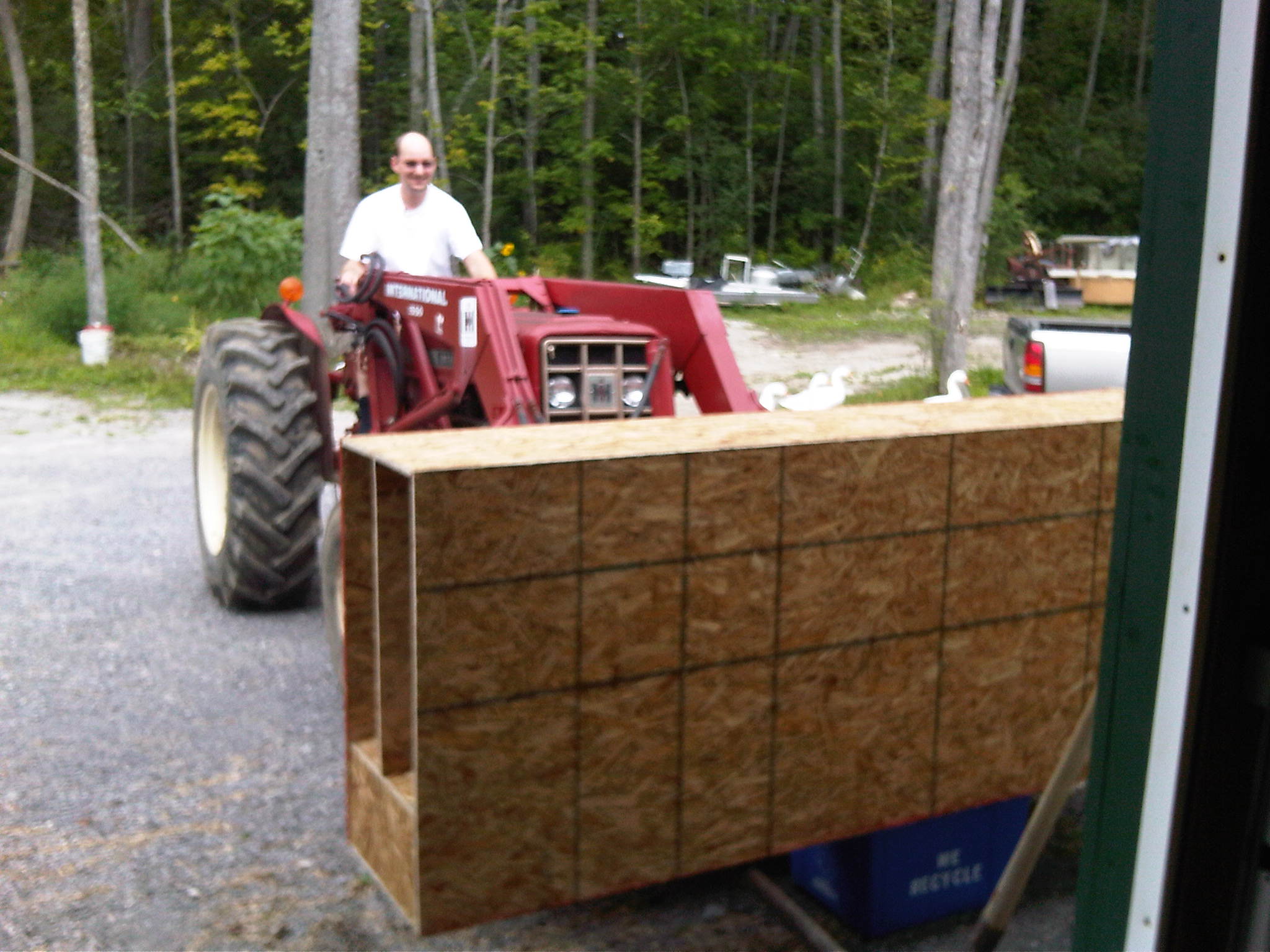

Well a good design needs well done measurements and plans. These things take some time. And right now my time is on the short side of very busy. The good news is I have the sub indoors. I will be able to do some testing over the next couple of days. Kind of hard to move around all by myself. Crazy thing weighs close to 200 lbs or 90 kg.

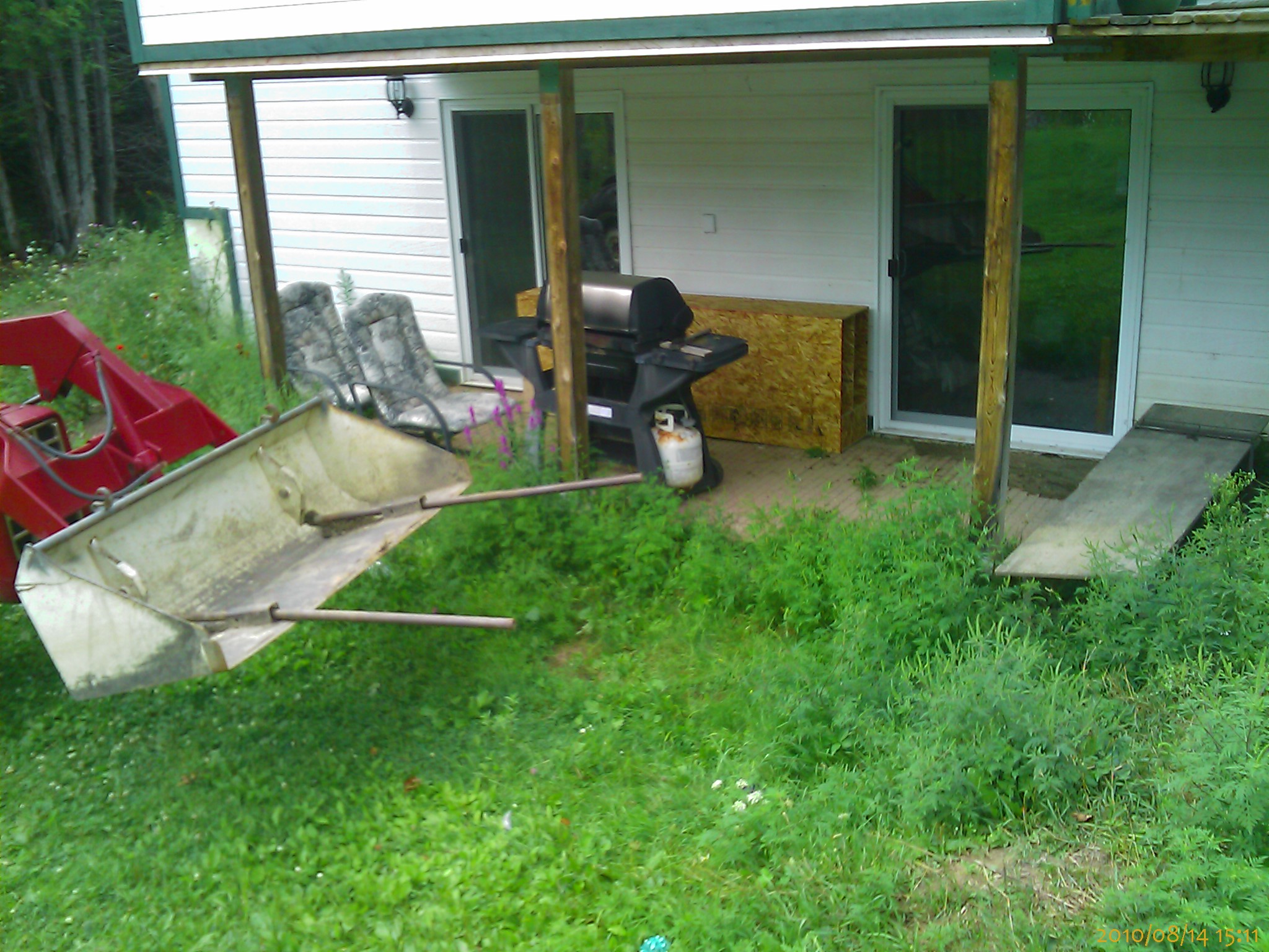

A little light lifting
Well the beast is now where I can measure it. Just that it is raining so hard I'll have a whote noise spectral contamination punctuated by real bass thunder claps. I just can't win!
But it is sitting right near the puter and the amp to drive the signal. So when it quiets down there will be some measurements.

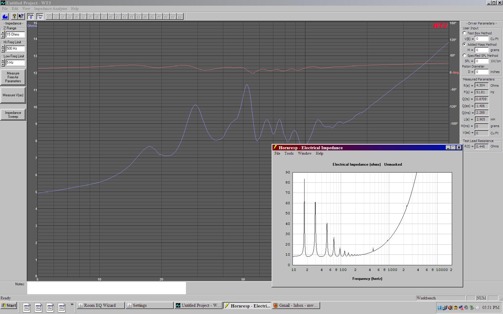

Allright here is a semi 4Pi measurement of this horn. I cannot do a true ground plane as it is really wet and I had to cut the grass before it started raining. Now I really have to cut the grass.
So I present the impedance plot which is quite different than Hornresp. But still has the peaks at the right places. Me thinks there is a bit of a leak someplace on the horn as there should be the highest peak at 18hz as this is the Fs of this horn. The horn sat in a shed outside for about a month and things tend to dry out and do wierd things. I'll check it out a bit more this week.
The SPL graphs corelate pretty well with the simulations though.
So all in all even sitting inside as I am measureing a sub that is outside it still quite an experience. Still kicks some serious butt.
Note that there is no hocus pokus on the SPL graphs. I could use smoothing to make them look wonderfull. But the raw data is the stuff that is most useful. The one third octave is there to yank your chains! Marketing department types need not apply!

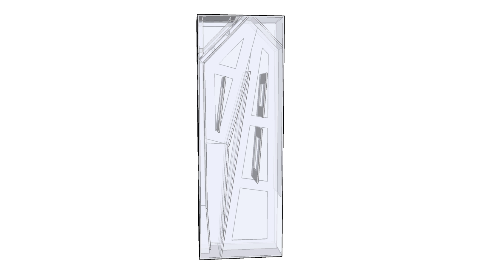

A great wizard with google sketchup named Dan has done a really cool rendering of the box.
I have done all the cut sheets needed.
