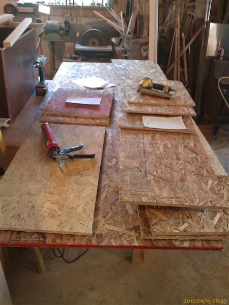

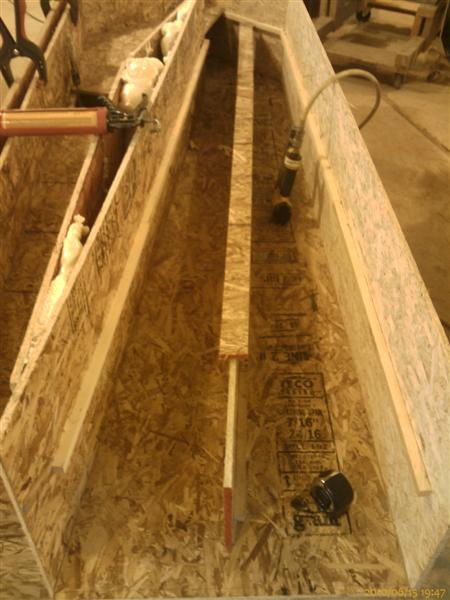

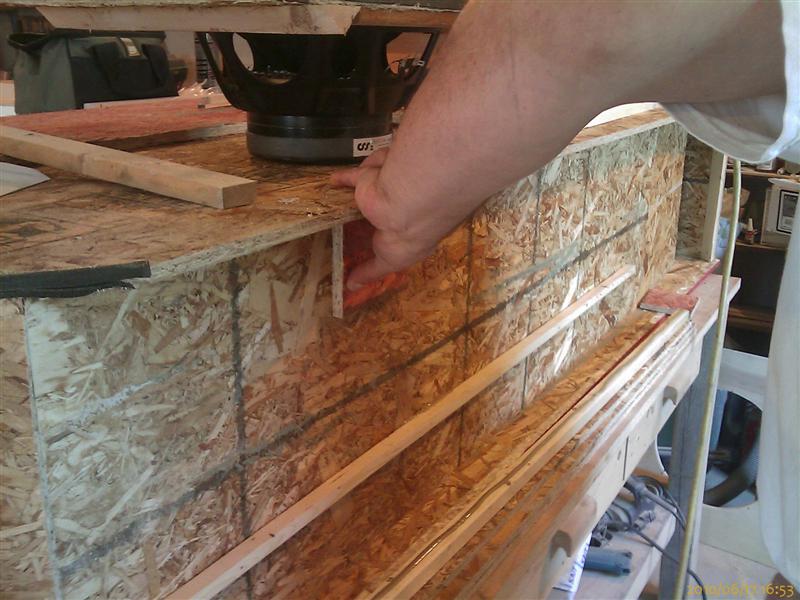

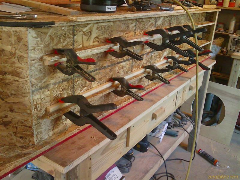

Hello Gents.
I post a newly designed and constructed horn loaded subwoofer. It uses the CSS TRIO8 driver and a meager 4 sheets of material to make a horn solid down to 18hz. Tell me what you think.
The pics are here: Horn Subwoofer pictures by mwmkravchenko - Photobucket
Mark

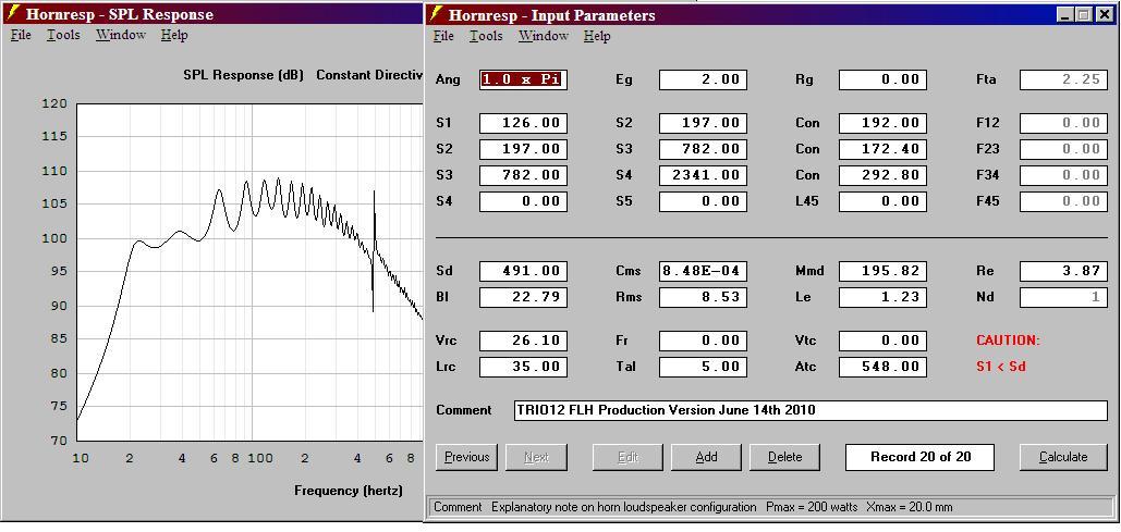

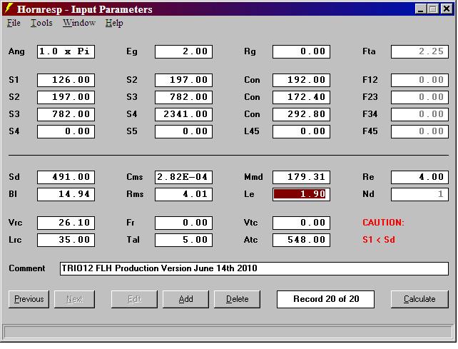

Anyway, the driver specs for your design are so far from what's published that to call it a TRIO12 is a gross misnomer at best, so what gives?
GM
Hi GM
WHat gives for the specs is mee posting the wrong screen. I did some work on the same box with an RCF driver. So attached is the right screen. The bottom end is a bit more wavy but not that much different. To many jobs to do and not enough time to do it! I wanted to see the difference between a high efficiency driver and the TRIO 12. Not that much actually.
Agree on the tapped horn's posted. And further agree on the right of Tom Danley to make a living without anyone undermining him.
Two true horn designs have been posted. One was a direct drawing from DSL and the first one was an actual derivation from the DTS 20 I believe the Tower of Power one. Again you need the driver. Without the driver the speaker will not perform properly.
Now I have to cchase down a glue block that failed to bond properly. Haste makes waste! Now I have to remove one side of an enclosure that was never made to be removed! Chainsaw time!
