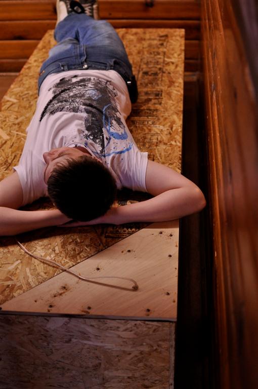

Big box. The one in the picture is the 23 foot horn it is 16.5 " x 32" x 92". Only addicts may apply! But once you hear one of these brutes all other sub-woofers sound.....neutered is the best term.
Mark
