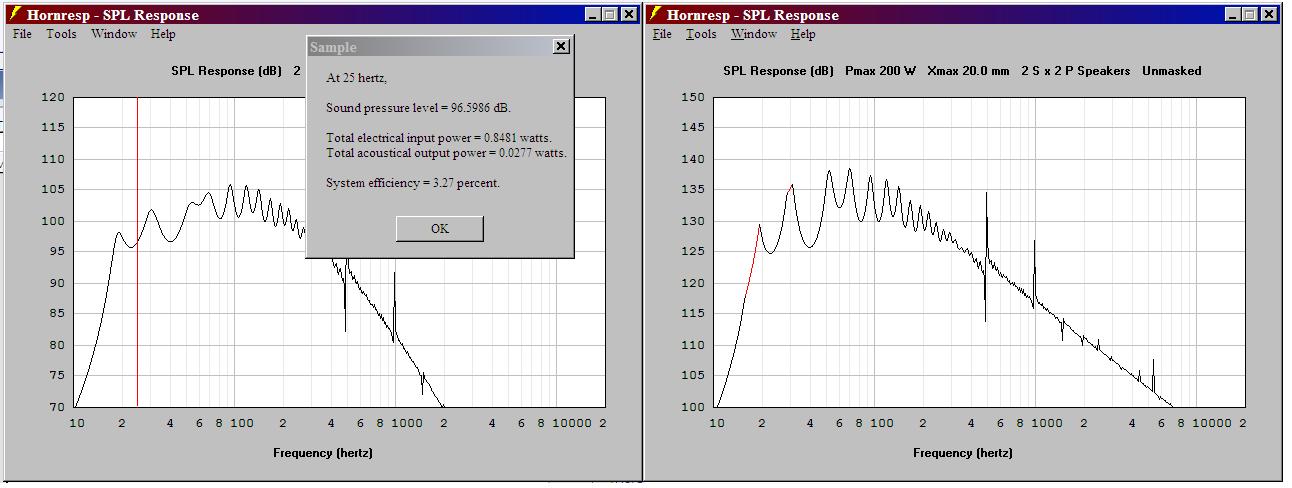

Sure but your looking at a box the size of a phone booth. If you want high efficiency into 2P1 space you need a large horn or at least four of the one your reading about. If you model it in hornresp and use the mutiple box option you get this in 2Pi with four boxes.
Mark
THe graphs I just posted are for four pieces on the TRIO12 Front loaded Horn in this thread. So it is a huge box. 27 cubic feet each. Stacked up as a quad with all the mouths setup close to each other in a wall type configuration.
So each box is 16" x 32" x 92". Each box uses a single TRIO12 driver and with the 200 watts input you get the wonderfull SPL in the graph.
Horns rule!
Mark
