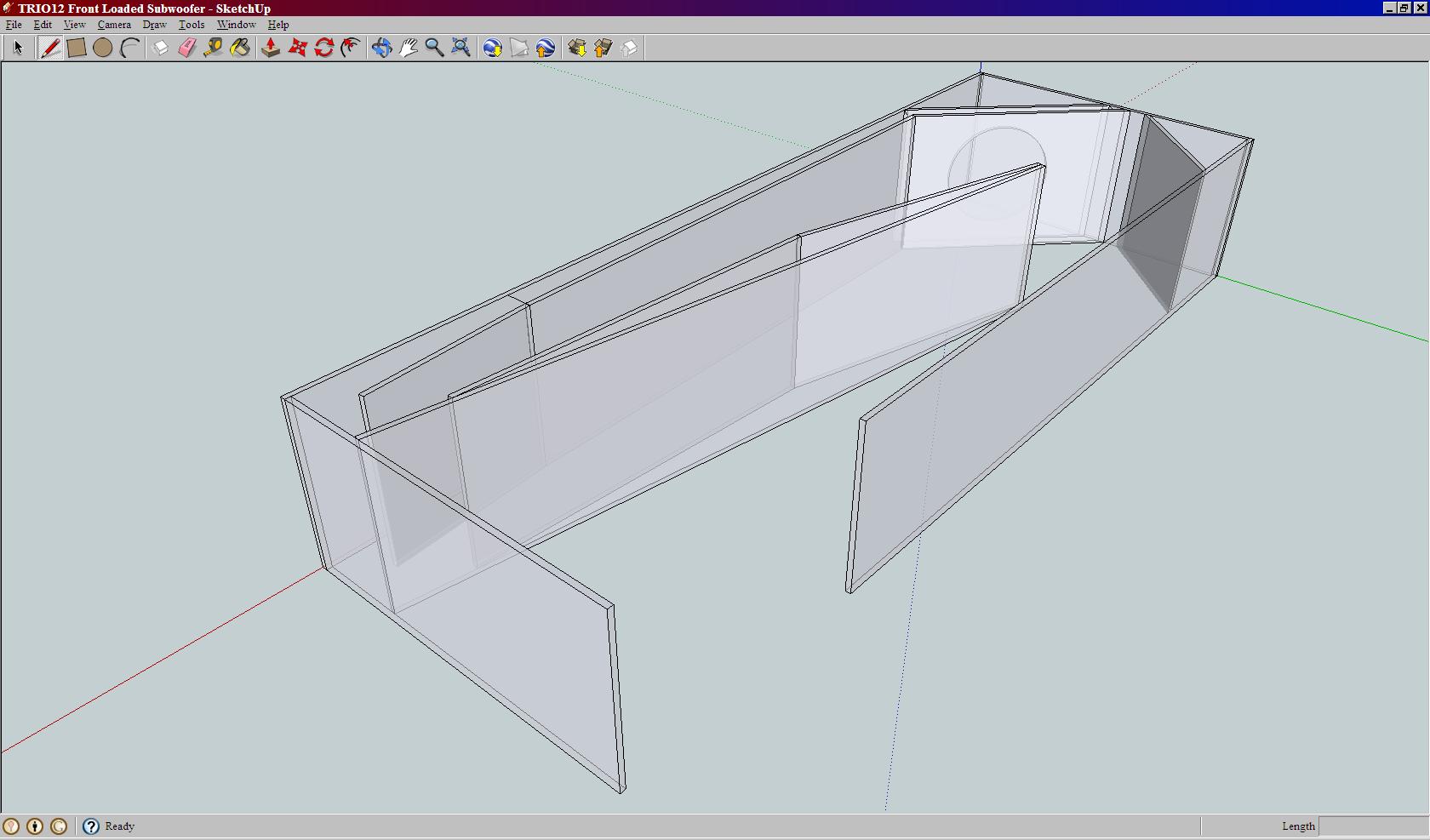

I posted this a while back on another forum. Diymobileaudio.
It describes fairly coherently what horns do best:
From what I have come to believe in building and designing horns this is my theory in a nutshell ( albeit a rather big nut shell ).
Horns can massage more molecules of air per given movement of the cone than any other box configuration that I know of. Because they can do that they are more efficient than any driver directly radiating into a room or space. Because they do more with less they can also when properly designed do it it much less distortion. You just have to look at the cones in a horn when it is pumping out crazy volume and the cones are barely moving.
The explanation for this effect that I have read that makes the most sense and that I can attest to from my own observation is that the molecules of air that get vibrated or excited by the cone movement want to dissipate their little bit of energy.( No I can't see molecules of air
) That is true with any driver radiating into any space. In a horn they have to do that with a very controlled amount of air molecules. Less close to the driver as the horn area is smaller there. These little air molecules are most energetic when closest to the driver and as they are pushed along because they are being corralled and herded by the horn structure from a very confined space to a more open space. The originally excited molecules of air excite more molecules of air on their way out of the horn. They loose a bit of energy from each exchange of energy molecule to molecule. But the greater the number of molecules that are excited to a higher energy greater the potential sound pressure level at the mouth of the horn.
We know from basic physics that every object acted upon by an outside force wants to dissipate it's energy and return to a state of rest. So all the excited molecules of air within that horn structure are a captive system that has a given mass of air within it. That given mass of air when excited by a driver wants to get back to it's resting point. So all that energy gets shot out of the mouth of the horn and it dissipates into the room. But the efficiency lies in the trick that a great big amount of trapped air within that horn has been driven into vibration by that loudspeaker cone. That is why the horn is more efficient. No directly radiating cone could ever push around as much air . That is also why when you simulate horns you usually find that the larger the volume of the horn the greater it's efficiency. It really Sucks because everyone wants a small horn that acts like a big horn. But a big horn with a few watts can blow away any normal box be it sealed or vented with much less distortion in the sound than any normal radiating box with even kilowatts of power behind it.
I'll add this bit:
A large horn has the exciteable air mass within it that no other driver/box sytem can compete with. A tranmission line is not really a horn in that it changes the acoustical impedance of the driver/ room interaction to the same degree. As GM pointed out almost all the tapped horns are quater wavelength resonators that have there length tapped at some point to approximate what we see in Danley's designs. But few have any appreciable gain in the efficiency of the drivers base level SPL / watt. Danley's do.
I know through private correspondence that GM and I have designed true tapped horns. But out of respect for the guy who needs to make a living from them I won't post any designs. I say this because a lot of effort is required to get a driver / box design to the point that Mr. Danley has worked to. I'm in awe of the idea. To create a horn that is essentially a horn bandpass hybrid that really works is truly a ingenious feat of true engineering. There may be prior art to the effect that it has been proposed before. But that does not mean that anyone has actually gotten the things to work as well as he has.
So failing a tapped horn that would only be about 18% smaller and a couple db less efficient I give this design as a starting point for the bass starved amongst us. A good friend did this rendering for me. It gives a great representation as to what is inside.
Now I have a question or two regarding preferend building materials.
5' x 5' baltic birch?
4 x 8 baltic birch?
4 x 8 structural sheeting?
What is readily available? I'm a cabinet maker. I can get almost anything. But what is generally available is more important.
Or should I provide cut sheets for both sizes and do it that way?
Mark
