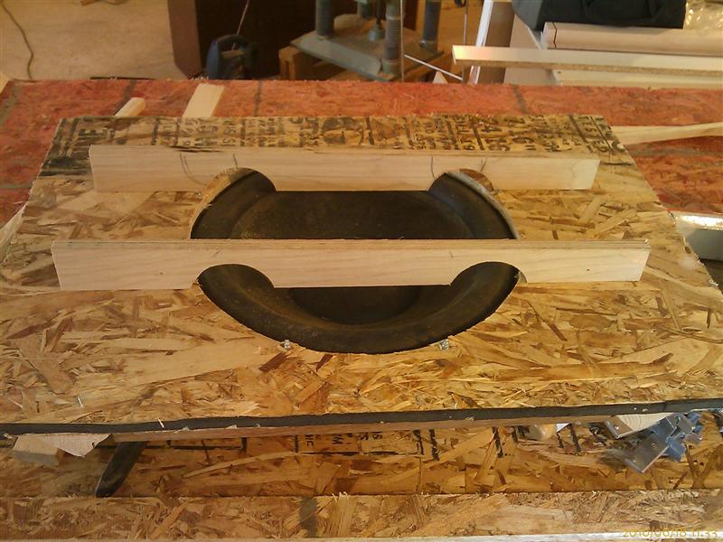

Nice folding, good work!
I didn't see in pics but I supose the first portion of the flare (those two panels close to each other) is well braced like the rest. I said this because there is expected to be the most high dynamic presure load of the entire structure.
Dorin
Thank you Dorin.
The fold was indeed very difficult to make compact. I was quite happy with the small amount of wasted space.
Yes the greatest pressure is at the beginning of the horn throat and it rapidly decreases as the wavefront progresses down the horn path. My error was in underestimating the required bracing.
That problem is now repaired.

Well I should have done the job like this the first time. But a mistake is a reason to do something better.
Take a look:

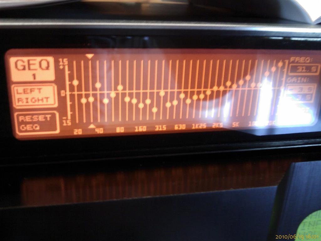

I post a pic of the output on the RTA from the Berhriger
DEQ2496 Ultracurve Pro Digital EQ/RTA.
The increments on the RTA at this level were 3db at the highest peak off of flat. That's down to 20 hz. The microphone was the ECM 8000. Measured about 4 meters from the mouth of the sub. I know that low end measurement is tmpermental in rooms and has to be properly averaged to be taken as gospel truth. This was single location one third of the way into a 30 foot long by 16 foot wide room. But it serves as a baseline for you guys to look at at any rate. Listening impressions from a seasoned low end listener like me put the response as spot on. I could count the beast at the low C on the Saint Saen's piece. I have run that through a RTA many times and know that at a couple of points the open stop that is used is a pretty clean sine wave at 16.8 hz. Sweet to say the least. So I amongst a zillion things to do this week I will try to sneek in some measurement time on the sub.

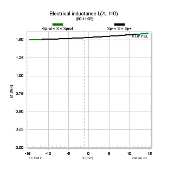

Oh agreed. I'm likely not going to be using anywhere near the peak linear excursion anyway - looks like my projected linear requirement for excursion is likely going to be around 12mm max or less. The 1.9mH rating for Le seems a bit high - it's only slightly lower than the original non-XBL^2'd Shiva (2 mH, coils in parallel). I thought one of the advantages/effects of that type of motor and shorting rings was a lower Le?
Hi Brian
Here is the Klippel analysis of the TRIO 12 inductance. Pretty flat. It is a function of the winding geometry and the XBL dual gap motor system. Pretty hard to match with any conventional winding and single gap motor structure. The most important aspect is that the inductance is very close to linear as compared to excursion.

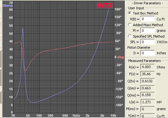

You'll see diff #s based upon where they take the inductance from- as you can see, the shorting rings are actually most effective through the midbass range. No getting around the fact that it's a big heavy coil though.
This sweep is in a 2.1 cu ft. box, sealed and stuffed
