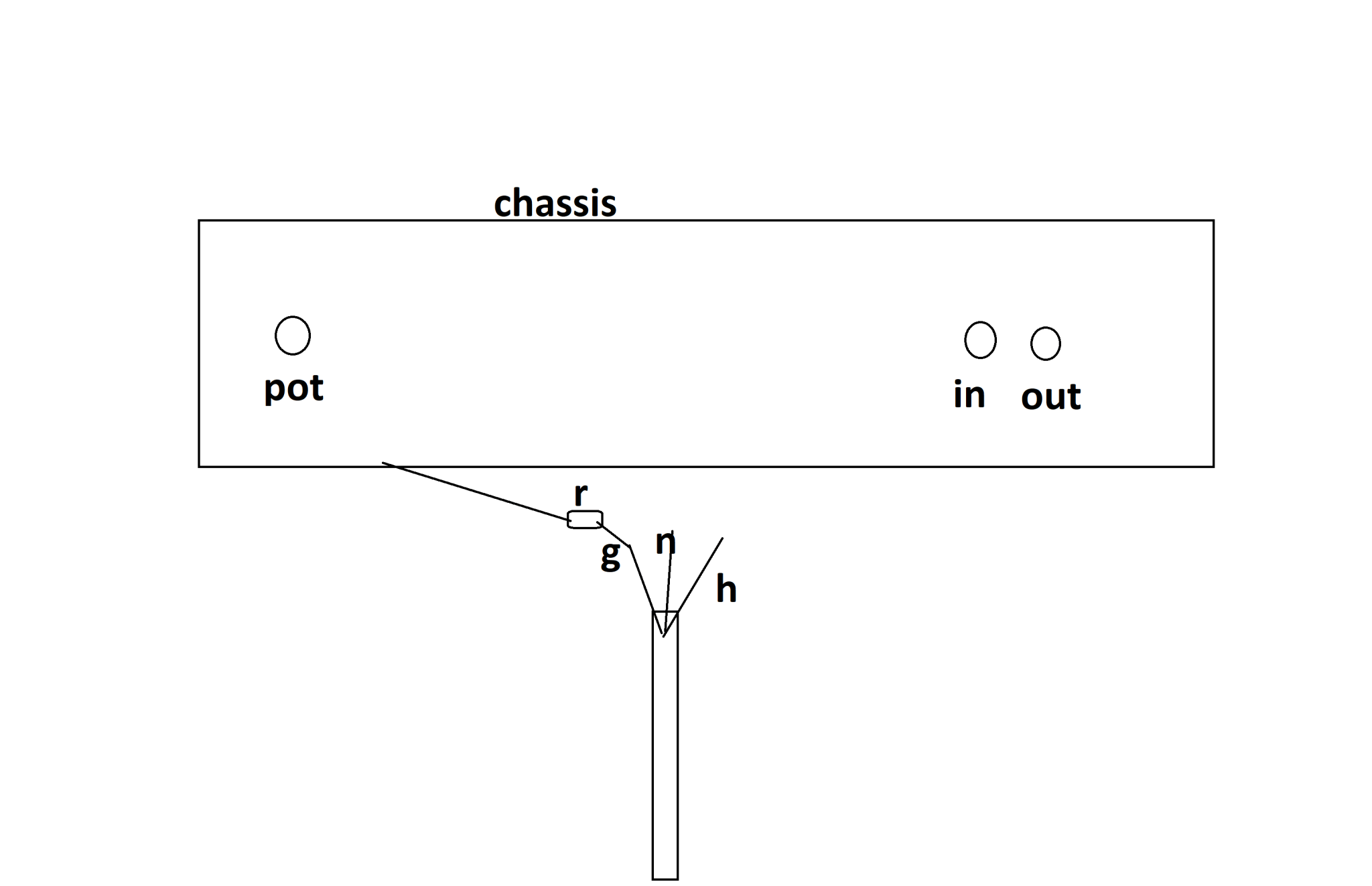

its good to know all this. btw i never conenct and dissconect cables while amp is working i never did that for 10 years i am doign music production in studio. btw i mentioned before that i do that just in case plug pin jams in socket. but anyways about amp, i added new pot 50k it works good, rarely i can hear buzz but when i mount it on seel front plate where i will connect other stuff like pw switch input and output it will be more grounded. also this amp does not have ground wire from plug only hot and neutral wires so sometime i hear radio xdd it also happend on my professional studio monitor speakers while working on not grounded power strip. i dont know if and how i can add ground wire to the amp its not designed for that i think.
You can ground the case, connect the audio / circuit common through a 10 to 100 R resistor. Tat shields the circuit, and provides solid protection for you.
Pots can inject hum if their case / shaft are not grounded. The chassis will be fine, don't connect circuit ground as well to the case.
exactly but when i ground pot to case, i dont need anything else ? i ask because my other amps have grounded cables not like this one only cable with two wires
The electrical terminals need to be connected, all three. Just as Hugo posted. The potentiometer case is a completely different issue.
Okay, you can ground the chassis (three wire mains plug). If you do, connect your circuit ground to that point through a resistor, 10 ohms through 100 ohms. Value not really critical, there should be no current flow through here.
Yes, and that must be securely connected to the rest of the chassis. The audio circuit ground connects through a resistor. Clear?
No!
Your mains ground must be bonded to the chassis, faceplate and anything you can come in contact with easily without taking it apart.
The internal circuit common connects to the chassis via a resistor.
