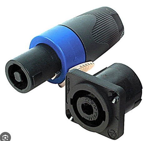

Hi sg97,
Never use 1/4" phone jacks for speaker connections. Those are a great way to blow up solid state amplifiers and they come out easily. The Speakon Hugo suggested is the very best choice.
You went the distance here.
Hi sg97,

Change the jack!!
You have no idea how many blown power amps I have repaired over the years due to 1/4" speaker jacks. They short as you pull them out, and it isn't uncommon for them to come partially out - shorting. Speakons cannot short, and they lock on top of that.
