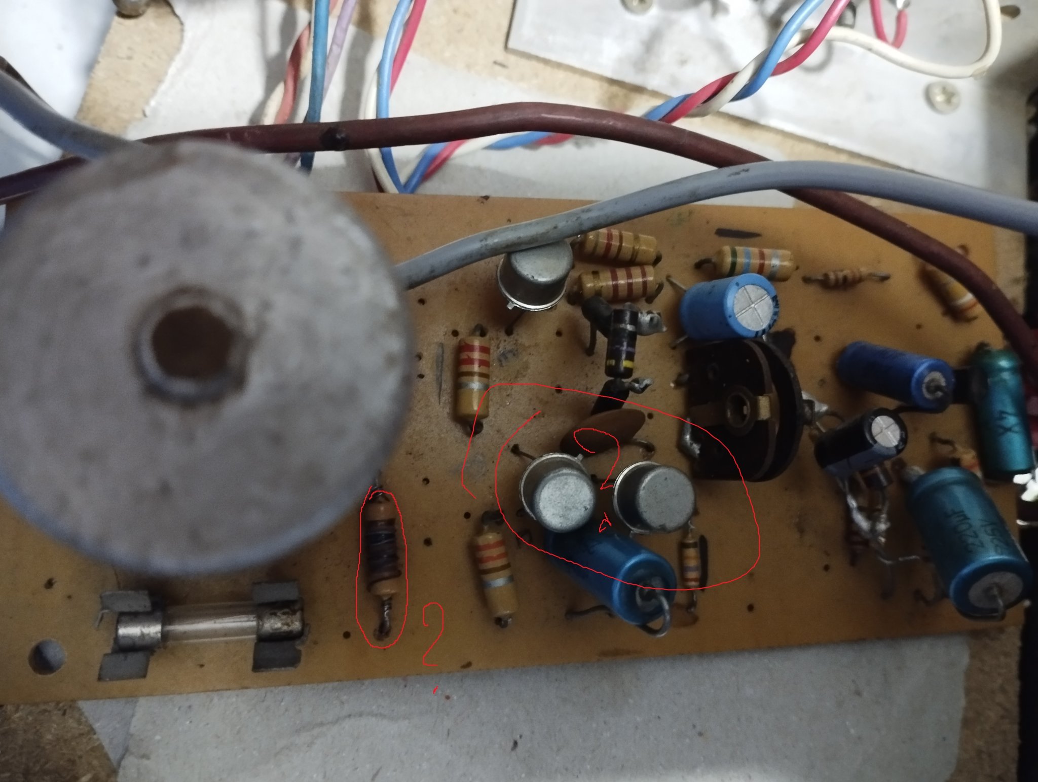

btw before year or two my grandpa was using his old amp and he missconnected speaker wires and amp was dead, i was testing it back then but i am not expert in amp circuits.
so i was not able to fix it back then,. and the amp was sitting dissasembled since then. now i want to fix it but i am not sure from where to start. it was amp made by someone, its not something made commercially , i cant find any info on it. but board for amp seems like it was from some old amp. so i remember when powering it, one of two 2n3055 transistors was getting hot and output was quiet. in the board of the amp there are two resistors that i think are also the problems but i dont know how to measure resistiors so i can find replacements. i dont know what value is used there. also i dont know how to measure other components. if someone is interested to help me on this case i can provide pictures of amplifier board.

hi thanks for the reply. btw i said that it was made by someone, it is mostly but amplifier board is not hand made it is from some old amp. what i want to know is what is likely to die in my situation when output was shorted and one of transistors is heating up fast. btw board is simple but i dont know what are values of resistors and how to measure it. also on board there are small transistors with 3 legs. but nothing is written on them, i dotn know how to measure them and to know if they work.
thanks, i will do it. i will not post a picture from rest of the amp because i know what transformer works so board is small and it does not have a lot of components to someone should know what could be a problem :D btw i really want it to work again..

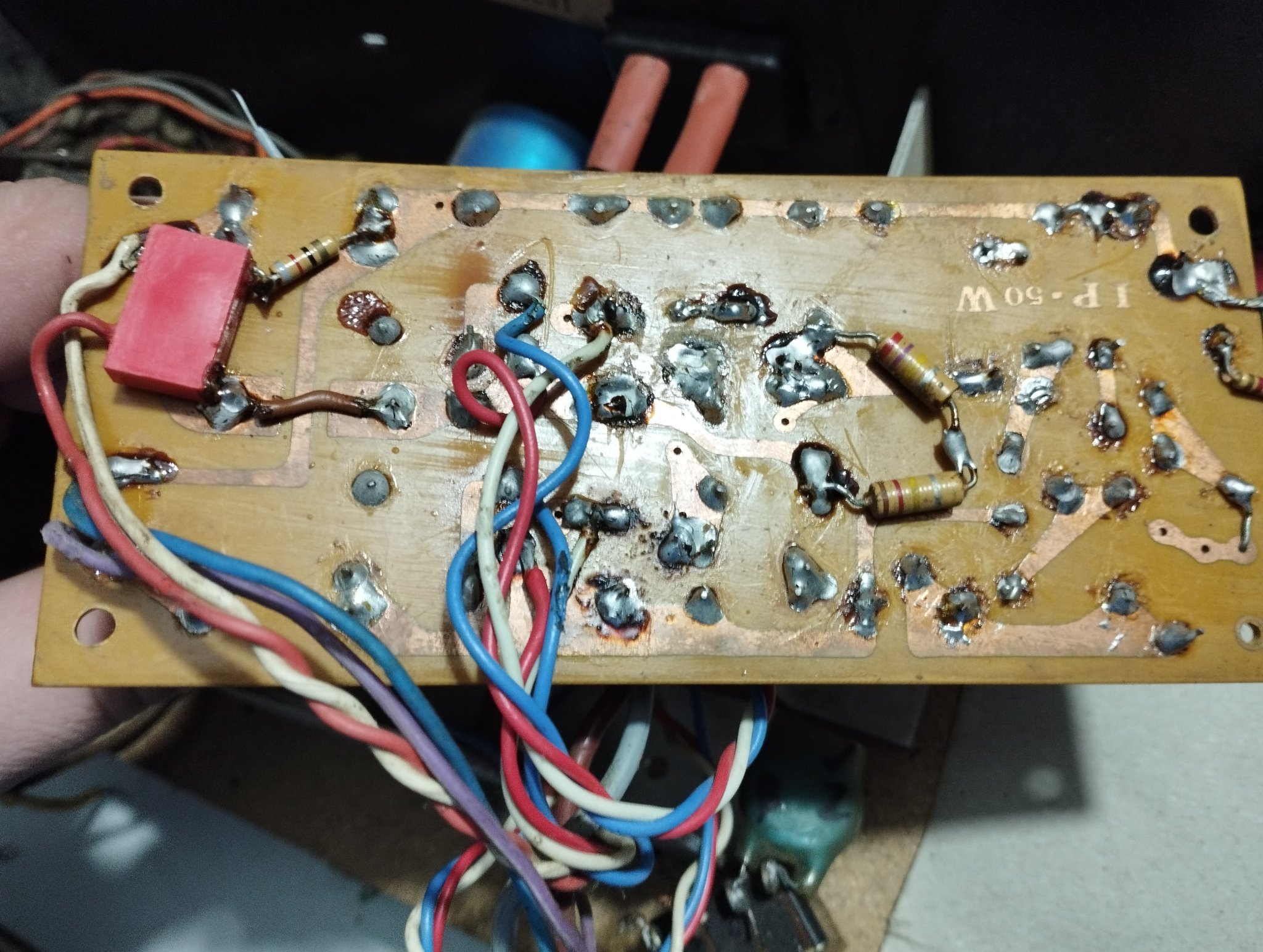

here are pictures of this board. big transistors are attached with wires so they are not visible in those pics, but as i said it was 2x 2n3055
it looks really old. practically it has no value . but for me it has a lot. so if someone understand what was done to it i would like to hear it, btw i have noticed that someone put wire over resistor maybe to increase resistance ? i have no idea xdd.

It really looks like a kit amplifier. Not a bad thing. The board is pretty good considering the age.
I see "IP .50 W" printed in copper. If you're lucky you might turn up some information based on that. If you can't we fall back onto what wmany of use would have to do. Make a picture of what components connect to what, then translate that into a schematic diagram. That's called reverse engineering.
THe easy, mindless way to maybe fix it is to simply test teh parts. Check the semiconductors first, and check for open resistors (I didn't notice anything burnt when I very quickly scanned the picture). You may have capacitors that are simply old and in need of replacement, not failure related.
main point of this is that i dont know how to make a schematic xdd i did a lot of repairs of electronics but mostly minor ones like cap swap etc, but this is something i never did before, so i want to work on it without making it worse. btw when powered, i remember that power transistor was heating and volume of a amp was low on max. so i can change transistors if needed also a resistors and caps. but for resistors i dont know what a value it is, also problem for me is that i dont know how to find a replacements for those small transistors on board, they dont have any info on them.

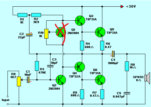

The resistor 'with wire round it' might be a diy attempt at making the low value resistors often needed in amplifier circuits.
You are likely looking at failed outputs (the 2N3055's) possibly one or more of those 'resistors with wire' being open circuit and likely the transistors driving the 2N3055's have been taken out as well.
It likely looks like this but without Q1 as I think I can make out a transistor at the right of your picture. So classic 6 transistor Quasi Complementary output stage. The 0.47 ohm resistors would be your 'resistors with wire'.

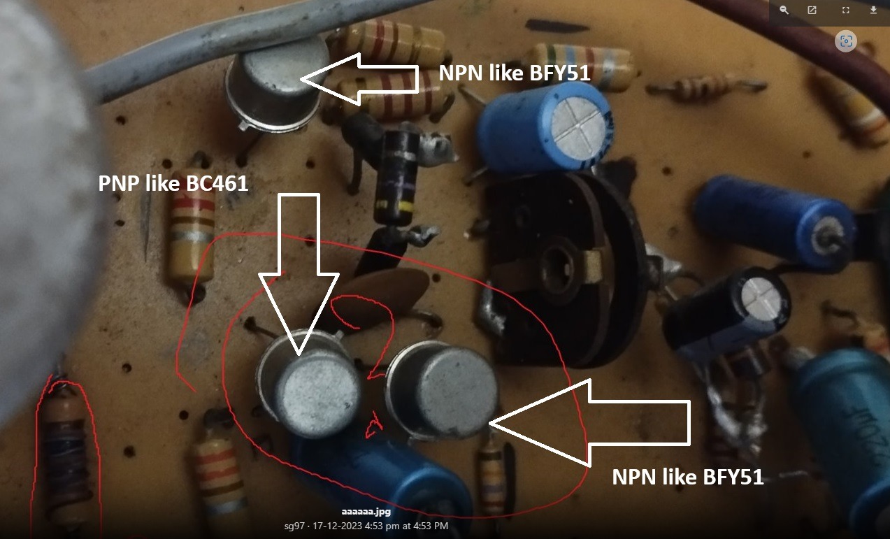

Those are transistors but you would need to identify whether they are npn or pnp type. They are likely something like BFY50 or BFY51 and BC461 type. They would be Q2 and Q4 in that typical amp circuit diagram.
I just think this is going to be outside your comfort zone tbh :) It is possible to tell which is NPN and which is PNP by simple measurement (as long as they are not shorted) and failing that by looking at the polarity of the supply voltages on them.

i dont know that xddd one of two transistors says only 2n3055 and second one does not have a label but i guess it is the same as the other one.
They most likely are the same but you need to be sure. Look at the diagram I posted. The metal can (the outside) of all those power transistors (and even the little ones) is the Collector. That is the upper connection in Q5 and Q6 in that diagram. If yours are configured like that those in the diagram they are both 2N3055's (highly likely).
If Q6 in that diagram was the other way around (the Collector to ground) it is not a 2N3055 but would be the PNP complement such as a 2N2955 (unlikely).
btw one questions how can i know what is emitter and collector in transistor ? its not labeled xdd it may sound stupid and it is xdd i really want to learn.
Look at a data sheet for the 2N3055 style transistor to see the connections. The metal case is always the collector.
The little metal ones, the case is the collector and will be connected to one of the thee leads, the base is the middle one and the emitter is where the little tab on the case is.
