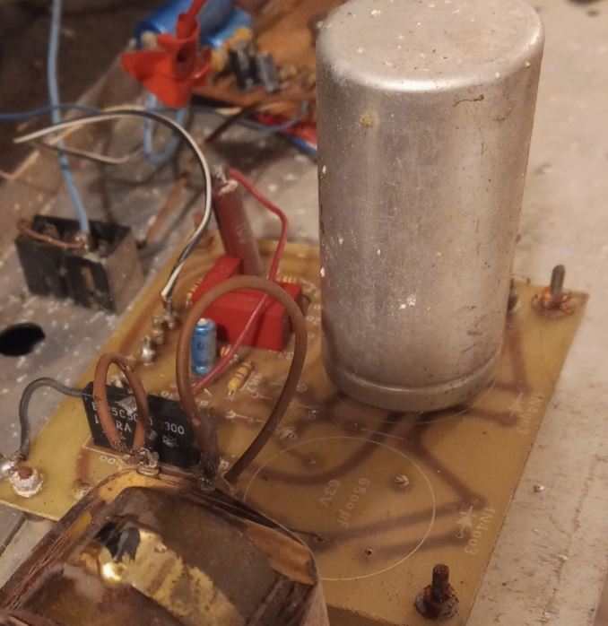

hi guys its me again :D i have one question, i have one amp that i got for cheap and i fixed it but i noticed it works on 24v. it is transistor amp on 2n 3055 what was a real option for it ? it works now ok on 24v but it is too low.someone replaced transformer previously and put that 24v one. btw if i put like 40v or 50v maybe its too much ? btw there was also a issue that there is no schematic or any info on internals so i have to guess everything xd
i found one of the pics from the seller of this amp this is a board for power supply
on the spot where one of two caps was supposed to go it says 63v i guess other one is the same but i will confirm it later.

Tbh on 24v its working good it was originally 150w it had 4 transistors 2 per board it came to me with only one board second was missing, also other two transistors are dead xdd fried actually thats why i think that board was removed. So the board thats here now working, had some minor damages but its ok in general amp is producing clean sounds. But i think transformer was replaced with one thats not even close to the original xd

Okay ... time for reality. If you have blown transistors, the remaining ones are stressed, period. They may fail at a later date without being pushed. That is factoid one.
What is the make and model please? You can run it at reduced voltages, but that will throw off the currents elsewhere in the amp and it will not perform well.
I bought a Yamaha PC-2002, and the moron pulled one blown output from each bank on one channel. That "fixed it". Well, I got it and not only does it fail spec for distortion (badly), but now having paid a decent price for it (much higher than it was worth given the condition). Now I have to rebuild it completely, including a matched set of new output transistors. I got ripped of because the earlier jerk ripped off the owner. Nice. My cost on outputs will be about $100, but higher since I have to buy more than I need to match them.
When people "fix" things, fixed means operating to spec. Not, just passing a signal. Otherwise the term "fixed" is a bald faced lie.
