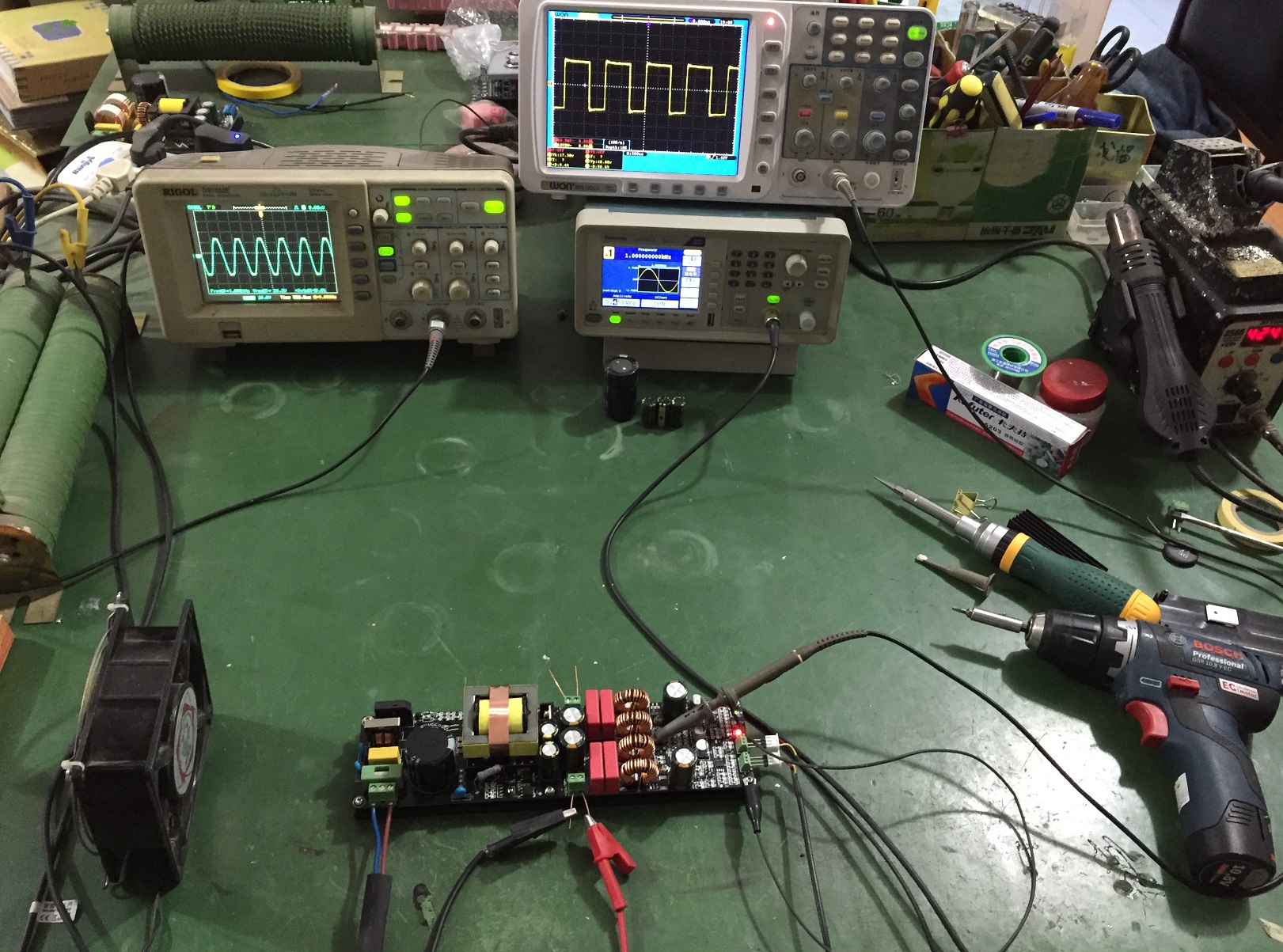

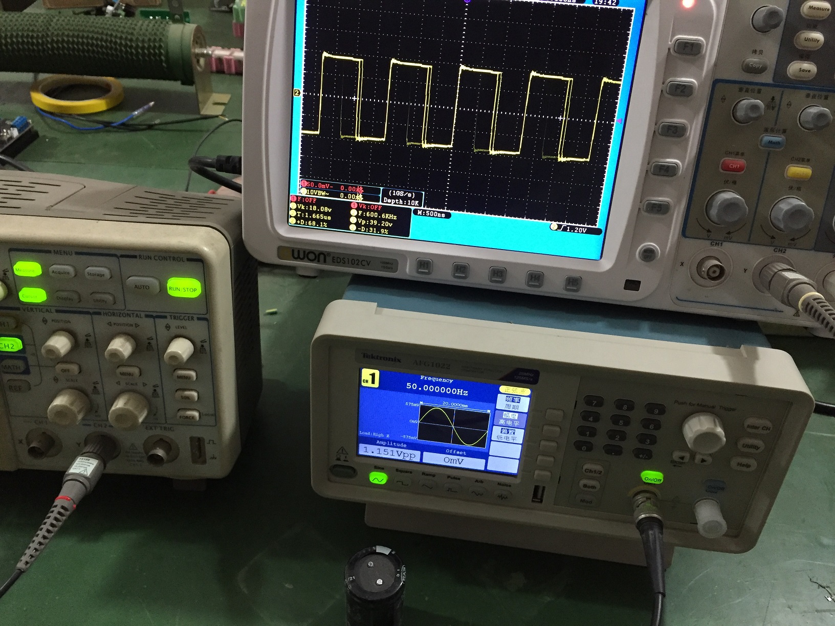

I compared the two amplifiers 50 Hz square wave. 8 Ω
I.AM.D V200
and SINEWAVE
what watts delivery out?
duty about 50%,no signal input?,no power out,
Peak to peak ~6V. 1.125 wattswhat watts delivery out?
I.AM.D V200
and SINEWAVE TPA3251

~1-2 watt. Peak to peak ~ 6Vwhat watts delivery out?
Yesduty about 50%

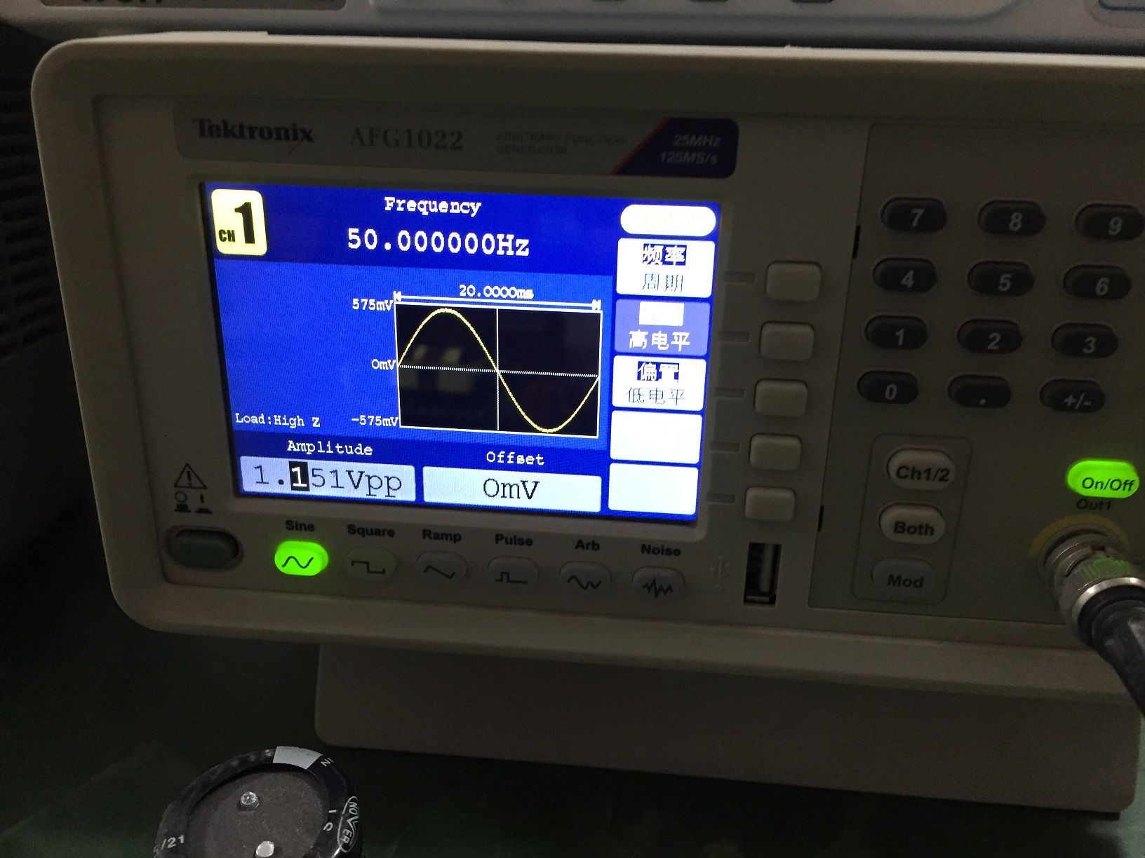

No. OK. I understood you. V200 input USB. TPA3251 - analogue. I can measure input meander only in the evening.,no signal input?

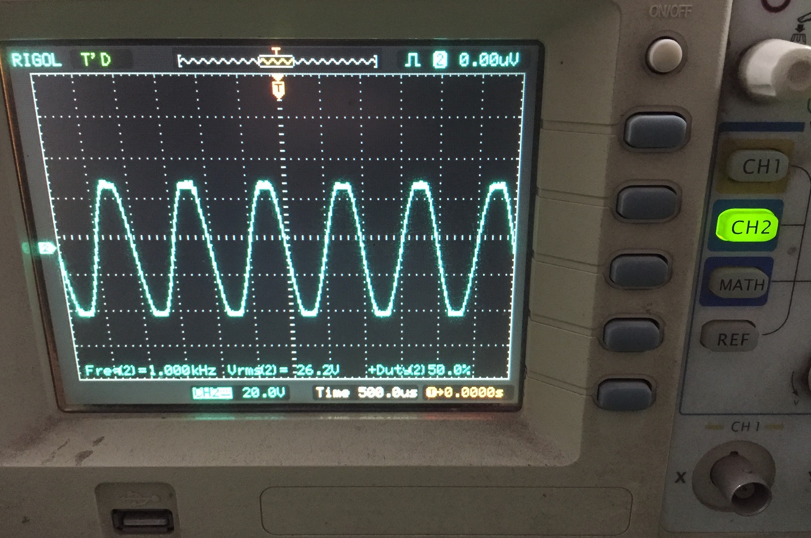

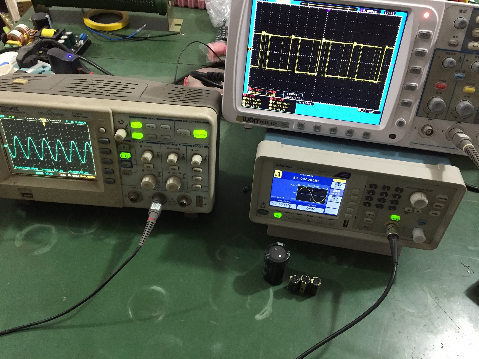

This is 1kHz sinewave, so a different story than 50hz square.

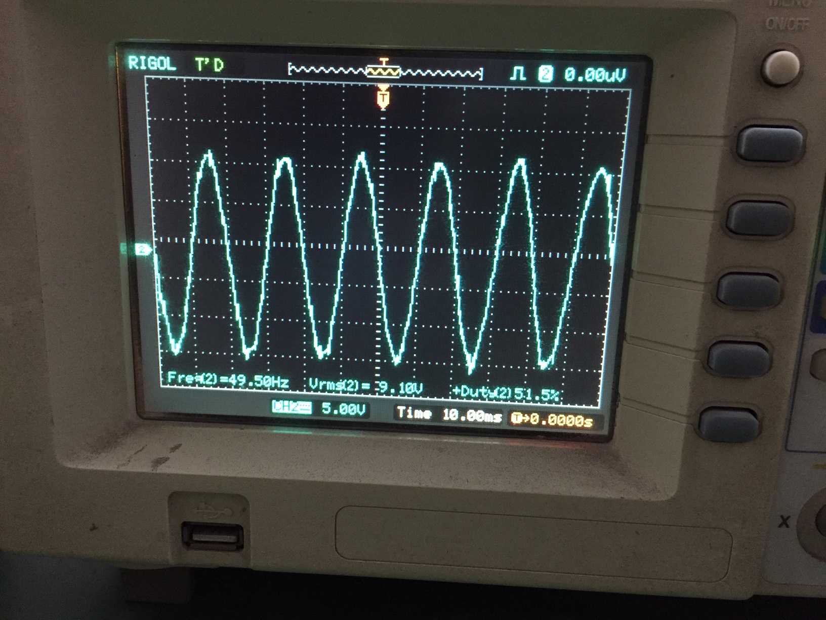

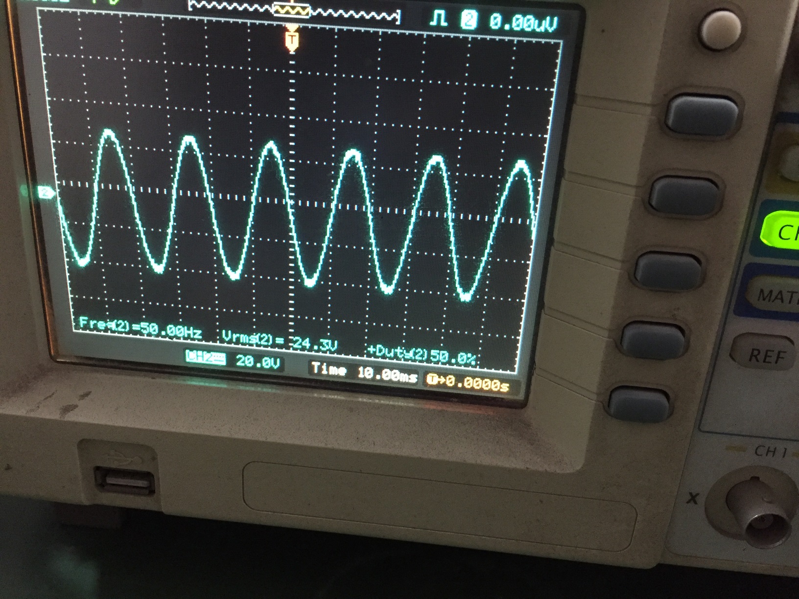

take more photos just now with 50Hz sinewave signal.
9Vrms@8ohm 50Hz sinewave
24Vrms@8ohm 50Hz sinwave

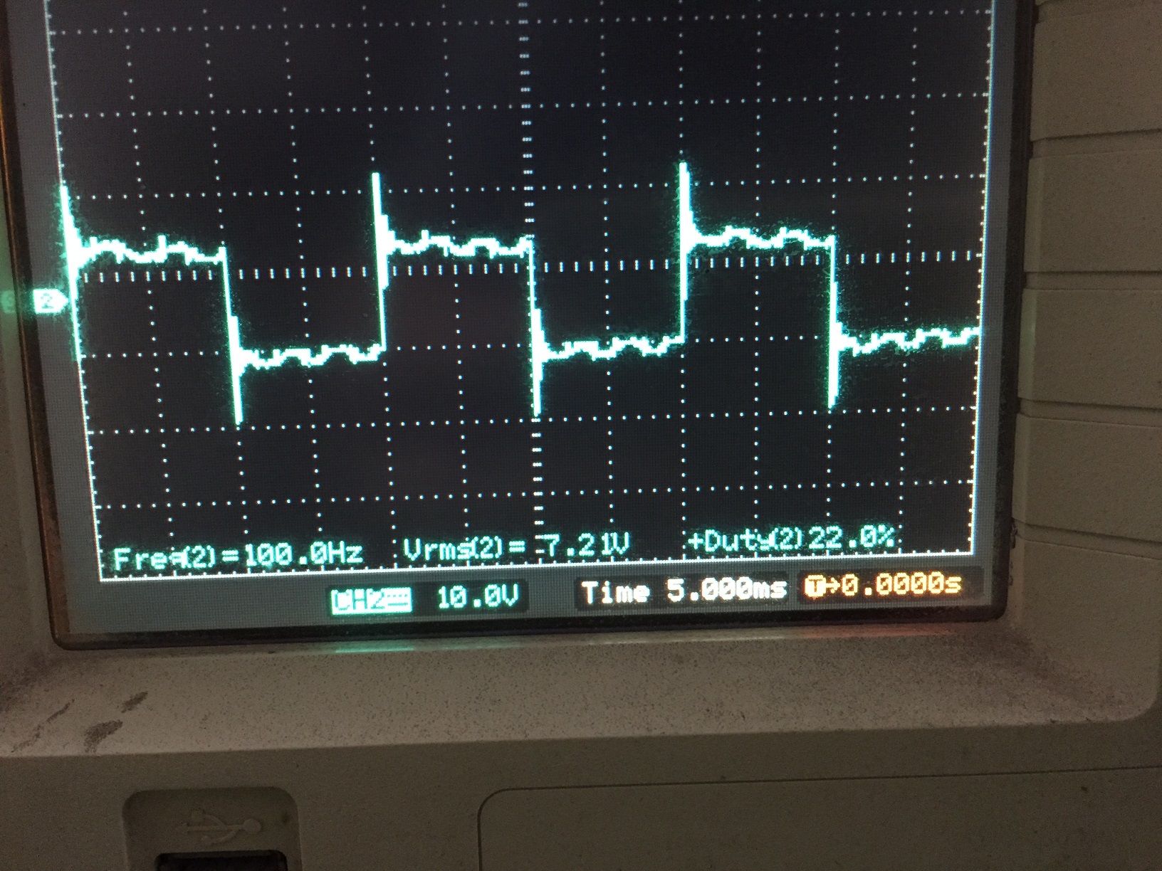

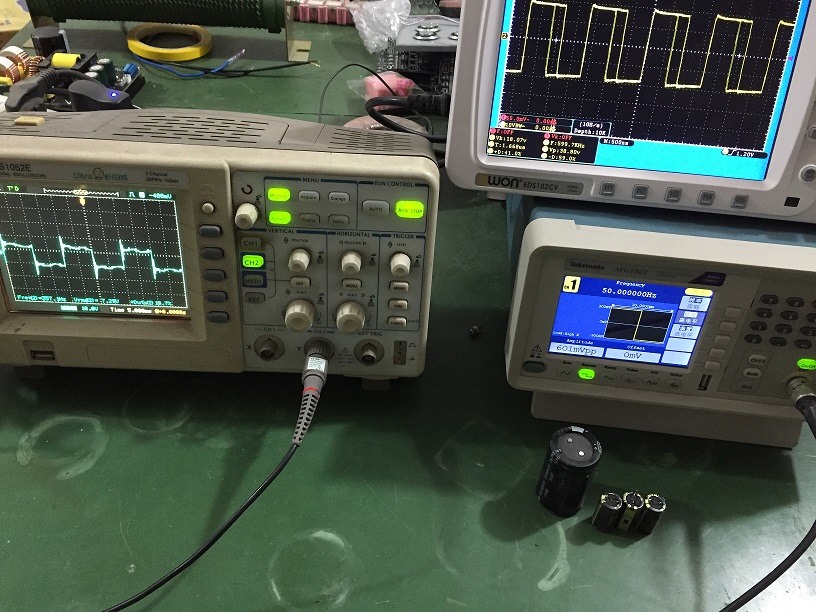

measuring audio amps with 50Hz squarewave is pure nonsense, just good for caps rollers.
Measuring 50 Hz square wave indirectly shows the lower frequency limit. If the square wave is flat, then the amplifier may sound ideally from 0 hz. If the square wave is not flat, then the problem is with the power supply or there is insufficient capacity or the coupling capacitor.
I have subjective a lack feelings of low frequencies.

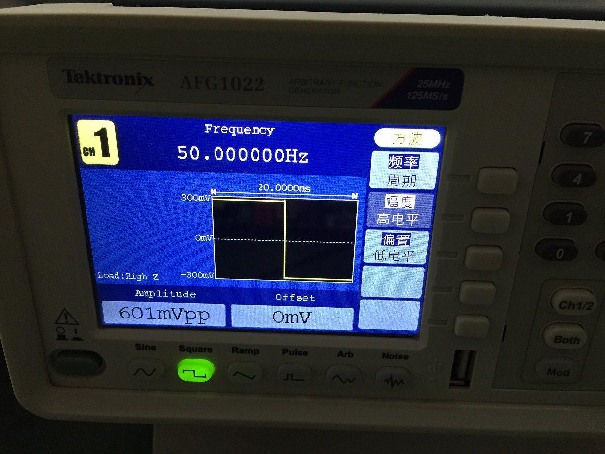

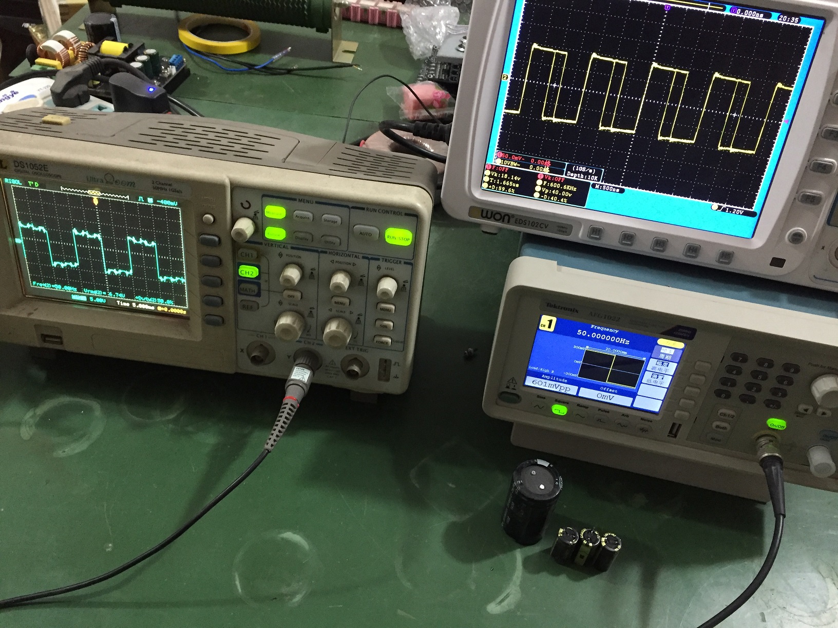

50Hz square photos, OSC display frequency error(show 100Hz) OSC calculate error, signal is 50Hz.
6.74V@8ohm 50Hz square wave
we found TPA3251 PSRR performance should not good, this mean that default feedback in the chip a bit small, this is the reason why this chip have wide frequency range response(100Khz)
You get a similar result. The top impulse is tapered.6.74V@8ohm 50Hz square wave
