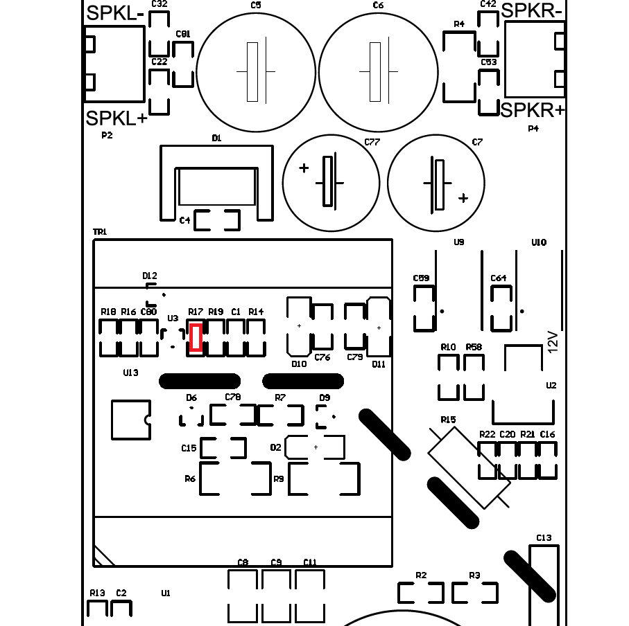

Hello,PPY, attach main DC voltage control circuit below, you can calculate the resister value you need,
PVDD=2.5(1+R14/R17)
R14 and R17 position under the transofrmer, you can solder out the trasformer and change its value.
Default value :
PVDD=35V,R14=20K, R17=1K5
PVDD=32V,R14=17K7, R17=1K5
you can use R14=18K,R17=1K5, PVDD=32.5V
About bigger capacitor, you can change the C5 ,C6 with bigger LOW ESR version, default is 2200uf/50V.

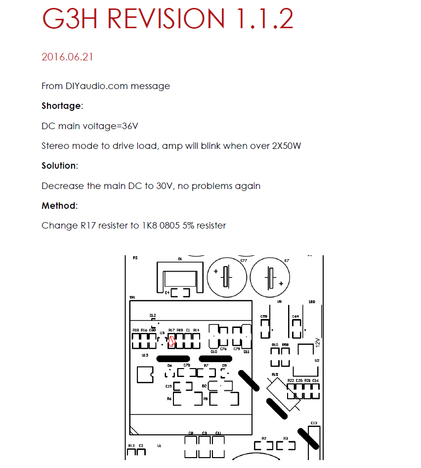

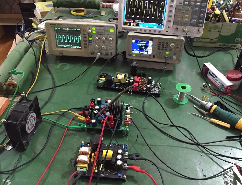

hello ,ppy, about DC voltage, we use seperate SMPS with EVM board test again this morning,lucky we found main DC voltae 30V works well, because we have 30V/600W SMPS aside, we use it drive EVM board, test stereo mode works well, not like 36Vdc ,
so we change R17 value to 1K8, main dc is 30V, test G3H with stereo mode, no blink again, it same all ok now.
I think TPA3251 easy protection under 36V main dc conditions,add lower voltage should okay.
I recommand to change the R17 to 1K8.
THANKS!

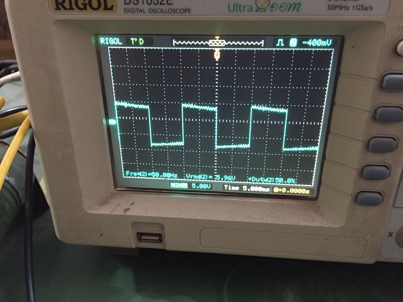

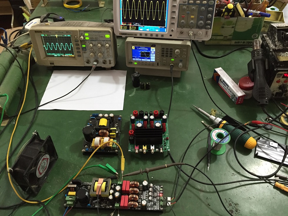

TPA3251 evm BOARD SQUARE WAVE PHOTO
we usse seprate SMPS this morning, and drive the EVM board, add 50Hz square wave, load is 4ohm resister,main dc 30v
output wave below, can you clear all the details to us about this EVM circuit?
TKS!
TKS!

we change R17 value to 1K8, main dc is 30V, test G3H with stereo mode, no blink again.
About transformer temperature, most of case is shielding cooper tape high temperature, the tape functions is sheilding the
magnetic flux leakage,EC core tempearture increasing very slow.it should no problems for this amp apply.

R17 resister position, below the transformer, red block.

Revision documnet below, please download and revise the module, sorry for the inconvenience.
3) This amp support one by one channel testing, not support double channels high load same time, maybe chip small and temperature protection occur, so we find blink when stereo high load, but alone channel testing no problems, it can delivery out high power.
That's strange, as the chip is proven to drive full continuous output power into 4R in stereo. I test it several times with a 38V supply for infinite time. 2x140W, no problems whatsoever..
With 30V supply you won't reach the stated 2x140W anymore. (Estimated 95W at 1% with 30V)
