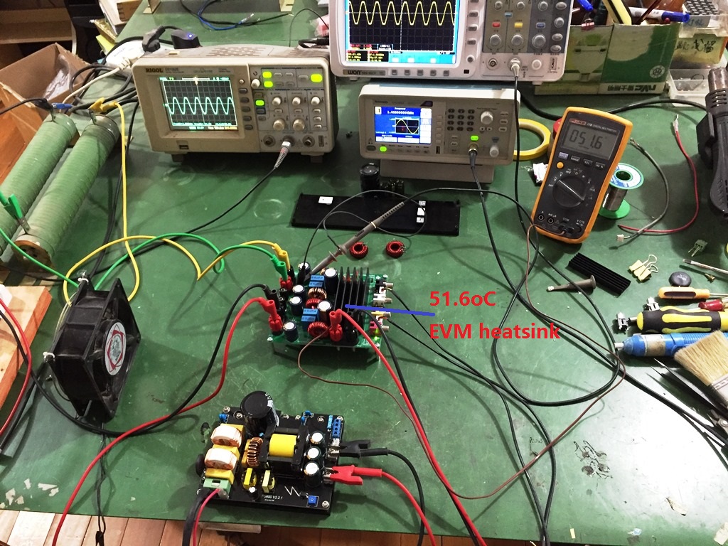

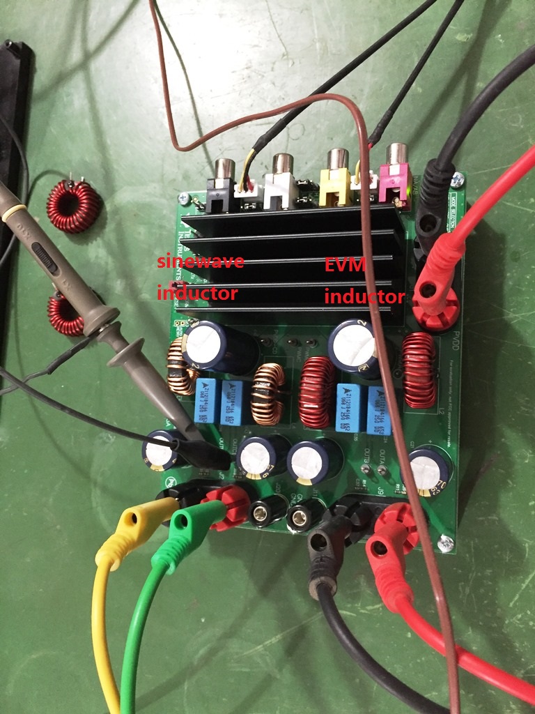

Sinewave inductor have better temperature performance

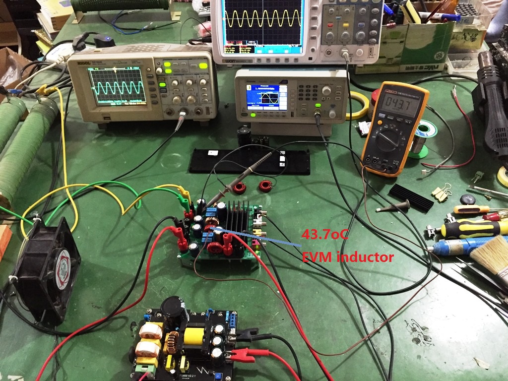

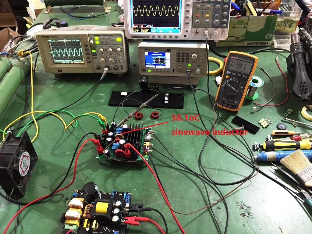

we compare the two inductors again this morning, our inductor have lower fever indeed, we use FLUKE 17B multimeter to test. this multimeter have higher accuracy temperature than IR thermometer.
Sinewave inductor have smaller size

What about a THD vs frequency and THD vs output power plot? Comparing the inductors only for idle temp doesn't say anything about "sound quality".

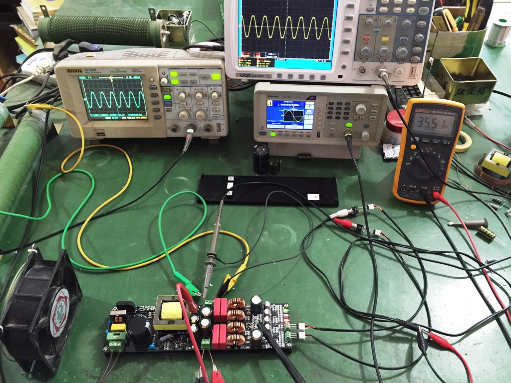

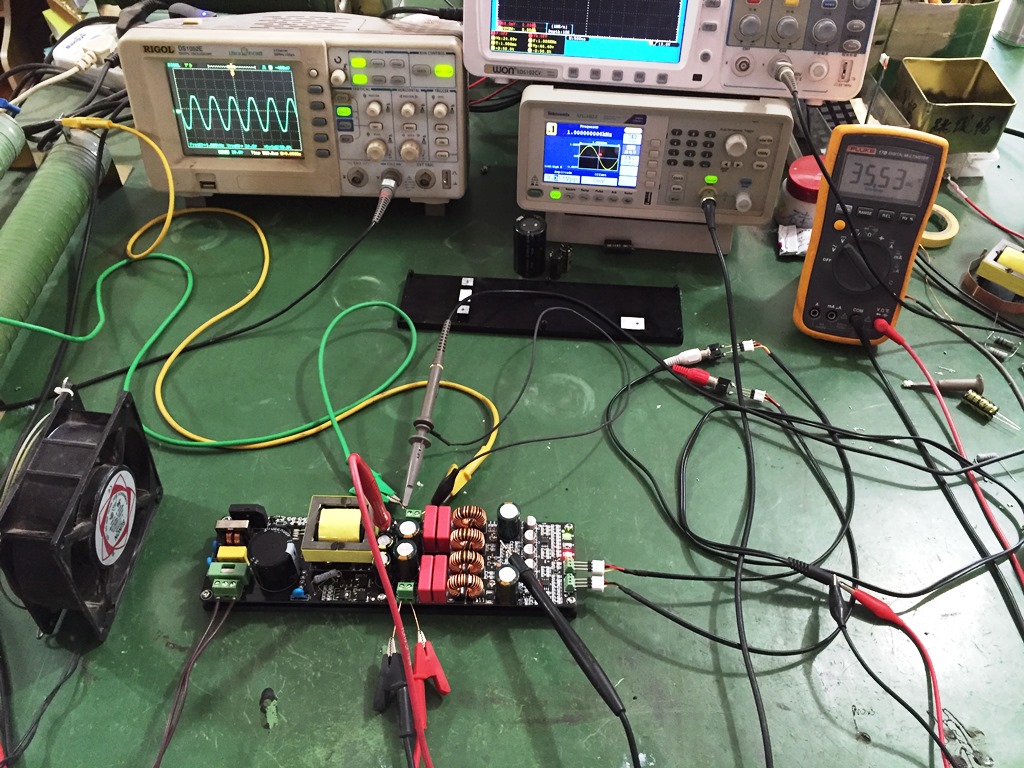

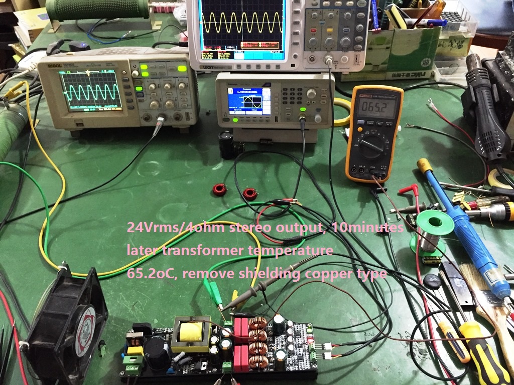

continous sinewave signal testing, transformer EE core temperature 65.2oC
it is 24V/4ohm and 2channel output, 288W power out, 10minutes later temperature value
never worry about inductor staturation,from the output sinewave signal, you can find the THD+N performance if you have enough experience , it is same, or not one channel have burr or raised。

hello ,ppy, about DC voltage, we use seperate SMPS with EVM board test again this morning,lucky we found main DC voltae 30V works well, because we have 30V/600W SMPS aside, we use it drive EVM board, test stereo mode works well, not like 36Vdc ,
so we change R17 value to 1K8, main dc is 30V, test G3H with stereo mode, no blink again, it same all ok now.
I think TPA3251 easy protection under 36V main dc conditions,add lower voltage should okay.
I recommand to change the R17 to 1K8.

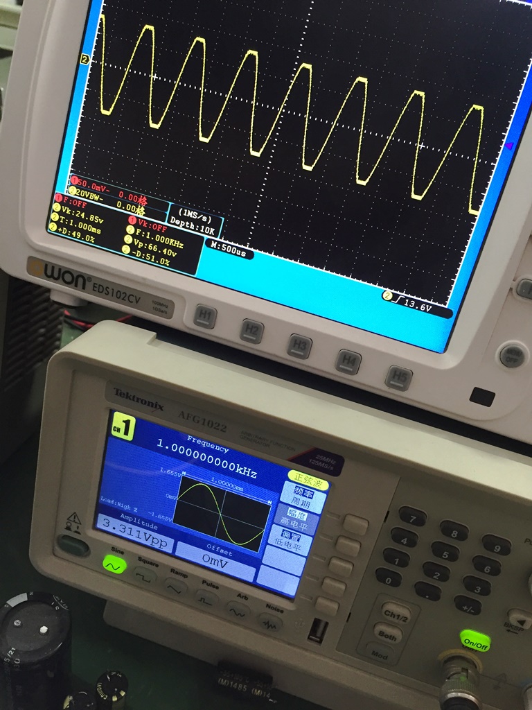

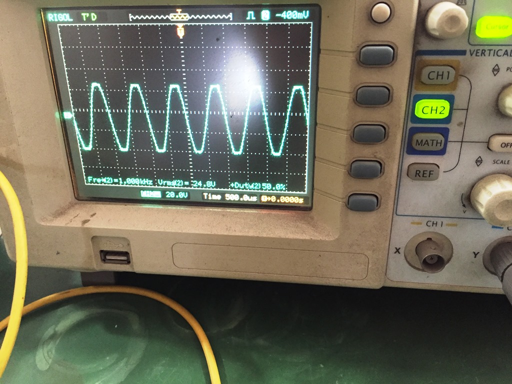

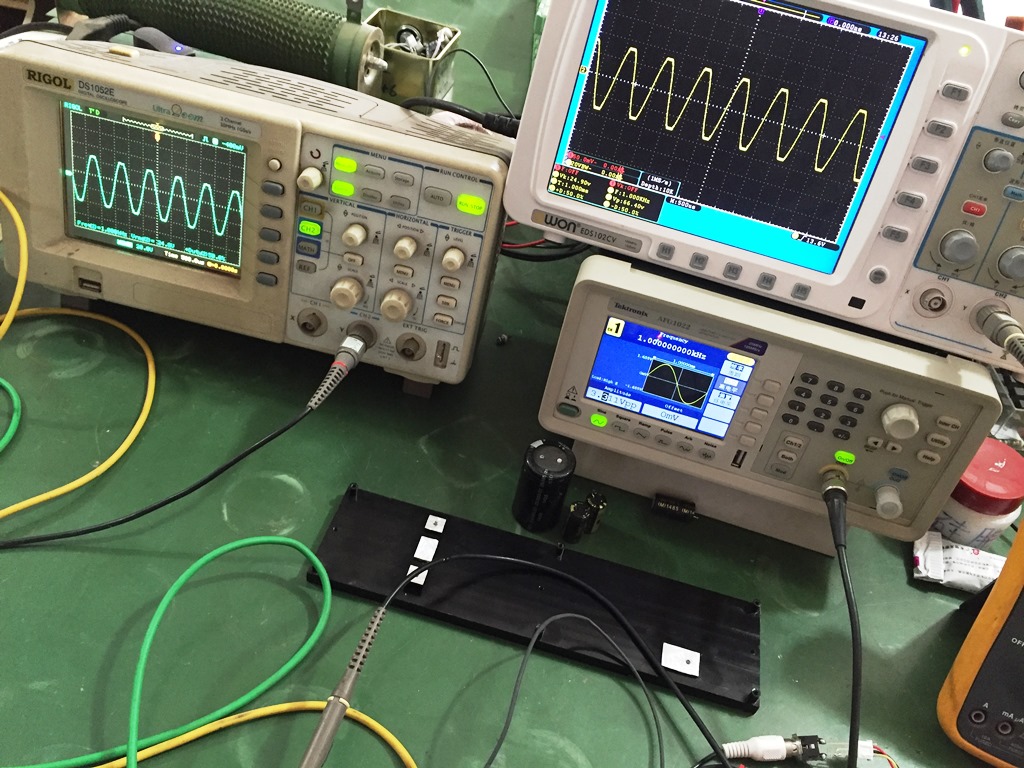

Lucky , we have good result today, we found our G3H module auxiliary power swings when power output over 200W loader.
We find more way to optimized the transformer , some discrete parameters need to be adjusted, and get good result now.
Pvdd=35.6V
Load=2x4ohm/500W resister
Signal=1Khz sinewave
Test reslut:
Vout=24.8Vrms 20 minutes no problem
Vout=25.4Vrms 5minutes no problem
Vout=25.6Vrms 1minutes AMP will hickup, led blink
Calculation
Vout=24.8Vrms Pout=153.76W, Ptotal=307.52W
Vout=25.4Vrms Pout=161.29W, Ptotal=322.58W
Vout=25.6Vrms Pout=163.84W Ptotal=327.68W
