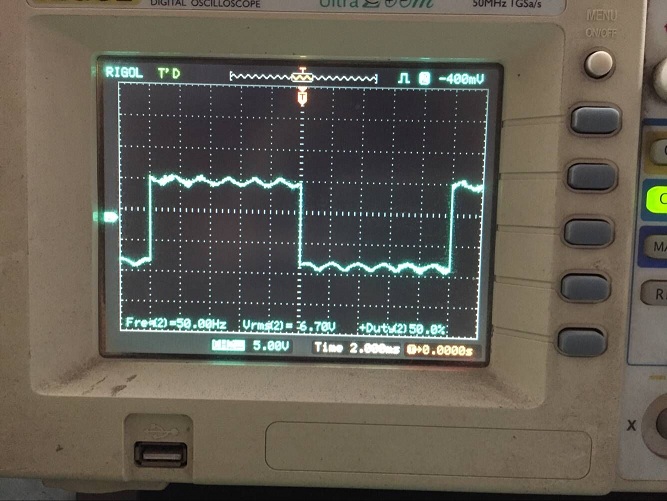

Thank you for your suggestions, all the 4 units coupling cap value are 10uf/50v/X7R, c36/c37/c39/c40, chang it's value to 100u/16V/X7R , test photo below.

Measuring 50 Hz square wave indirectly shows the lower frequency limit. If the square wave is flat, then the amplifier may sound ideally from 0 hz. If the square wave is not flat, then the problem is with the power supply or there is insufficient capacity or the coupling capacitor.
I have subjective a lack feelings of low frequencies.
Certainly a 50Hz square shows low frequency rolloff. But the slope measured indicates a corner frequency definitely below 10Hz, maybe 3..5Hz. Ridicolously low anyway, nothing relevant to audible bass response. Who told you that a perfect square of 50Hz is relevant to audio quality?

I'm not saying that it is the truth. I have only subjective opinion. Amplifier V200, with a flat meander produces and good bass. In TPA3251 bass is not enough. I do not know how to solve the problem. Therefore, I am looking for different ways. Power supply, continuous capacitors, high output impedance of the bad inductors....
Probably need a set of measures for good efficiency at low frequencies.
