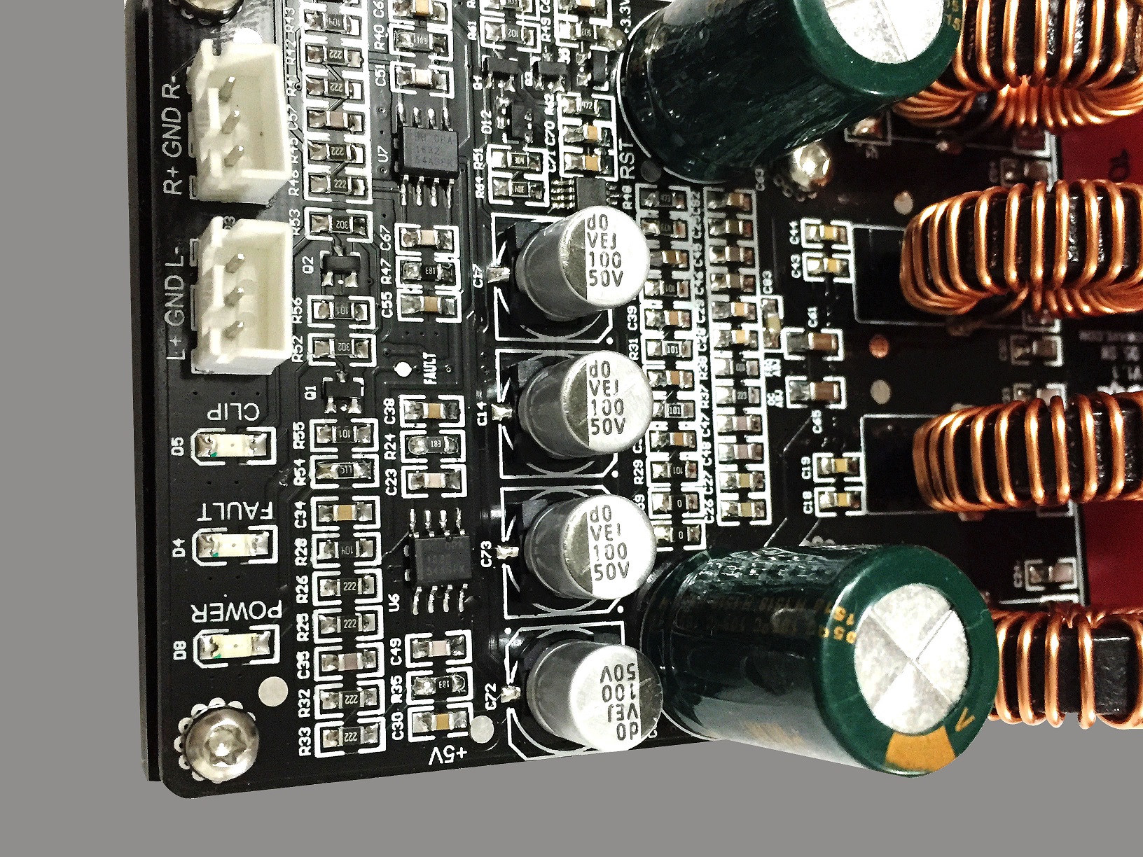

Sinewave TPA3251 module
During the week Sinewave TPA3251 module arrived. Today I started to running it and drove it via my RME Babyface (XLR line out) @ JBL Ti5000. When I played music rather loud, sound broke down and the fault LED was blinking. After this experience I measured output power @ 4 Ohm resistors. 50W ongoing is no problem, but when you increase output power to 100W it breaks down after (very) few seconds and fault LED is blinking. The transformer is getting very hot after short time - around 75°C. My assumption is after this first test that the SMPS is too weak to achieve 2*140W.
Regarding sound quality I need to have more tests, first impression was quite good.

I also got from Sinewave TPA3251 module. Build quality and soldering is very poor. Flux is not washed, burn isolation on the electrolytic capacitors from the soldering iron.
But the sound quality is satisfied.

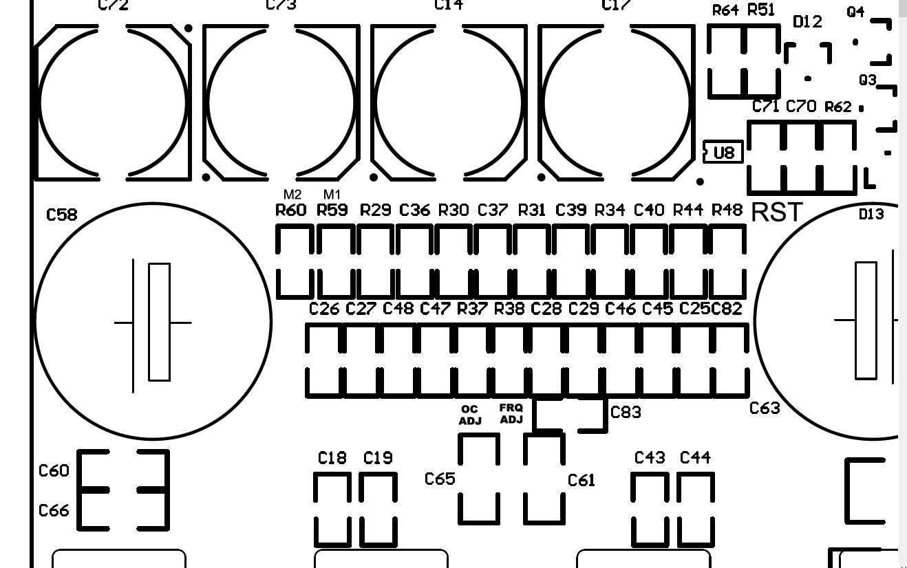

Hello,Manfred, sorry for the later reply, we are enjoy our holiday and come back office today.
About your test questions, it is TPA3251 chip over current occur , SMPS no problems.
We test it one by one channel with 4ohm loader, it can delivery out enough contonous power,1x140W/4ohm.
if you test it with continous power and stereo mode, please add 1/8 power level, 2X20W/4ohm enough.
It is TPA3251 chip setting , if you want to add more continous power under stereo, you can change the OC setting resister on the board,
Attach photos below, please check it, R37 is the current set resister, default value is 22K.

Hello, PPY, sorry for the delay reply, we come back office from our holiday today.
First batch G3H modules are hand soldering by our skilled workers from produce line, solder quanlity better, only shape not good than SMT line .
manufacture cost is very high, but quanlity better,aim to get better reply.🙂
All the module pass our ultrasonic cleaning line after soldering, if you find some point traces of soldering on the PCB,it is our testing position recheck traces.we will improve this circle and set recleaning circle after recheck.
Of course, if your feeling not good, please return it to us, we will replace new or refund money.
First batch module cost very very high, due to so many human cost, sure the performance good, of course more good advices, more better products provide

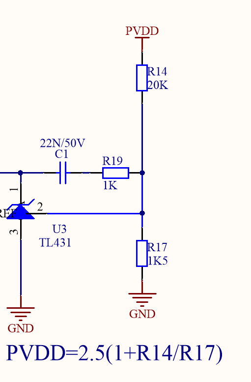

Hello,PPY, attach main DC voltage control circuit below, you can calculate the resister value you need,
PVDD=2.5(1+R14/R17)
R14 and R17 position under the transofrmer, you can solder out the trasformer and change its value.
Default value :
PVDD=35V,R14=20K, R17=1K5
PVDD=32V,R14=17K7, R17=1K5
you can use R14=18K,R17=1K5, PVDD=32.5V
About bigger capacitor, you can change the C5 ,C6 with bigger LOW ESR version, default is 2200uf/50V.
