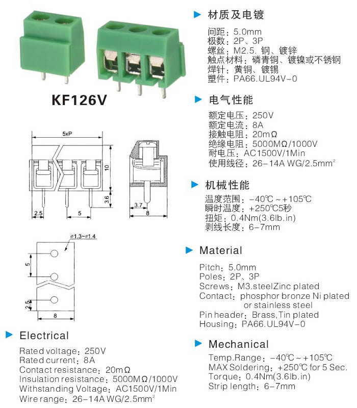

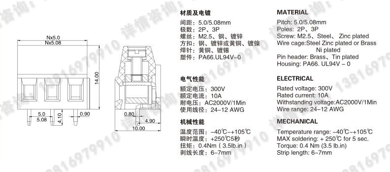

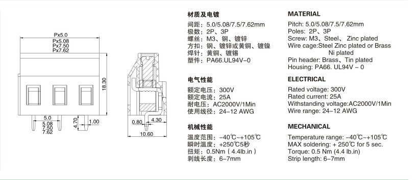

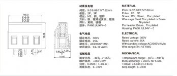

OH!these connectors from one factory in China,they have same hole distance (5.08mm) ,same pin size. this serie have three type126/ 128/ 129 ,they have different rated current, all type can use 2.5mm^2 wire.
factory link : http://en.cnkefa.com/products_list.html

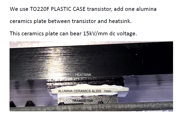

nice build, but I expect problems when putting this onto the european market.
If the customs consider your module being an "apparatus" you will be required to put a CE mark on it.
And with a module with a connection to ac mains you might struggle with safety issues, for instance:
-do you provide safety instructions to the customer?
-obviously some primary power device is mounted onto the alu block: Does this provide double or reinforced insulation?
-If some secondary device is mounted on the same block, you probably will have a problem.

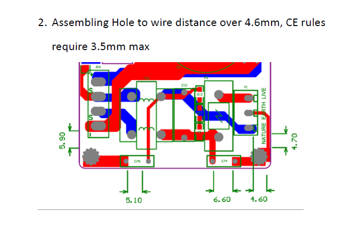

-Creeping distance at pcb-side of the terminal block between PE and N/L looks insufficient.
and I expect more problems to come not visible on the fotos.
There is little chance that european authorities can sue you, but if the customs confiscate your products not complying with the regulations this can ruin your business as well.

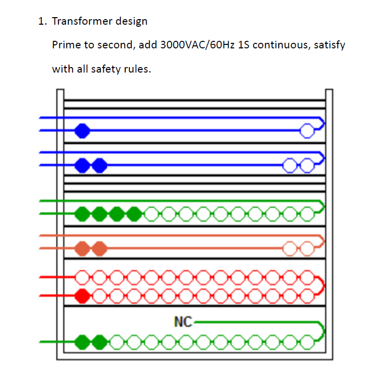

Attach files here we make just now, you can find the result,
First,there is 6mm distance from PCB bottom to heasink overlayer,about transistor to hetsink, we use alumina ceramics AL203 plate as high voltage isolation and heat dissipation media, it is reinforced insulation
Second transformer isolation good
Third AC filter unit safty margin over 4.6mm
all the safty rules testing no problems in Euro.
Welcome to receive more questions with this modules, it is new products, we are satify with current version performance , please help us to make it better, TKS!

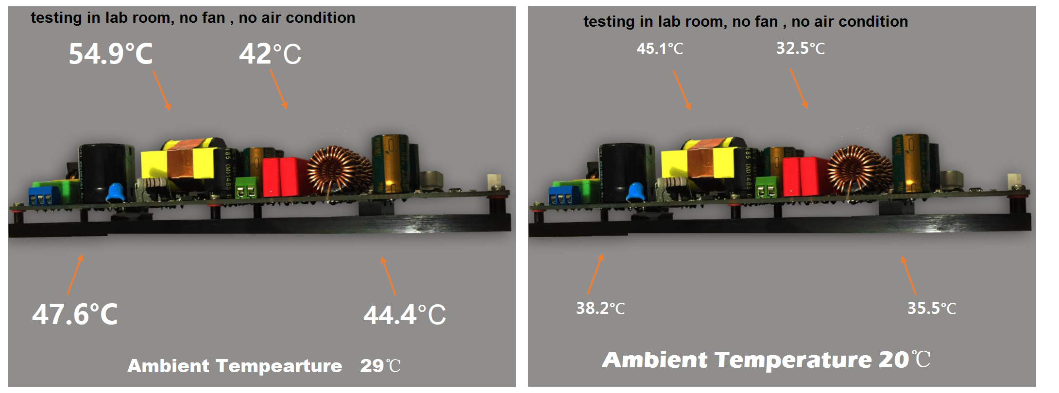

Recommand to assemble the module to more bigger heatsink under full loader runing, of course fan cooling system added no problems.
Because TPA3251 run at 600KHz, idle loss bigger than lower frequency amplifier, but we use one 15mm thickness good quality aluminum plate and pass mlling machining , so the heat dissipation performance well,only feel warmer
Crrent room temperature 29°C,24hours temperature value show in the picture below:
Today ,heavy rain and room temparature down to 20°C, test current temperature value.
