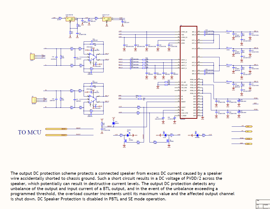

Share our G3H amp unit schematic,altium designer file type.

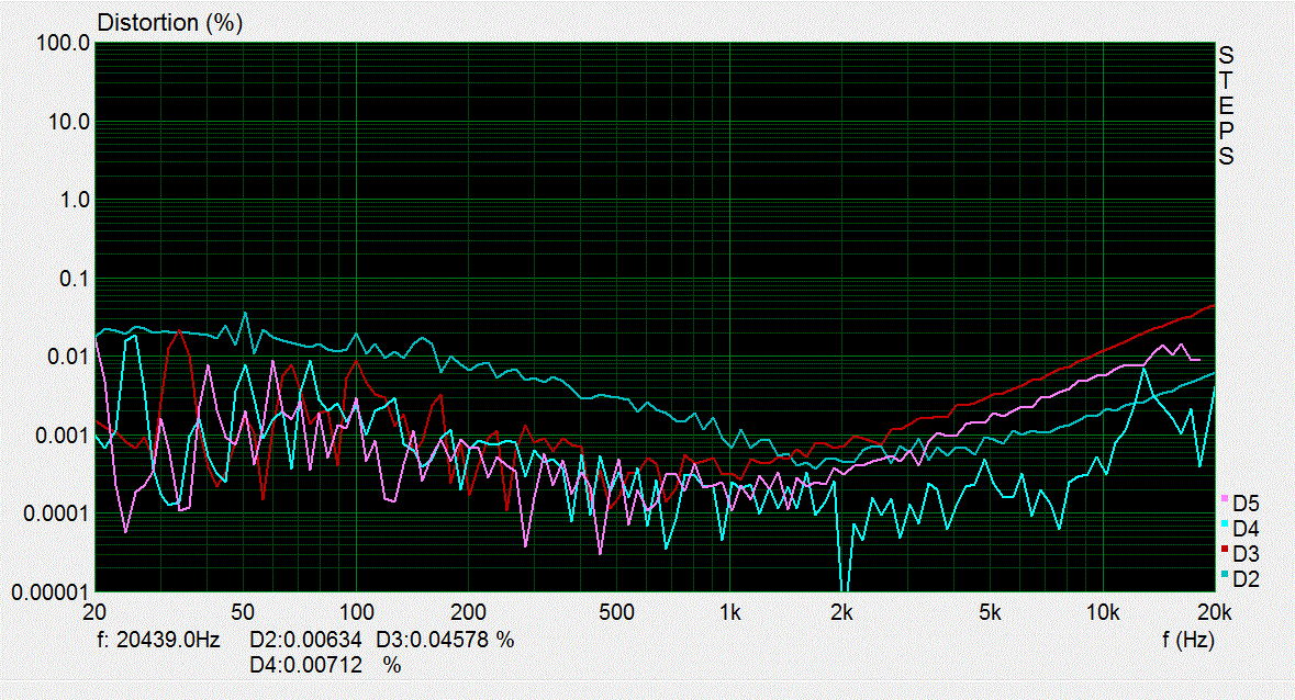

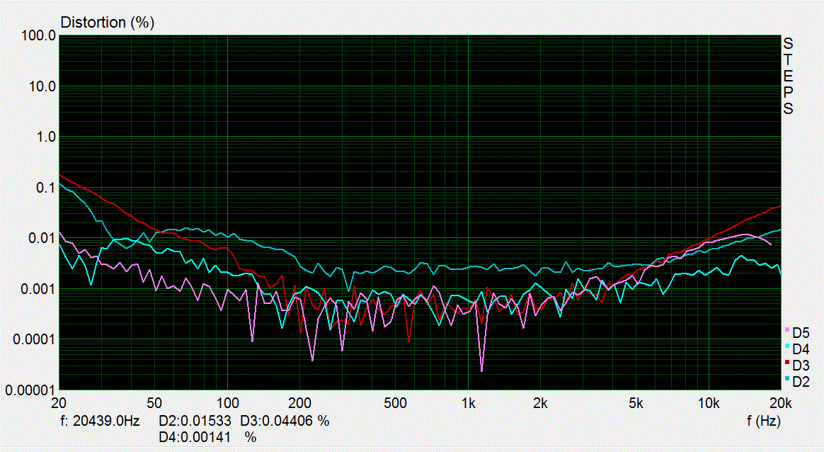

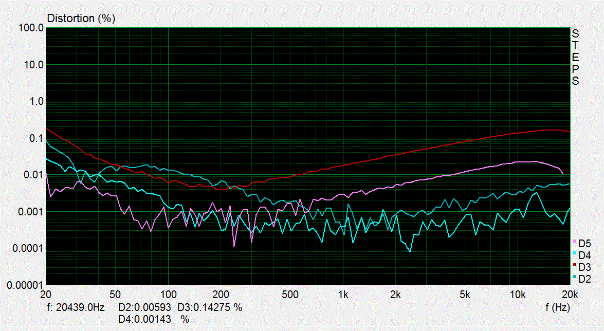

Measurements for 2 different inductors at 2.83V into 4R7:
MSS1278:
attachment.php
And Ice inductors:
attachment.php
These measurements where provided by 5th element. In the end, with substitution of some ceramics for wet electrolytics and ice inductors, it went like this:
attachment.php
From the plots you can see, that core material/inductor construction highly affects thd performance. Changing ceramics for wet electrolytics or foil improves performance in the low frequency range (<200Hz), you will have to decide for yourself if you need ultra low THD for lf/bass.

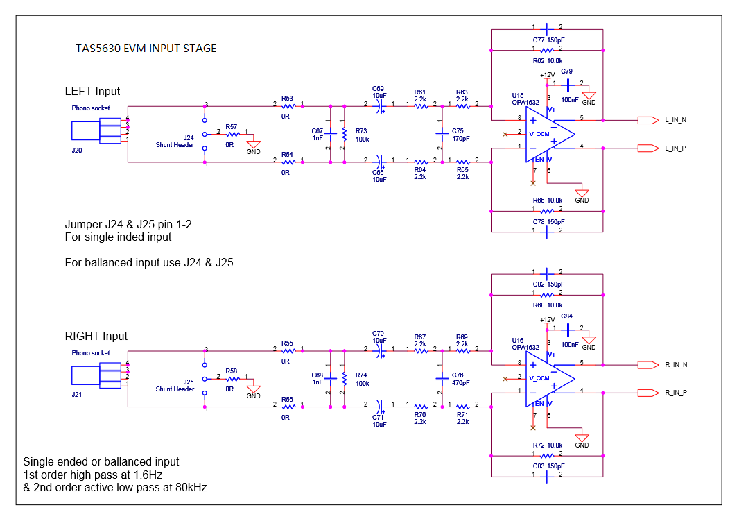

Small critique: If you're using a fully differential amplifier like the OPA1632 for single ended to differential conversion, you need to ensure the input impedance of the source is balanced. Otherwise CMRR will be poor, and a common mode DC offset on the input of the amplifier will cause a DC offset on the amplifier output. See pages 19-20 of this appnote:
http://www.ti.com/lit/an/sloa054d/sloa054d.pdf
You can't depend on the customer to keep the input impedance balanced if they're using a single ended source, and especially if they do something like put a volume pot between their source and the map.
I solved this on my "Wiener Pro" card using a fully differential instrumentation amp design, which handles unbalanced input impedance well and provides good CMRR. If you use this circuit, shove "thanks gmarsh" somewhere on a copper or silkscreen layer 😉
A couple other design options would be to use a dual op amp for each input (one used as a "classical" differential amplifier, and one inverting amplifier), or stick with a single ended input and use a DRV134 or something.

Appreciate your idea, we reference the TI tas5630 EVM circuit and improve it to use double DC power supp(v+/v-), our input stage performance should better than tas5630 EVM input stage.
TAS5630PHD ???? - TAS5630PHD2EVM - ???? TI ?????
But you idea good, we are plan to add this circuit in the new board and mark your name,thank you for your efforts.
We have to clear again, this module have very good S/N value, 110dB, you can not hear anything after power on!!!

TKS,
This circuit so simple, no need to copy from others, even Dr.Mord's works well in this circuit .you can check it , if find anything, please mail us. we have not read the whole thread, only find this thread and reply here with our new design.
Coincidence, some of our colleagues have time and like class D Hi-Fi, they have complete this modules for a long time, current version is v1.1.1, revised three times,
some days ago, we ordered TPA3251 EVM board and test it , find some bugs, so we revise the circuit and add additional circuit.
EVM bugs:
1) AMP shutdown and latched when protection occur, you must reset it again.
2) amp run under poor protection when set chip as SE or PBTL mode, only BTL mode have better protection.
With our experiences, use iron powder ring sound performance better than ferrite core, because ferrite core easy to saturate
the reason to use ferrite core is:
First, ferrite core have better EMI shielding performance than iron powder core, little influence to the other equipment, like radio and high sensitivity products.
Second, some Ferrite core cheap than iron powder core.
It is easy to check the magnetic saturation curve for the different magnetic materials online.
These are no bugs but features and well described in the datasheet.
Self-clearing error behavior is not what everyone's want/need and may result in a self destructive loop if secondary protection don't kick in. (Worst case)
