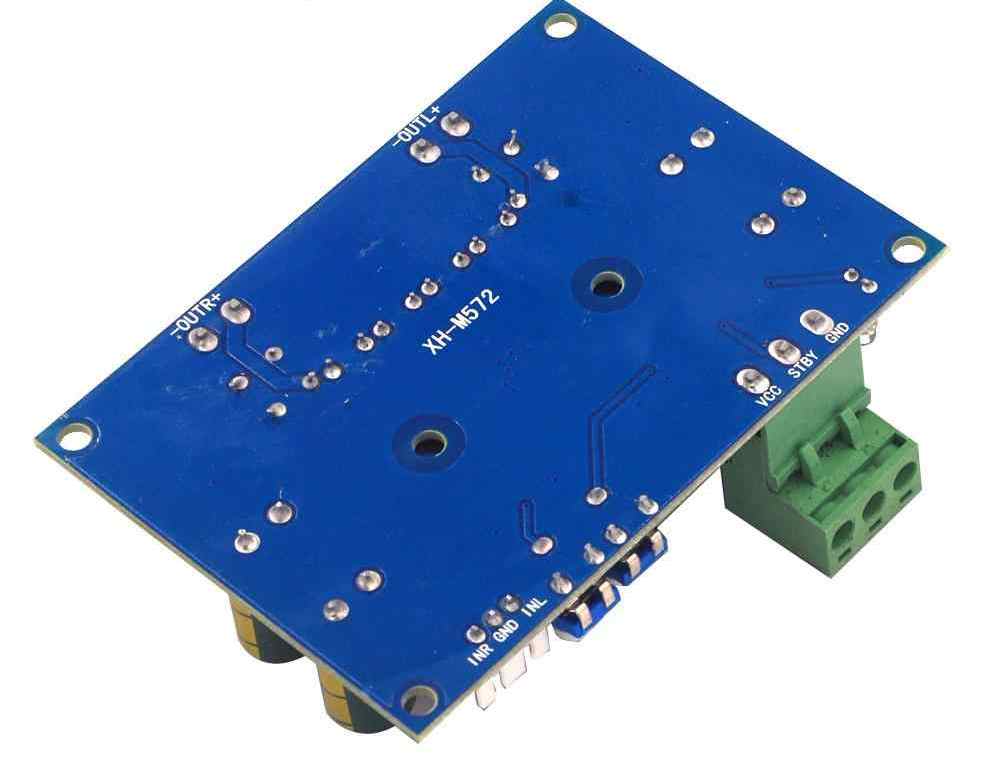

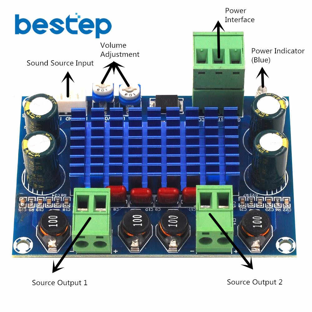

Total noob here...
I'm about to assemble my very first amp. My objective is to try and make a decent and CHEAP amp while my main amp is out for repairs. The board (XH M572 - see pic) is built around the TPA3116D2 chip.
It should be delivered in a few days along with the connectors (speaker, RCA, power). I intend to power it with a laptop power supply I have lying around (12V, I think). While I was researching on how to go about this, I came across some issues that I hope you guys can help me with.
1. I intend to house it in a wood cigar box which I already have. Should I line it with aluminum foil/copper/etc. as some threads suggest (with differing opinions on what material to use, of course)? I happen to have some aluminum tape. If this is advisable, should I line the entire interior (bottom, sides, top) of the wood box?
2. Internal Wiring (Power) - Can I use 1.6mm/16AWG Solid Copper Wire (THHN) to connect the board to the power supply socket?
3. Internal Wiring (Signal Input) - The board comes with a 3p Audio Cable (R+, L+, Common Ground). As I will be using Female RCA Jacks/Connectors, I intend to cut off the connector on one end of the cable to solder directly to the jacks. The R+ and L+ shouldn't be a problem. What's the best way to to connect the ground (as I will only have one wire). Can I just run a wire to connect both grounds and solder said wire to the exposed end of the 3p cable?
By the way, I intend to use CAT5e cable for this. how many twisted pairs would be recommended?
4. Internal Wiring (Speaker Output) - I again intend to use CAT5e cable for this. how many pairs is recommended? Or would I be better off with using speaker cables instead? I also have some THHN Electrical wire. Would that be suitable to use as well?
Again, apologies for my noobish questions. I know I shouldn't expect much from this project with the money I've put in (I'm around $12 into it) but I really want to get it right the first time.
P.S. I intend to get a better power supply if I get the amp to work right. Aside from the power supply, would replacing any components on the board itself yield improvements in the sound?
Attached are pictures of the board I'm using..

Total noob here...
Most start like that.🙂
Seems OK.
Laptop supplies are often 19V and that is fine for the TPA3116.
If you can make a conductive lining where all parts of the lining are electrically connected together it leaves you the possibility of shielding. Shielding may improve noise performance and reduce EMI.
Yes, if you can manage to drag the rather thick wire around in your box and solder it to the terminals.
I do not understand. A sketch?
CAT5e cable is not particularly suited. Can you get your hands on audio cable - 2 wires with shield?
CAT5e cable is not suited for speaker use. Use speaker wire.
Clever to ask (and read) before doing.😉
Listen to advise from others. I have no experience with that board. Add some power-line decoupling capacitance.
