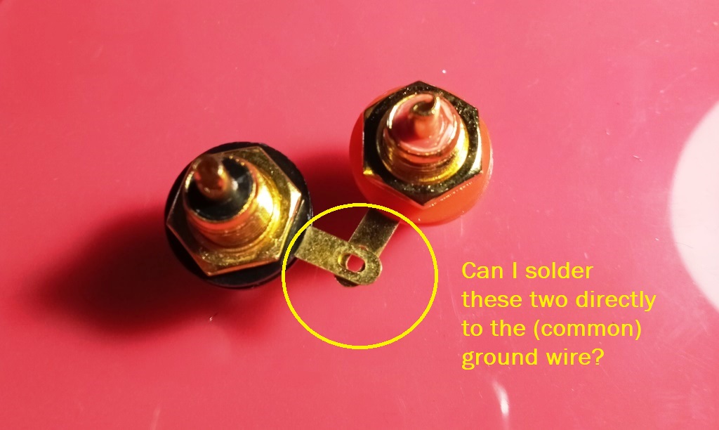

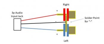

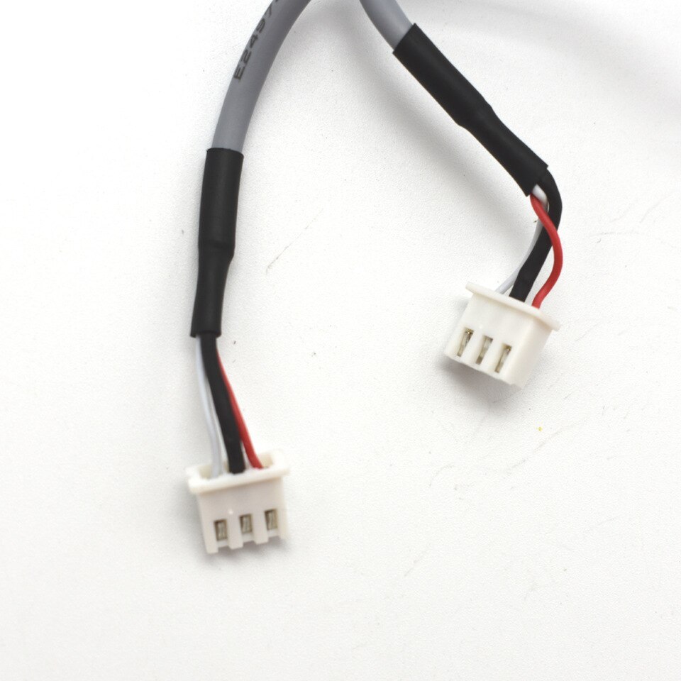

Quick question... Since the board has only 3 leads for signal input (L, R, Ground) and I'll be needing 4 (L, L Ground, R, R Ground), would it be OK to just use one wire for both L Ground and R Ground and solder said wire directly to the Ground terminal of both RCA jacks? Attached are pics for reference.

For input only shielded wire is suitable to avoid noise pickup. Either single shielded wire (coax), or two wires (stereo). Actually shielded CAT5 would do, but it is quite rare to have. If I could choose I would use separate coax for each channel.

You can not only do it like this, it is the best way to ground the inputs!
If you use two ground wires, they form a loop the moment you plug in the source. This will catch all kind of noise inside the amp, mostly hum. As it is in the input, even very small induced voltages will be fully amplified.

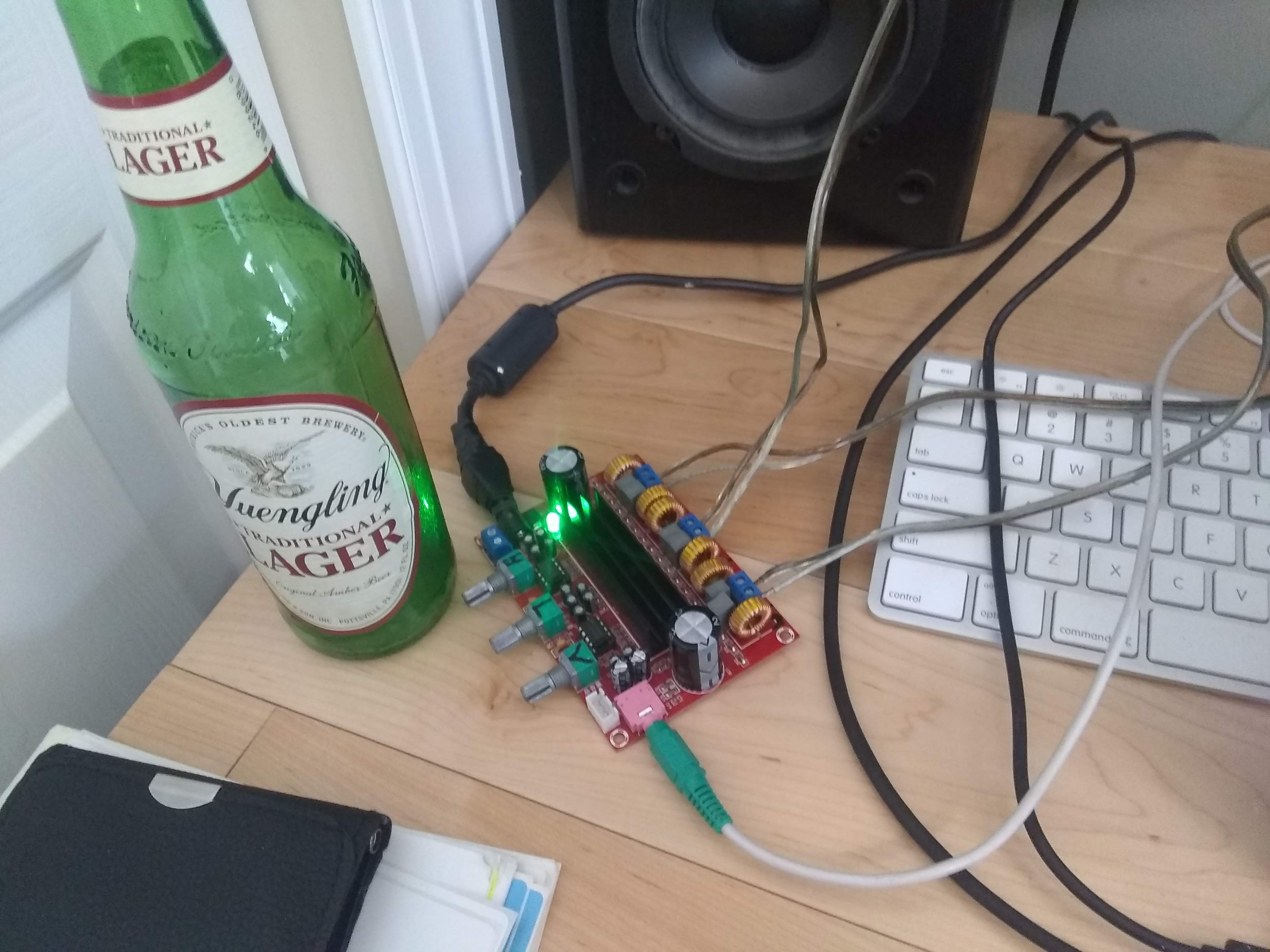

This 2.1 amp has (3) flaws:
1 - The leftmost knob is the full range left and right gain. In the middle of the range it has a hiss, but not at the lower or higher end of the range. I keep it pretty high and adjust volume via the laptop and the main volume knob on the right as an acceptable workaround.
2 - When I connect it to power, 90% of the time, the turn on thump is so loud that it goes into protect and does not work. If I disconnect the sub channel, apply power, and then reconnect the sub channel it functions, but I understand there is a mute pin on the TPA3116d2 - has anyone tied into that in a simple manner to un-mute after a delay of ~ 2 seconds?
3- the output inductor gets dangerously hot. Only one of them. The 2nd from the right in the pic, which is one on the bridged sub channel. I have run this amp hard into a 1.6 ohm sub, but usually run it into a w5-1138smf 5.25" 4ohm subwoofer. Unsure if load changed temperature. It gets hot at idle/low and at high volume levels. The cheapo blue boards with SMT inductors do not get hot driving the same loads. Has anyone come across heat issues like this, and if so, has anyone replaced them with higher current rating inductors? These dont seem tiny so I am surprised they get so hot ( too hot to hold a finger on it, but not quite sear your flesh with a quick touch to check)

This is an amp, not a heater. It is class D which means high efficient, cool running. Ask your self, what do you win if you make the heater coil bigger?
There is a severe mistake in the construction of this amp that leads to in audible oscillation, which heats up the coil.
If you know how to use an ampere meter, you can see how much current it takes. Then compare to the data sheet.
This is, if you like playing with amps. An experienced amp builder can alter the construction to get rid of the problem.

HI Jared-San,
This board has so much design & parts selection issues.
There are two root causes in XH-M139 Amplifire core heating.
1. Too easy magnetic saturate-able toroidal core inductors.

I removed C40 and the inductor temp is nowin line with the others, a reasonable temperature. You and your website did an excellent job of showing your diagnosis and the reasoning behind the repairs.
This is amazing that a fix that took 45 seconds to wait for the iron to heat up, and then 3 seconds to flip the capacitor off the board fixed things.
So I may have celebrated too soon. After some time, the inductor gets hot again. I do not have a fast enough scope to look at the timing signal sadly, but I think the STM32 scope kit might work well enough to tell me what the board is operating at. I will back burner this for a bit until I get the stm32 scope built.

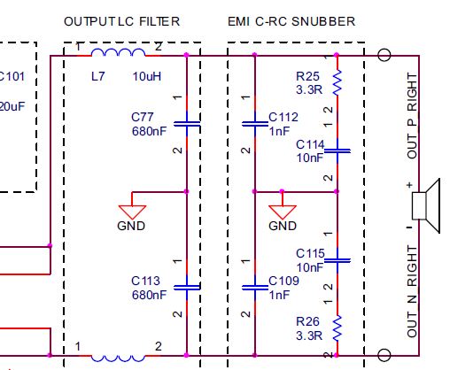

My I ask a question about TPA3116 and output filters.
At the output there is first LC filter and then C-RC snubber. Can this be the way around – first C-RC filter and then LC filter?
The problem is I have this TPA3116 amp with C-RC snubber but no LC filter. Can I just add LC filter after the C-RC snubber?

Hi Igla-San,
I guess your board is using Beads instead of LC-Networks. The Snubber circuit is mainly intend to dump the ringing of switching waveform. You can add LC-Filter post of them and the snubber-circuit after the additional LC reconstruction filter.
Then, you will get the cascaded reconstruction filters finally.
To tuning the snubber circuit, better to watch the ringing waveform with oscilloscope. (Of course loaded with actual speaker and Cut & Try is the best way for this...)

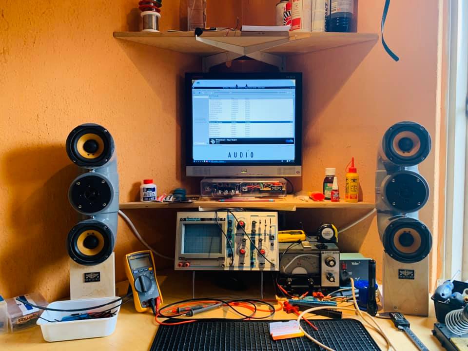

Just my humble workshop system, amp was € 7,50 plus X-over parts.
Speakers out of left over sewer pipe, drivers I had from salvaging old cabinets.
Just treat this amp as a tube amp to avoid excessive popping, therefore I added the switch in the middle to connect and disconnect the speakers.
L/R balance about 3 dB off, corrected that in the playback software.
I am happy with the result!
