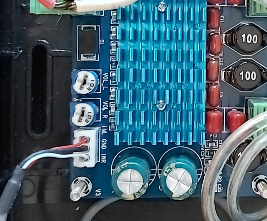

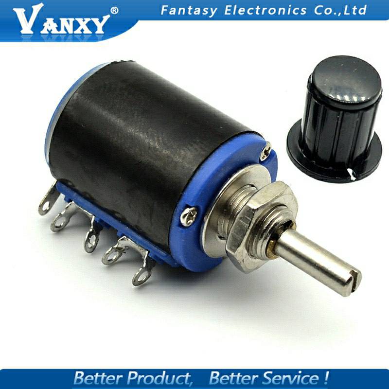

Was finally able to build my amp. Will skip the pictures because it's not pretty at all but am quite happy as it was my first attempt. Thanks to those who took the time to answer my questions!
As expected, I get a pop when I turn it on and a soft hiss while its running. Can both of these be addressed by replacing the potentiometer with a 10K logarithmic that can also be used as the power switch? I read that the pop can be minimized by turning the unit on with the volume all the way down and that the hiss can be addressed by replacing the volume pot/s. Attached is a pic of the board Im using. It has built in potentiometers for Left and Right channels. Not sure though if it is for Gain or Volume. How can I tell? 20200619_115722.jpg
"POP" has got nothing to do with the potentiometer value. 10K will absolutely help on hiss, 4K7 even more. Hiss can also be helped by lowering the TPA3116 gain. For your board it should be quite easy as the heatsink seems fixed with screws.
Gain and volume are two parameters relating to the same matter. With a volume potentiometer, you change the gain from the board input to the board output by making a variable voltage divider. However, the TPA3116 gain remains fixed, independent on the position of the volume potentiometer.
@FauxFrench
thanks for the reply!
As for "pop", I was under the impression that it would be eliminated if the volume were turned down prior to powering up the unit. This is why I thought of incorporating a potentiometer that turns the unit on as it powers up (similar to those in built up t-amps).
I guess I'll go ahead and replace the pots first and see if that takes care of the hiss.
It has 5 soldering-lugs, not 5 different connection terminals. If you look at the potentiometer, the two front sets of soldering-lugs are connected two-and-two. I am pretty sure it is a multi-turn wire-wound potentiometer. Such are often meant for measuring instruments and precision power supplies but not really suited for audio. Try searching with the word "B5K" on AliExpress and you find better suited potentiometers.
* Power terminals very close to the high-impedance inputs, the unshielded trimmers are right next to them.
* Input cinches right next to output terminals, long unshielded wires out of the shielded cable
* The rather long shielded cable along the output stage.
* Unshielded case
* Very likely low-quality SMD input coupling capacitors, the plane below them is likely a noisy power trace from the protection diode to the chip.
I would dump the board and get the XH-M590 FauxFrench recommends. The onboard pot could be used for volume control, either as is, or extracted to a place where it's reachable.

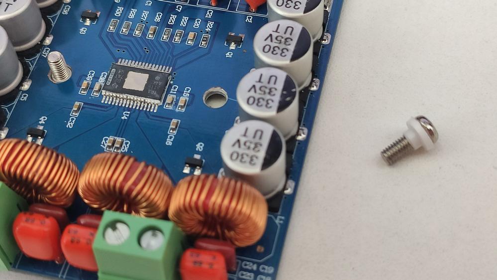

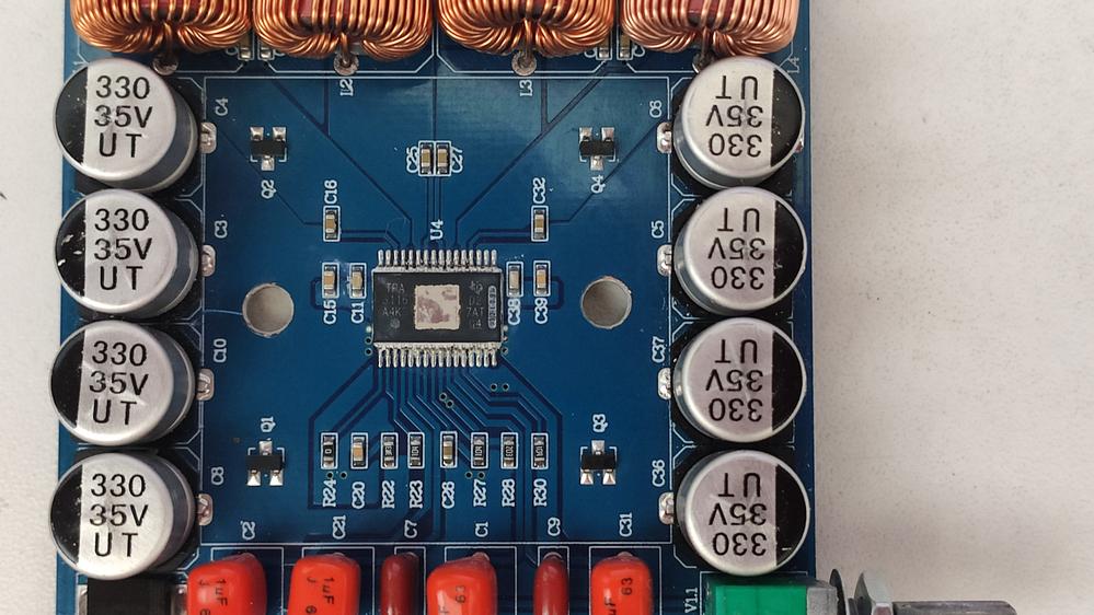

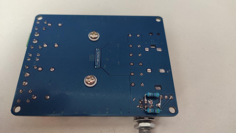

For my amplifier I chose a board https://aliexpress.ru/item/33057102013.html because I was limited by the size of the case.
The board has banging when turned on and off but they are low expressed.
With the help of a heat gun and physical effort I removed the radiator and installed it on the screws.
Then set the 4K7 resistance at the output of the potentiometer.
As a result the hiss became barely noticeable and the quality of the playback completely satisfied me.

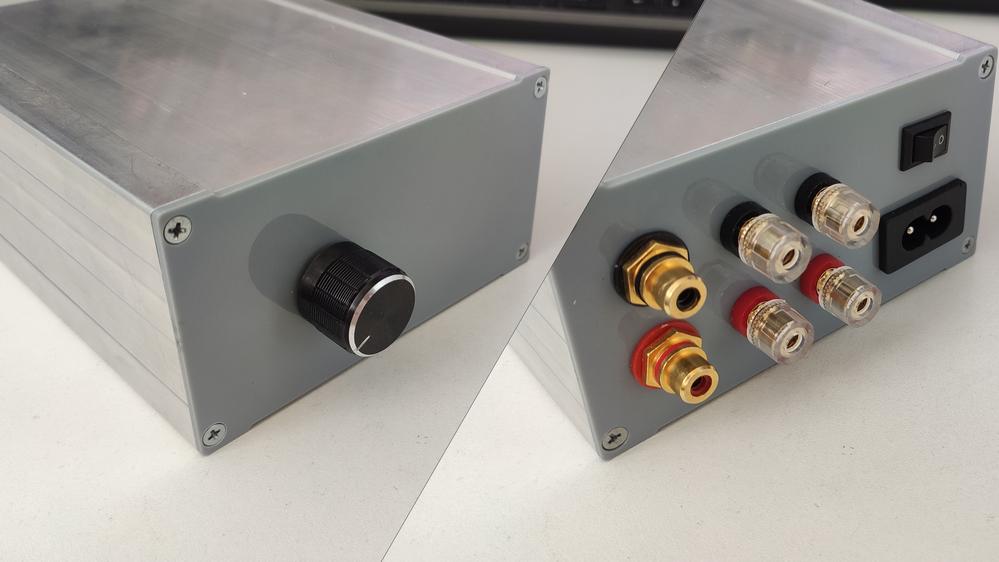

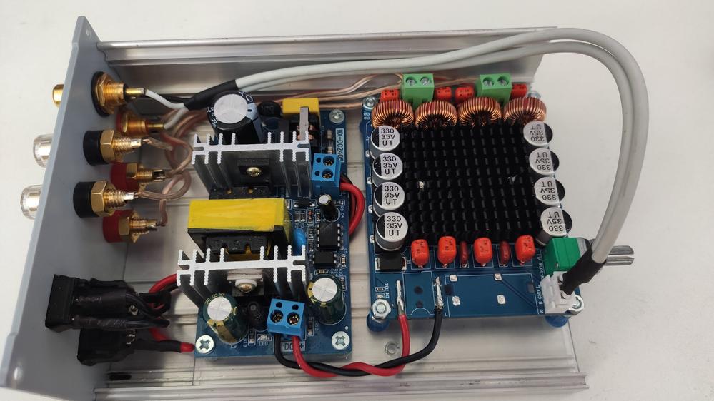

Assembled in the case of the board and power supply for 24V.
