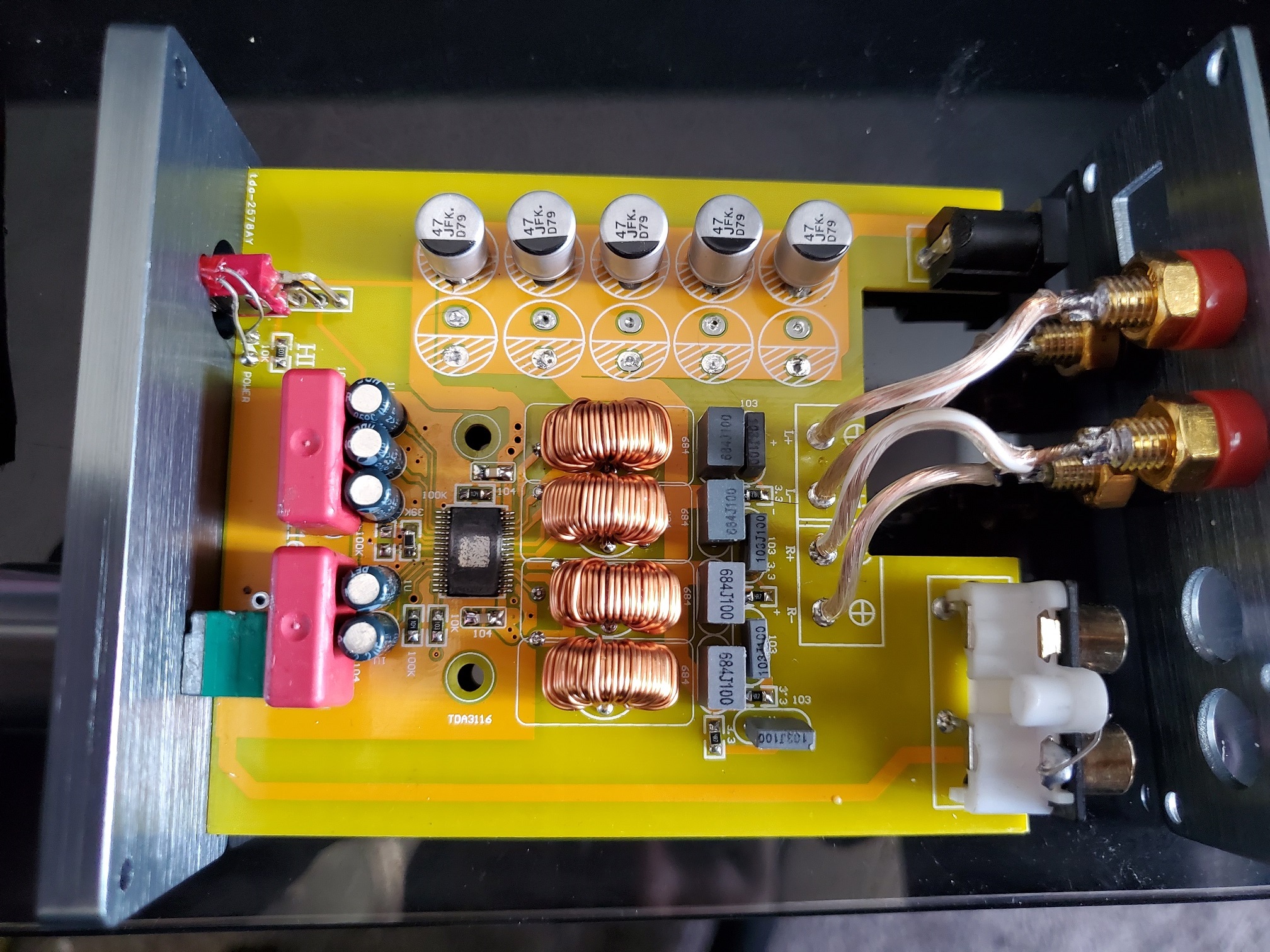

Really happy with how this one sounds finally. Factory gain was set to 32db which also put some hiss in my speakers. Factory DC power caps were 10x Sanyo 470uf/35v
Currently using gain resistors:
R1: 10k
R2: open
Input cap: 2.2uf, unknown brand
Initially tried going up in size for DC caps (went to 4x 1500uf panasonic 63v) but the treble was bordering on shrill. Saw here that the datasheet recommended value is 220uf (TPA3116D2 Boards) and I had some leftover caps from my TPA3255 project so I put 5x 47uF 63v and it sounds just great now.
Powered by 19v / 3.5A laptop power supply

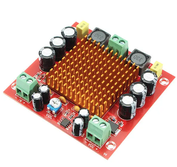

Hello all,
After searching around the forums for a class D amp board I came across the posts here by FauxFrench who recommended a particular TPA3116D2 board, this one.
Heat sink removed to show the resistors under it, after seeing lots of others it does look like a proper job.
He explained that it used good components; was very close to the data sheet, did not have any filters or bluetooth and did not need a pre-amp. It's full 'google will find one' description is " KYYSLB DC12-24V TPA3116D2 Amplifier Board XH-M590 " FF went on to explain not to buy the one with two glued on heat sinks but the one with a single heat sink, this is removable with a screw in order to get to the SMD resistors under it.
Mine arrived and I powered it up, it hissed at 1/2 volume, I was advised to remove two 75k (753) resistors (watched a how to on YT) which reduced the gain from 36dB to 20dB, result not even a smidgeon of hiss. The lower gain didn't make any difference to volume levels that I noticed.
My speakers are Frugel Horn Mk3's that I made myself from the original drawings in 2011 with Mark Audio CHP-70's which are 4 Ohm, 86dB, 18 Watt. Looking at the TI data sheet I saw that at the 12V recommended for 4 Ohms I would get 20 Watts.
I was advised to change the 4 caps which are 470uF to 2,200uF which I did, that made it rather 'shouty' in the upper register, I changed those to 1,000uF, still a bit 'shouty' finally going back to the 470uF ones I splashed out a tenner for 4 Nichicon ones, 'shouty' gone.
In amongst that I was also advised to have to caps between the power supply and the amp, I introduced 25,000uF left over from an analog chip amp project. It sounded very nice, smooth and pleasant, but the bottom end sounded woolly and the top truncated, the bits in the middle a little less distinct.
I removed those and got the full force of the amp back, as Mr Hoyt said in another forum, what I got was "Gain".
I then conducted a test over many days by using two dummy loads, one in the class D and one in my 3886 chip amp. One fed the left and the other the right speaker and the inputs were connected to a DPDT switch so that I could go from one to another instantly from a listening position.
I've done this before and expected that at first there would be very little perceived difference, there wasn't. I'll not bore you with lists of music, the eventual outcome was the 3886 was slightly soft and the 3116 slightly faster and more detailed especially in the upper and lower registers.
I must emphasise that the differences are small and others may have chosen the smooth and pleasant rather than the fast and detailed.
I use this 12V 8.5 Amp power supply, cost 9GBP
I've just tried a 12v 2.5 Amp plug into the wall socket PS, no difference whatsoever. Looking at the TI data sheet one can see why "Feedback Power-Stage Architecture With high Power Supply Ripple Rejection reduces PSU requirements".
With the amp at waking the dead volume and a full range wall of electronic music.
I connected an ammeter in series with the +V output it registered between 0.2 to 0.4 Amps.
At 12v = 4.8 Watts divided by 2 = 2.4 Watts less 10% for efficiency wastage = 2.16 Watts or 1/2 that at 0.2 Amps.
Cheers - J
