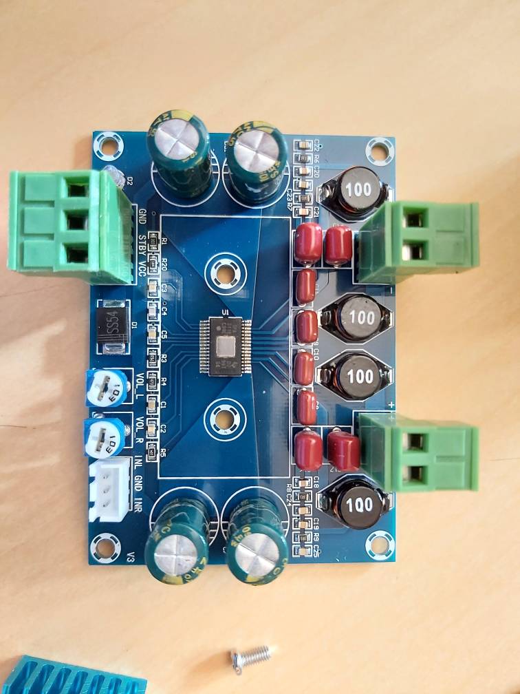

removed the heatsink and here's what I got (see pic). sooo... what do I do again? apologies for my ignorance.View attachment 855528
* update:
saw a video of a different board suggesting:
1. remove R3
2. replace R4 with 5K6
would this be correct?
Many thanks for the photo.

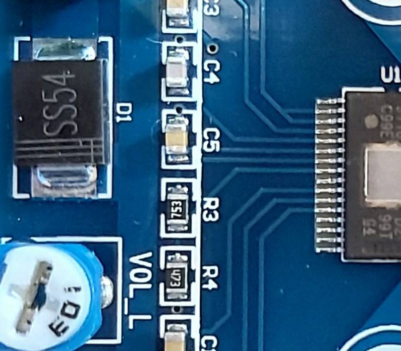

Could you please tell me the three numbers written on R3 and R4. I cannot read them from the photo.
Please turn the amplifier board around and take (and post) a photo of the rear side of the board.
75K and 47K. Section 7.3.1 of the datasheet ( https://www.ti.com/lit/ds/symlink/tpa3118d2.pdf?ts=1593110803397&ref_url=https%253A%252F%252Fwww.google.fr%252F ). Master, 36dB gain. If R3 (75K) is removed, the gain is reduced to 20dB and the hiss is much less. R4 need not be changed to 5K6.

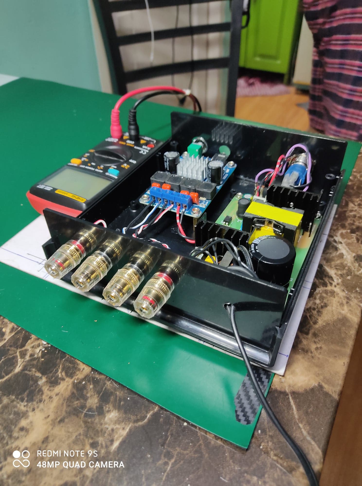

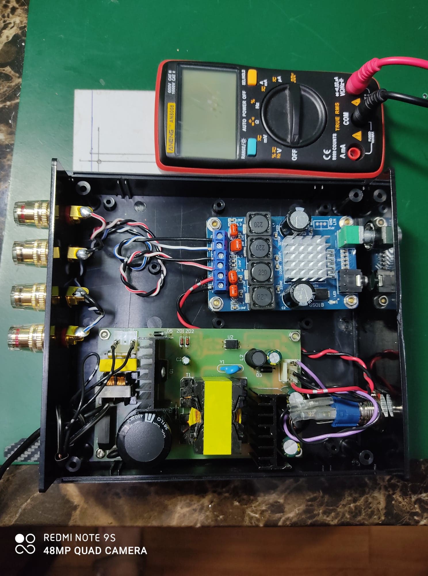

Hello all
My amp arrived today Sunday! Bought on ebay delivered by Amazon!!
This is my little listening room at the back of the garage.
The PS is a cheapo 12v 8.5 Amp smps
The board is the XH-M590
If I may, a question? is it possible to have just one channel working, I have tried just one connected to my speakers, no sound at all, with both connected it's fine. I want to do a switched comparison from a listening position with my 3886 with both in mono.
Upon switching on no 'PfffT' at all, switching off just a mild 'pttt'.
No other interference or other odd noises at all.
A hiss through the speakers but as far as I can tell goes with a signal.

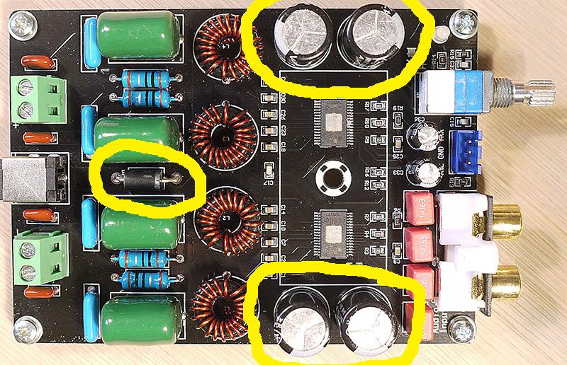

Many thanks for the photos. Can't make high-res photos work.
My changes:
1) The two "753" (75K) resistors are removed in order to reduce the gain (and hiss) to 20dB.
2) The diode marked with yellow is bridged with a 0.75mm2 wire. Loss of wrong polarity protection but improved effect of external power rail decoupling capacitor(s).
3) The four 470uF/50V decoupling capacitors (marked with yellow) are replaced by 2200uF/35V low ESR capacitors.

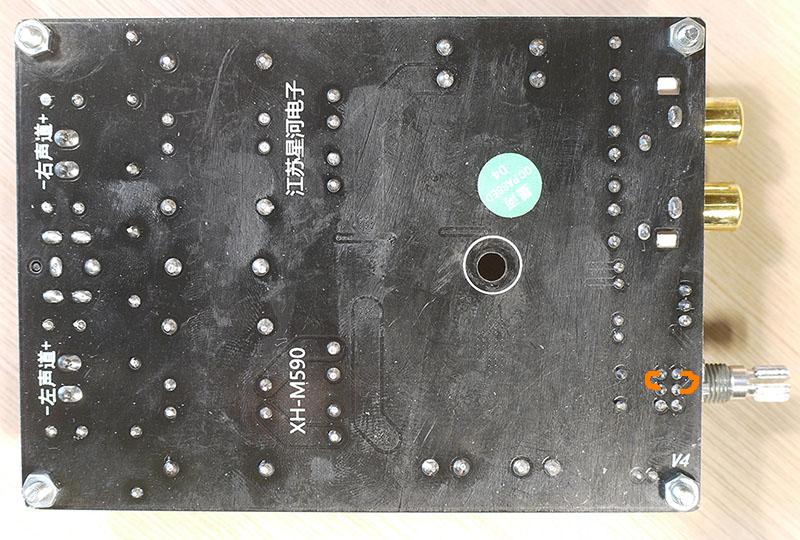

4) Rear side. Two small 4K7 resistors are connected as show with orange lines.
5) The rear side of the board is cleaned with isopropyl alcohol. Use a soft brush and hold the board vertically such that the alcohol drips off in a corner.
6) Use a bit of thermally conductive compund when putting back the heatsink.
I have some 6 different TPA3116 boards and this one plays the best. On the output of my power adapter I have some further 10000uF.
